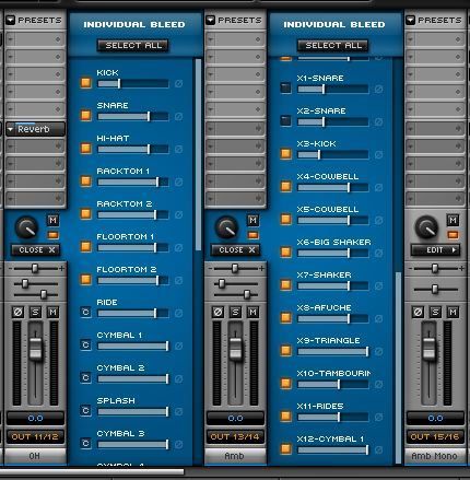

Dunno about SSD4, but I had a quick look at SSD3.5, & the amount of control over the bleed ain't there compared to Superior dude...SSD3.5 has a choice of 2 different rooms, so you can assign the kit pieces to each, & control the amount going to the room(s). It's similar, & would do the same thing for the room mics, but it's still not quite like the amount of control you have in Superior unless I'm overlooking it...
Here's a little pic of what I'm talking about:
These 2 drop-down menus are just the oh & amb tracks, for each track (kick, snare t, snare b, hh, etc), there's a drop-down menu, & you can adjust the amount of bleed for everything if you wanna....So for example, if you wanted hi-hat bleed going into a snare mic, you can adjust/control how much comes through that particular mic...
Using Greg & Rami's drum tracks they've sent me, I can get pretty close to the amount of bleed they have in their tracks this way. It takes some time & patience to get there, but once you have it how you want, you can just save the preset (I personally use track templates in Reaper because it loads up all my tracks, fx, envelopes, all in one shebang), & load it up with a mouse click or three...:).
