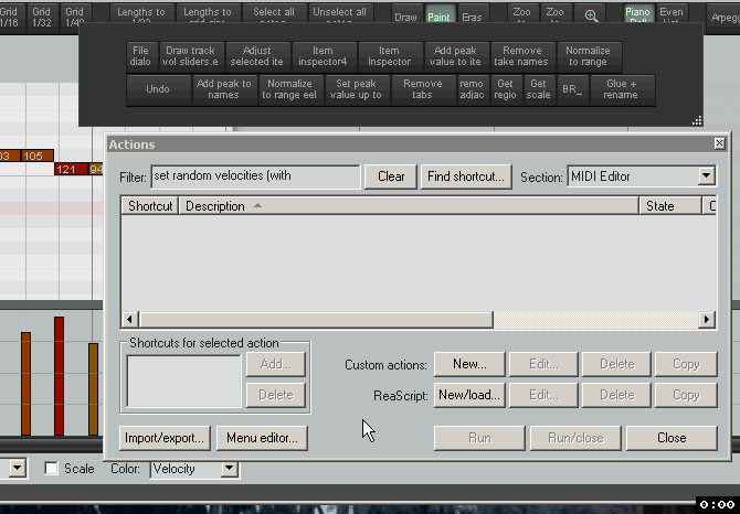

Miner, having a play with this and I'm pretty stumped pretty quickly. I think its partly paranoia about fucking up a programme that works fine as it is.
I opened up actions and went to add the MIDI note selector and it told me that I already had one and did I want to replace it. I thought cancel was the safer option here!

Lemme see if I can remember how to do this without opening Reaper...
Double click on a midi item to open the piano roll
Right-click where the toolbar is in the piano roll, & select "Customize Toolbar"
A pop-up window will appear with all your scripts, click "Add"
A pop-up window of your scripts will appear, highlight the one you want, then click "Select" (if you select one & it asks if you wanna replace it, select "Yes" it's no big deal dude)
At the bottom a new toolbar button should appear, make sure it's selected, & click the "Icon" button
Another pop up window will appear, & select "Double width text button" (makes the button bigger so the name you give it can be longer), then name your button
Remember when using these scripts to work in "parts" (verse, chorus, bridge, etc)...
Make a time selection of the verse, chorus, whatever you're working on, or the scripts will select/change all the midi notes that are in the whole song...
This is how I use 'em, I'll work on one part until I get all the midi randomized, then move on to the next part...
I had trouble getting them to work at first, but once I "got it", it's really pretty simple...Lemme know if this helps...
