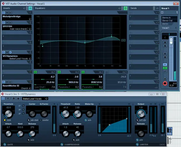

Alright...attached is an image of the EQ and compressor settings. Which settings should I change? I think the autotune-like effects may be a result of the compression.
http://soundclick.com/share?songid=8362935
EDIT: Changed the EQ a little and re-uploaded it. Below is the current EQ/compressor settings.

As soon as the drums come in...right at "Always gonna be..." the vocals start breathing heavy, going back and forth, and pumping. The whole thing sounds squashed. There's a lot of sibilance on the new mix. There's no dynamics in the song, because of the mix. Autotune has been toned down, which is good. Still a bit noticeable in spots, like 0:44. Maybe you're not using it, but something is giving it that effect, which, imo, robs the song of it's integrity a bit. Your voice is strong enough without that effect, whatever it is.
Mix (vocals mainly)still doesn't sound good to my ears. There are some low frequencies in the music that are pretty muddy. Is there bass in this? I hate to sound negative. Just trying to be honest. Vocals get completely lost starting at 2:30.
Back off on the compression. Try bringing the threshold back up, decreasing the attack and giving a longer release. Sweep the high frequencies to find out where the harshness is coming from, throw a narrow q on it and drop it. Define the instruments better and clean up some of the muddiness. Just re-approach it and figure out what's working and what isn't. If you have to revisit some things, so be it. It's the climb, right? This song really needs dynamics and space. Listen to some Celine Dione or Josh Grobon cd's to compare the mix to. You'll see what I'm talking about. Go back and forth every so often for comparison. That's what I would do.

Here's the new mix. I reverted to the EQ/Compressor settings I had at the very beginning and just adjusted the limiter for the high notes. I also adjusted the EQ and volume on some of the instrument tracks. Is it better or does it still need work?

That's much better. It still pumps in parts a bit, but it's not nearly as distracting. I think the levels sound fine, minus the climax end - they could come up some. There are still some issues with sibilance here and there. When there is that much reverb on the track it really calls out the ssss, so you gotta be careful.
One final thing. I think in the future you need to make sure you hold onto some of your words. During the quieter parts, there's a word or two that you kind of say almost under your breath, and I can't make out what it was. It almost leaves a gap in the music. One instance: 0:58, the word "battle" gets lost quick. Just something to keep an ear out for. I'm not a professional, just my opinion. If I'm off, I hope someone chimes in and tells me to shut up and figure out what I'm talking about:rolleyes:
