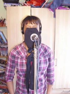

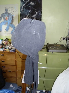

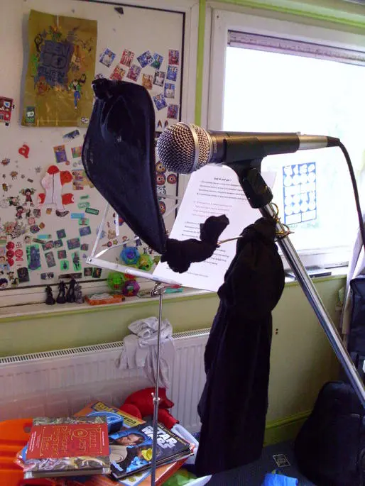

This is just a cheapskate's pop shield/filter.

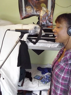

Literally put together in 15 minutes from imagining how it should look, I can tell you it's really effective. It's double sided and takes no high end away but plosives are dead in the water on this fella. I've had it for about four years. I made it in such a way that it's a few inches from the mic. If placed too close to the mic, you get something more irritating than plosives and sibilance - you get, in a singer's excitable moments, the wind actually knocking the shield against the mic so it sounds like a percussionist is right on their shoulder !
The end of the hanger is curled in a circular fashion and easilly slides off the mic stand once the mic holder is unscrewed. It's not pretty, but who cares ? It does the job. I blew really hard into it and could barely feel any wind on the other side.
Sometimes, stories you hear about what can be done turn out to be false dawns (egg cartons on studio walls ?) but this is one that comes up trumps.
