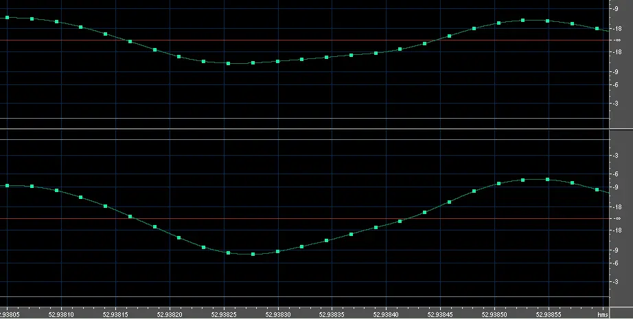

The number of bits have only to do with the amplitude or loudness of the sound. When you have more bits you have more accuracy because it allows a smaller change in voltage to result in one bit change.
The sampling rate and hardware/software filtering and equalization are related to the frequency components which distinquish different instruments that you refer to. When the sampling rate is at least double the highest frequency in you music you can reproduce all the sounds on playback. Sampling rates from 44.1khz on up are fine for 20-20khz.
It is the frequencies and other related characterics coming from the violin that differ it from other instruments. The main point here is that it is NOT the amplitude that make instrument sound different. If you make a guitar louder it still sounds like a guitar.
hold it
Yea, can we talk about that please? I realize this is more suitable for a new thread, but you just touched on a subject that's bothering me. Exactly how important is this slight jitter between samples when recording music (not synching, or doing anything else where cumulative time delays can amount to something meaningful by the time a song is over, just plain recording). We're taking say 44,100 samples in one second, and you mean to say that some tiny amount of jitter in those samples makes a dammed bit of difference to the human ear? I wish someone could convince me.
I think this very informative little experiment with bit depth should be expanded to force everyone to take a good hard look (listen) to differences in soundcards with "good" and "bad" timing stability, as well as contrast different sampling rates. I wish I could conduct such experiment but I'm not set up for it. Now, back to this bogus jitter BS, when I look at a time domain representation of a fairly "ratty", jagged portion of my band's recordings sampled at 44.1 KHz, those steep slopes and zero crossings end up looking pretty smooth, and they're tightly packed with samples. The image below is one example, which I hope shows up. It should be obvious to anyone that any slight shifts in any number of those digital samples wouldn't mean a thing to the listener. Maybe if this millisecond or so of music were pushing the Nyquist limit out in a dog's range at say 20.05 KHz then a slightly displaced sample might imperceptively change the shape of the signal, but can any being (human or dog) register than in his brain? I'm not trying to be a wise guy; I'd really like to know whether all this fuss about timing stability is just as far past the point of diminishing returns as the 16 to 24 bit issue.
Thanks for any insight

Ethan Winer said:
Wes,
> if all of that crap is volume - then how does digital (binary)make a violin sound like the violin? Or drums sound like drums. <
Those numbers represent the voltages generated by the microphone. Which represent the changes in air pressure when the musical instrument or voice was recorded.
When a microphone is connected to an amplifier which is in turn connected to a loudspeaker, the loudspeaker reproduces the same air movements the microphone captured originally. In an analog system, the voltage from the microphone is amplified and sent to the loudspeakers. In a digital system, the voltage from the microphone is measured 44.1 thousand times per second, and converted to equivalent numbers. In a 16-bit system these numbers can range from -32767 to +32768, which can represent a lot of tiny differences in the displacement of the loudspeaker cone.
Does this help?
--Ethan
To correctly understand why a violin sounds differenct than drums you will need to understand Shannon's Sampling Theorem which falls under digital signal processing (DSP) an advanced engineering subject. Your elementary description about air movements on the microphone and speaker are true but failed to answer the question. This is probably because there seems to be few analogies available to explain this to someone without an engineering background.
So your question is obviously not related to the volume and not related to the bit resolution. It is related to the frequency content of the instrument which is related to the sampling rate and any filtering of the signal. As a user of recording equipment, you really don't need to understand how the sampling process works in order to get good recordings. If you do need to understand take a DSP class at the university.
