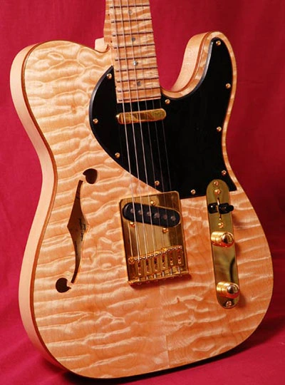

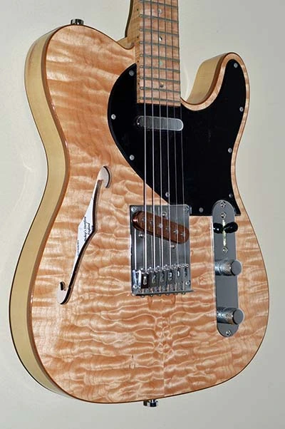

Here's my tele with the exact scheme you refer to and my own wound pickups. I made these a few years back as sisters as I love tele's and didn't have one so doubled up on a commission. I don't have any sound clips but it's my go to these days and I have a lot of options. The one in Gold fittings done exactly the same way that is with a gigging session guy he wanted the same mod..
