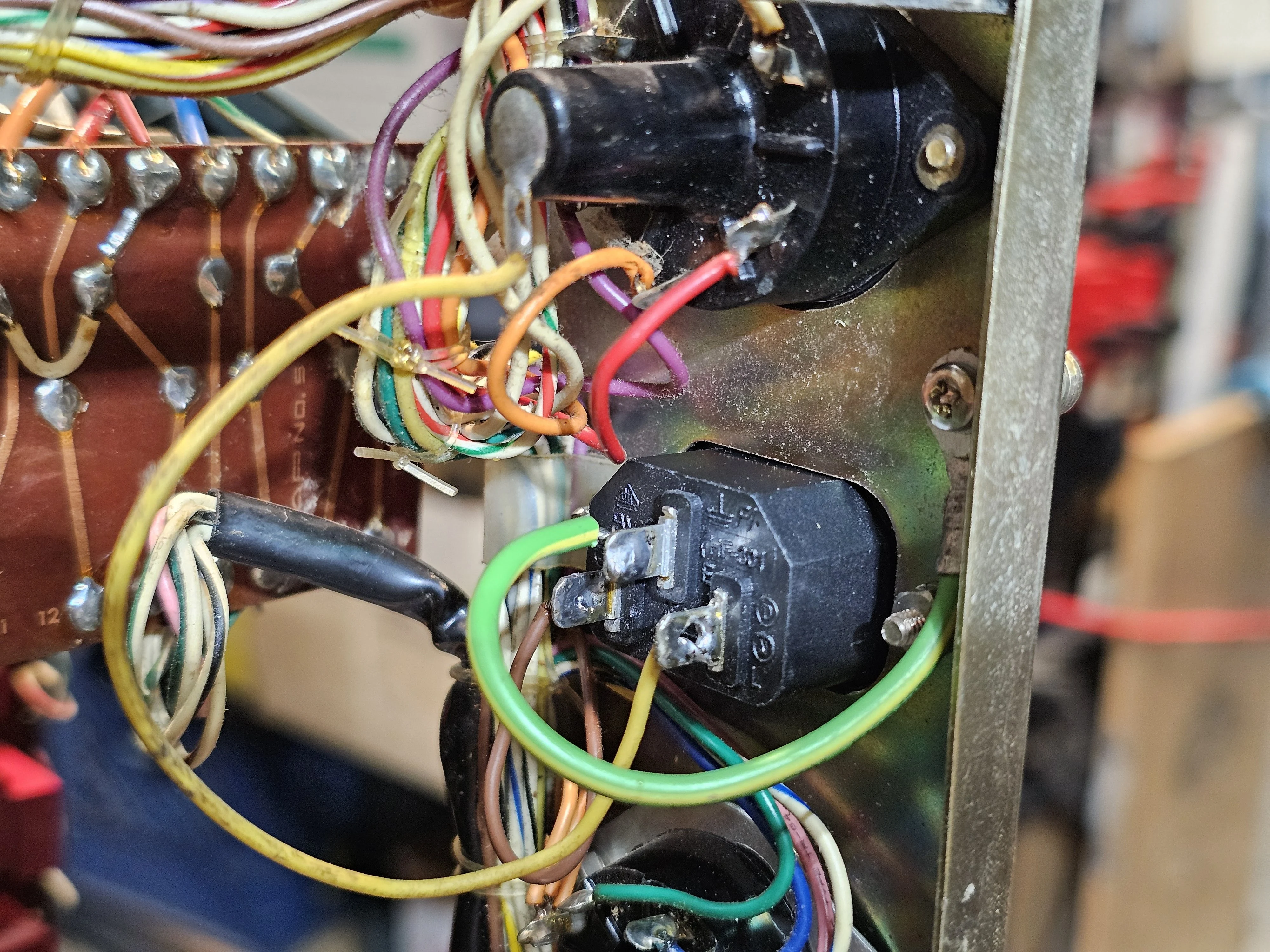

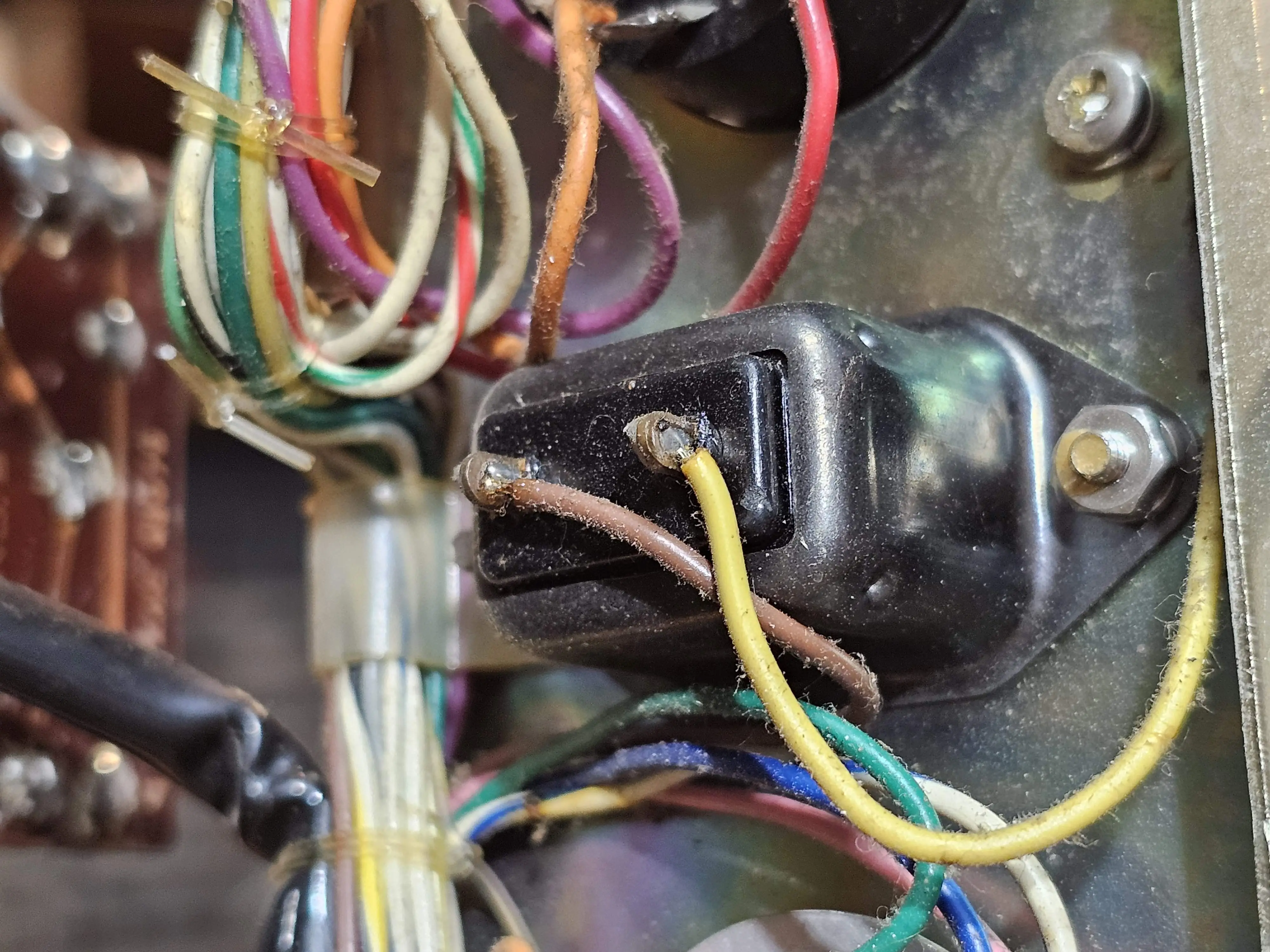

This reply is some time later...but...one of the first things I did with my acquired A-6010 was to replace the 2-prong power receptacle with a grounded 3-prong one like is used by much of today's electronics, PCs, etc. I did this because I noticed that the metal frame of the transport seemed to be hot in some situations and even with a ground wire attached to the lug on the frame, it is too easy to reverse the AC plug and send those wires to different parts of the transport electronics. This, sadly, was how things were wired back then and now completely different. Having said all that, it's not 100% that this is what caused your problems, but my bet is it may have. Swap the power receptacle to a grounded one to be on the safe side.
