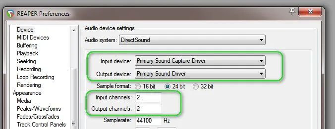

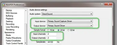

What DAW (recording software) are you using? You should be selecting the TASCAM as both audio input and output device in the DAW. 'Sound control panel' sounds like your Windows settings, not your DAW.

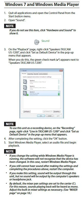

Interestingly the manual describes setting up the US1200 for Windows and Media Player via the Sound Control panel, but I see no mention of selecting the US1200 in a generic DAW through an Options/Preference menu.
Screenshot for Reaper shows where you would select the input and output device and the number of inputs/outputs associated with it (can't recall if an ASIO driver shows up in the "Audio System" box or not). Other DAW's may be similar.
