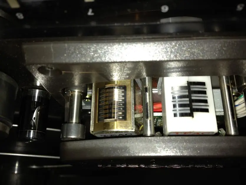

The TSR-8 has two manuals, a user guide and a service guide, the latter of which is very hard to find. Out of interest, could you provide a shot of the heads? With and without flash?

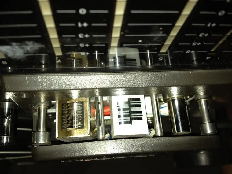

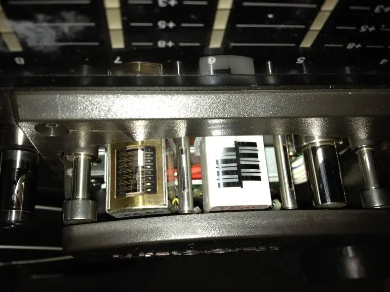

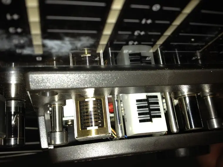

Here are some pictures of the heads. I have no idea what to look for and what they should look like. Any help would be appreciated. VictoryPete, where in RI are you? I'm from Lincoln originally, my family's still there. (sorry, they're all upside down for some reason.)
Hi
I am in the middle of the state, not far from I-95. Your heads look great, there is not a lot of wear on them. Maybe your sound cards need to be reset, there is a removable panel on the bottom of the machine. The circuit boards are held in by friction in the connectors and the bottom plate. Sometimes just removing them and reseting them will help. There are holes on either end of the boards, use a hook of some kind to carefully pull on either side alternately until it is free. Be gentle. Some DeoxIt would be good on the connectors.

It's always a bit hard to tell from photos, but it looks as if there is uneven wear from the top of the head in the photo to the bottom of the head. What you may need to do is get the heads relaped and then adjust the head alignment to the tape. However there is nothing to suggest that there should be problems with dropout.

Is the problem intermittent ? does it comes and goes when you move the machine ? try that. The head has uneven wear, you can see that the thread is wider on track 8 (bottom close to the LEDs) which basically means that the transport/headstack has been misaligned for a while causing that problem, so response in all track won't be even, needs relaping + realignment.

Has the problem re-appeared? If you can take your machine along when you visit your parents I can align your machine. The head does seem to have uneven wear, That shouldnt account for the drop outs. I have seen heads like that before and an alignment will compensate for the uneven wear up to a point and then they need to be re-lapped.
