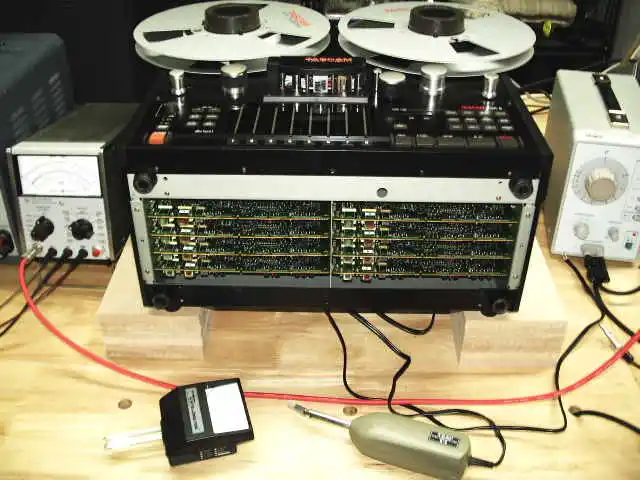

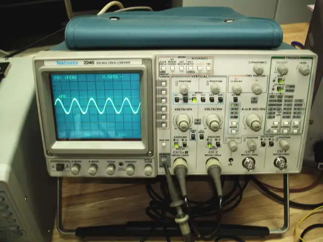

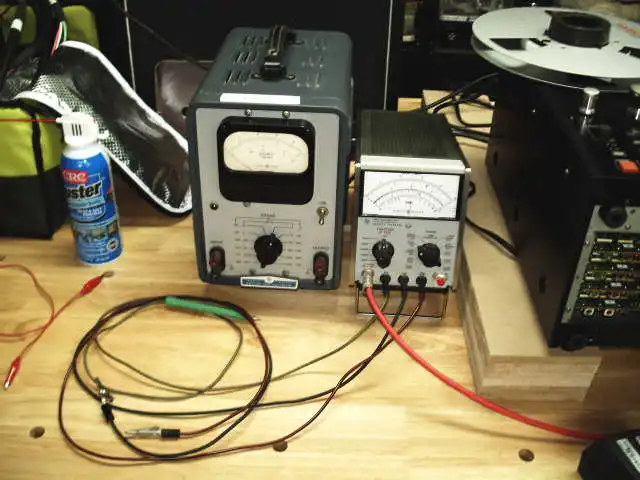

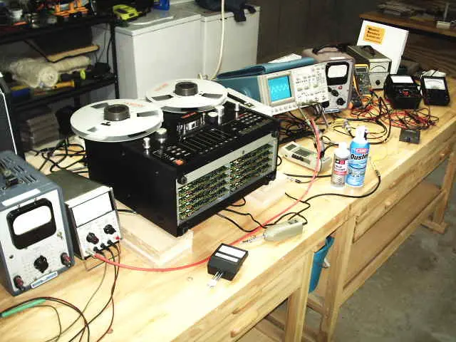

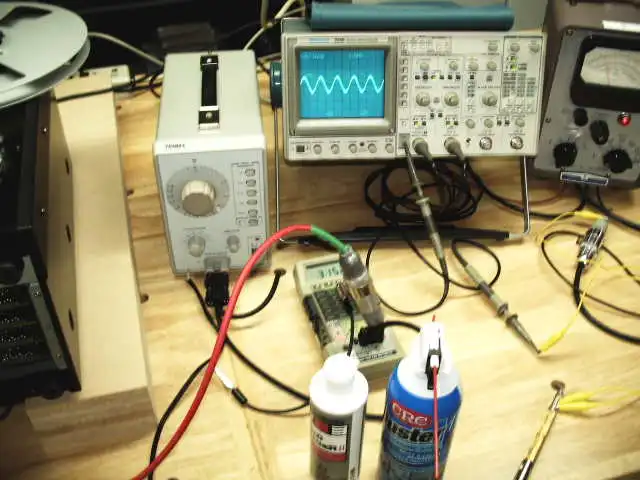

I just finished calibrating 2 of my TSR-8's. I recently bought a roll of RMGI 911 from Total Media for $94.67 shipped, I also got a free can of compressed air, they allow you to pick a free gift. Good luck with your new machine. If you have problems with wobbly reels it could be a defective hub, out of my 4 machines 3 of them had a badly machined hub, The repair is fairly easy if you need help let me know.
VP
Yep, the reel tables are crap on the TSR-8, as are the plastic reel clampers. I had to replace my reel tables as well by cutting down the rear arbors on a pair from the 30-series with a Dremel tool. Had to replace the plastic reel clampers too. Now that you have that repaired be sure to use your TSR-8’s lying on their backs or at least angled back in a rack made to tilt. The plastic reel clampers will last a lot longer that way.
