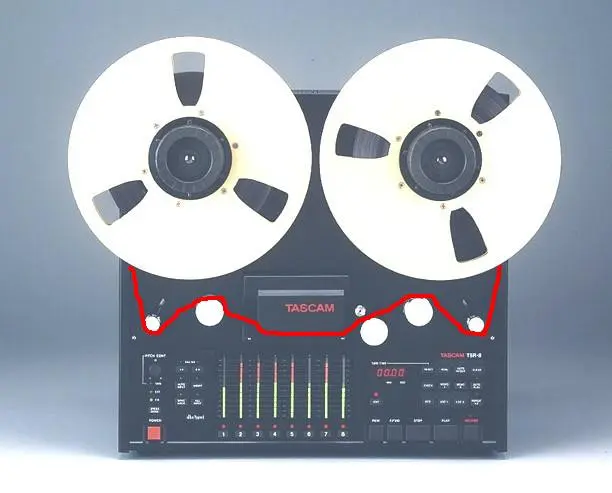

- First make sure the tape is threaded correctly… see below.
- Check the rubber on the counter roller (the large roller below the left reel). Check that the rubber strips are not dry and glazed looking, or worn down to the metal, which can cause slippage.
- Finally, the TSR counter roller works with an optical system inside the machine to count revolutions… it is not belt driven. You may have to take the front panel of the machine off and check for dirt obstructing the optics.
