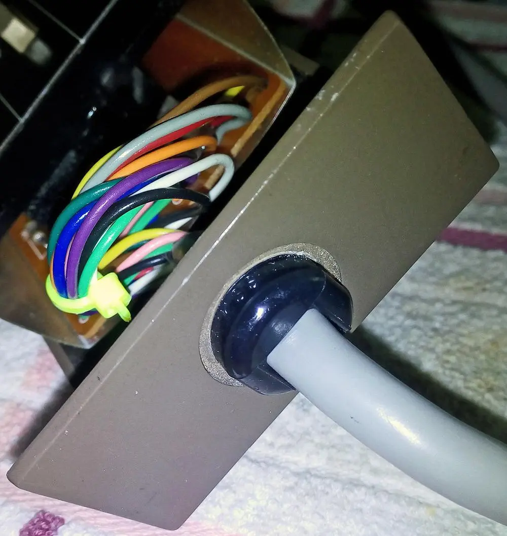

It baffles me how the RC-71 looses that strain-relief grommet, but out of the three RC-71s I've owned, two were lacking that part.

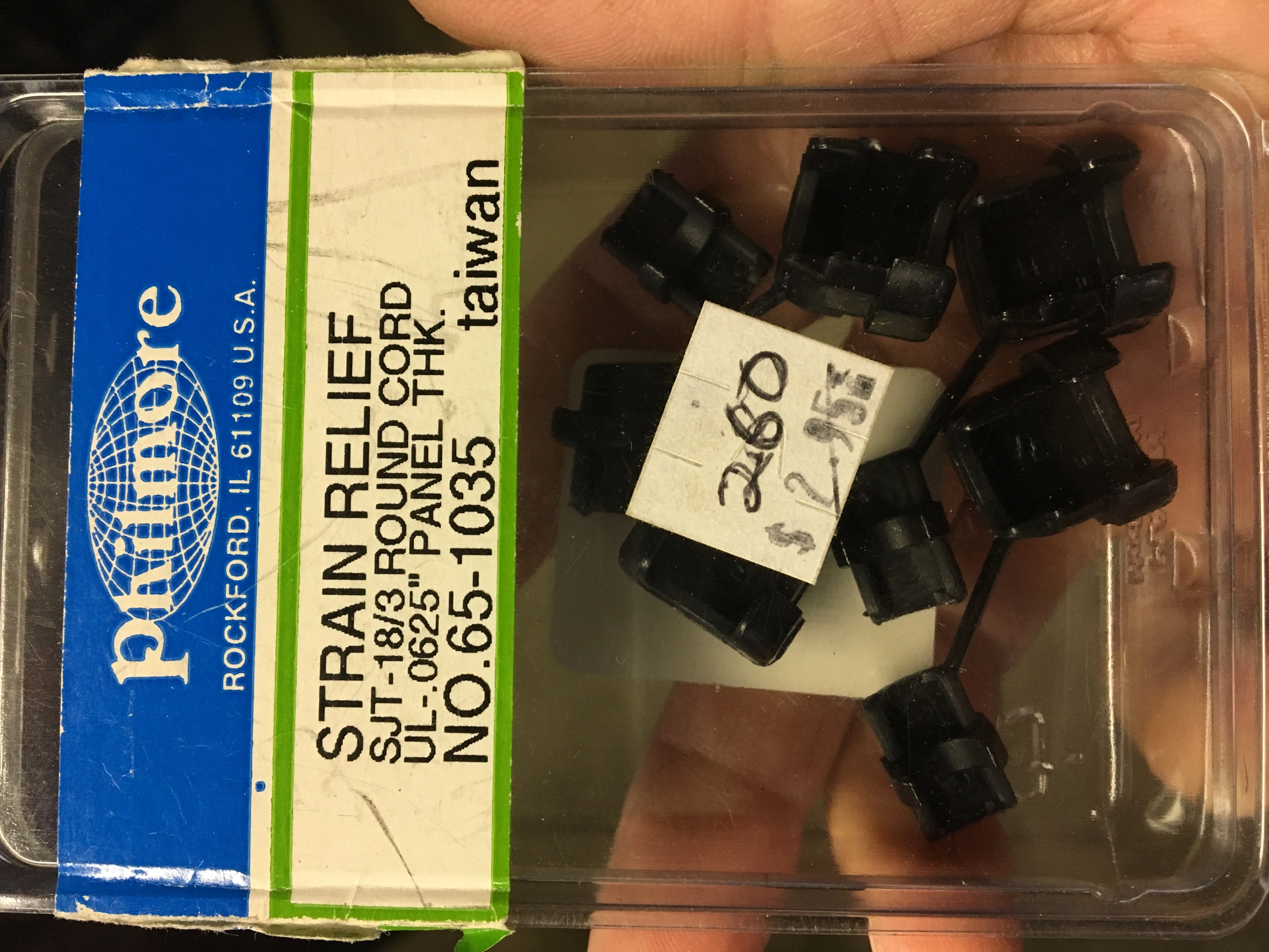

This is what I've used in both cases as a replacement part...hopefully this will help you in your search...it's a *little snug* of a fit, but it fits, is functionally effective, and looks similar to the factory part in the end:

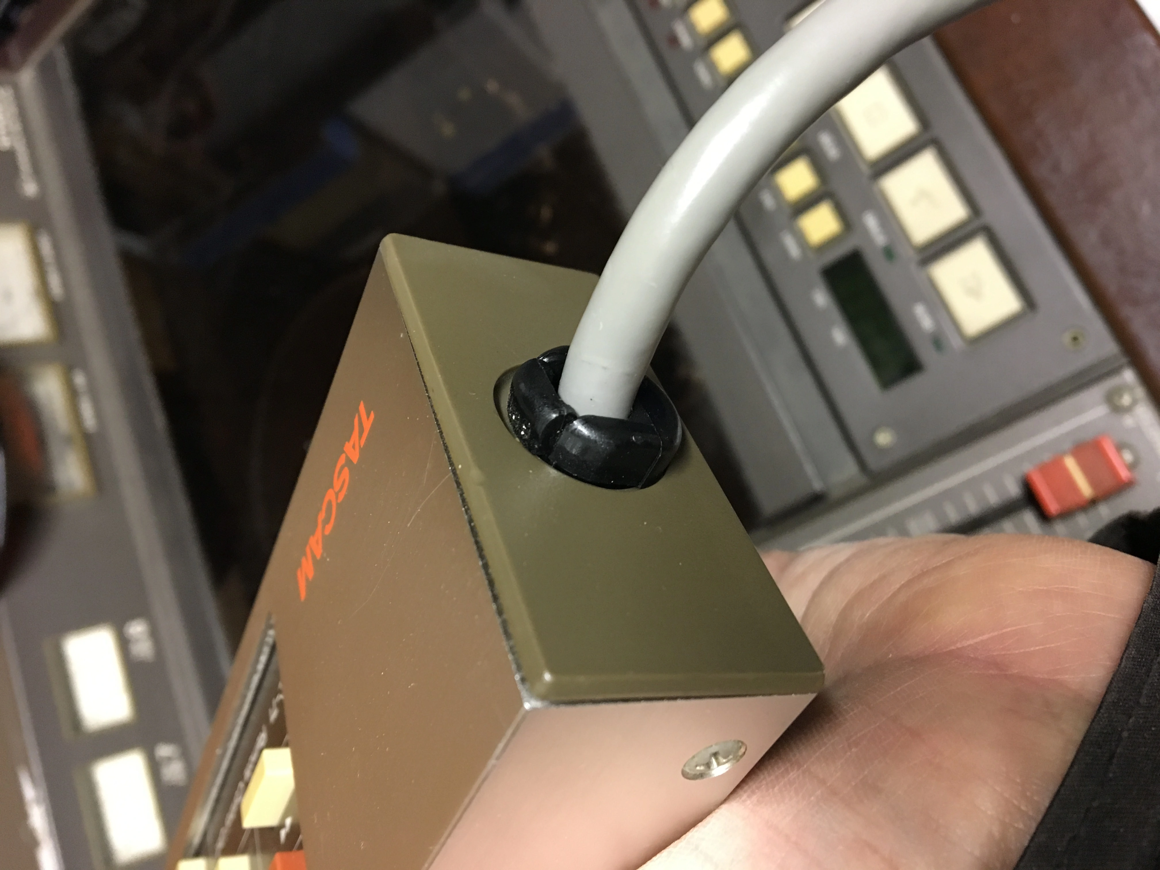

Finally got around to fitting the new strain relief today.
Perfect fit.
