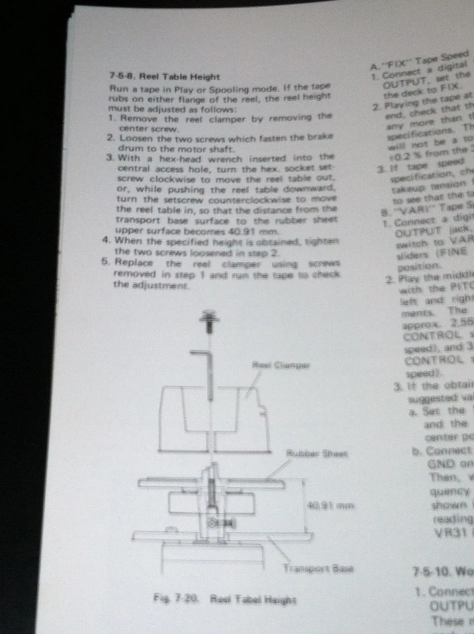

Hi everyone I hope you all can help. I have been using quantegy 456 1" tape on 10.5 in reels on my Tascam MS16. I just purchased an ATR magnetics 1" tape. When i play the new reel, the tape rubs against the reel making a nasty sound. I need to push the reel downwards because there is alot of space on the top that can be evened out. I looked in my manual and read the directions on how to adjust the Reel table height. I am confused on step 2. because I cannot find those screws on the machine.

Other than that, I can't tell you where the two screws are for the brake drum...I'm not familiar with that deck, and your image is real blurry, so hard to tell from that.

this is not hard to do. the ideal situation is for you to find a reel height that can accommodate the two reel sizes. Maybe when you run on quantegy/ampex you are close to rubbing but not there. So it should be possible to adjust it to serve both. That's what i will try. The screws are under the reel table, remove the front panel and look at them from the top of the recorder, rotate the reel tables by hand and you will see them. This is a good design as it has a center screw that lets you fine adjust the height, which is something that other tascams dont have. This is not hard to do at all, you should be able too. Make sure you use the proper allen wrench. Also take a close look at the tape guides & tension rollers to make sure that the tape does not skew due to the new height. You may want to take a look at that before changing the height with a good reel, just to make sure you dont have that problem today.
