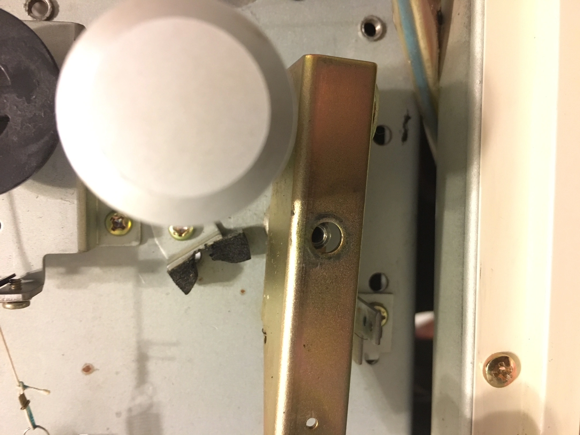

The first issue has to do with the take up reel on the right. As the tape spools it is rubbing against the inner part of the reel. I've looked inside and measured the height of the reel tables and they are measuring equally. One thing I noticed though is that the metal piece that's at the base of the right tension arm rod is missing a washer, which is present on the left tension arm assembly. When I push on the metal piece on the right it moves up and down, but it doesn't on the left. In the pic on the left (sorry for the duplicate - I can't seem to get rid of it) my finger is next to the screw with the missing washer. Sorry if my terminology is wrong! I'm trying to describe it as clearly as possible. Do you think this piece having a little play would be enough to effect the alignment? If it is, would any small washer do? I know these machines are precisely assembled.

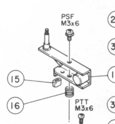

The second set of issues I actually just noticed while the machine was open. The first has to do with the small rubber buffer piece that tension arm assembly hits when it's activated (pic on the right). It's all worn away. Is there a way to put something in place to effectively serve as a shock absorber, which I think this piece is for. The second issue, which seems like it may be more important, is the string above the left tension arm (also picture on the right). It is attached to a spring at one end and not attached to anything on the other. It also appears like it had a loop at the loose end that has snapped (but I'm not certain). I think it attaches to the tension arm assembly, but I'm not certain where.

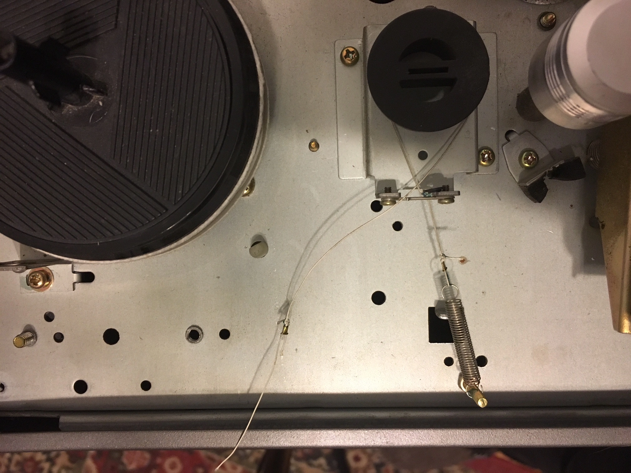

The detached string...that’s supposed to have a look at the free end and attach to...something. I’m not yet clear what that does or how it attaches. I’d have to do further research. I PM’ed you with some additional info.
As far as the tension arm stop, I’m not clear from the pictures you posted what part you are talking about exactly, but if it is what I’m thinking, that is something you *can* get at a local hardware store...find the right size vinyl or rubber tubing and cut off a small piece and press on to the metal tang.

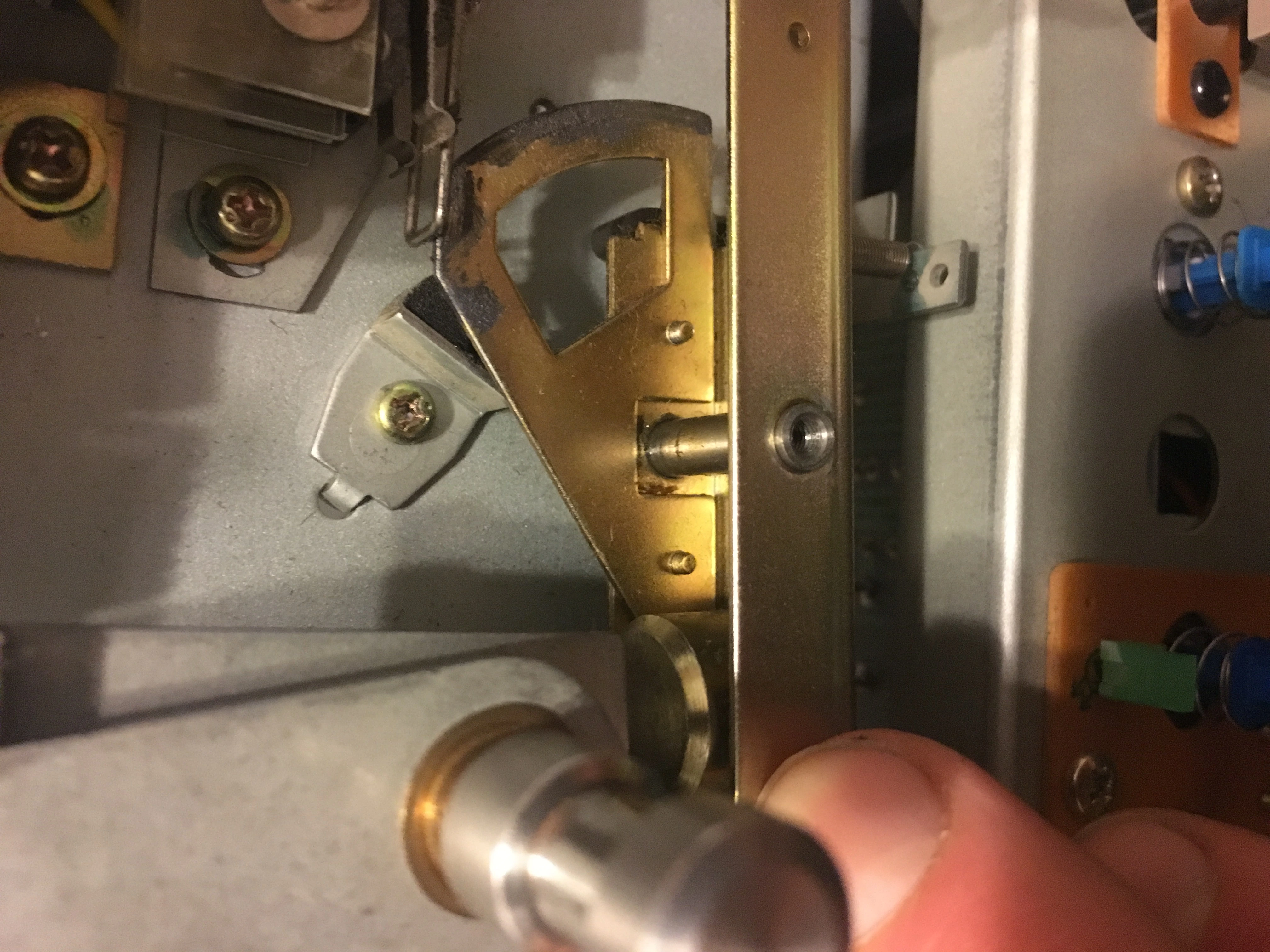

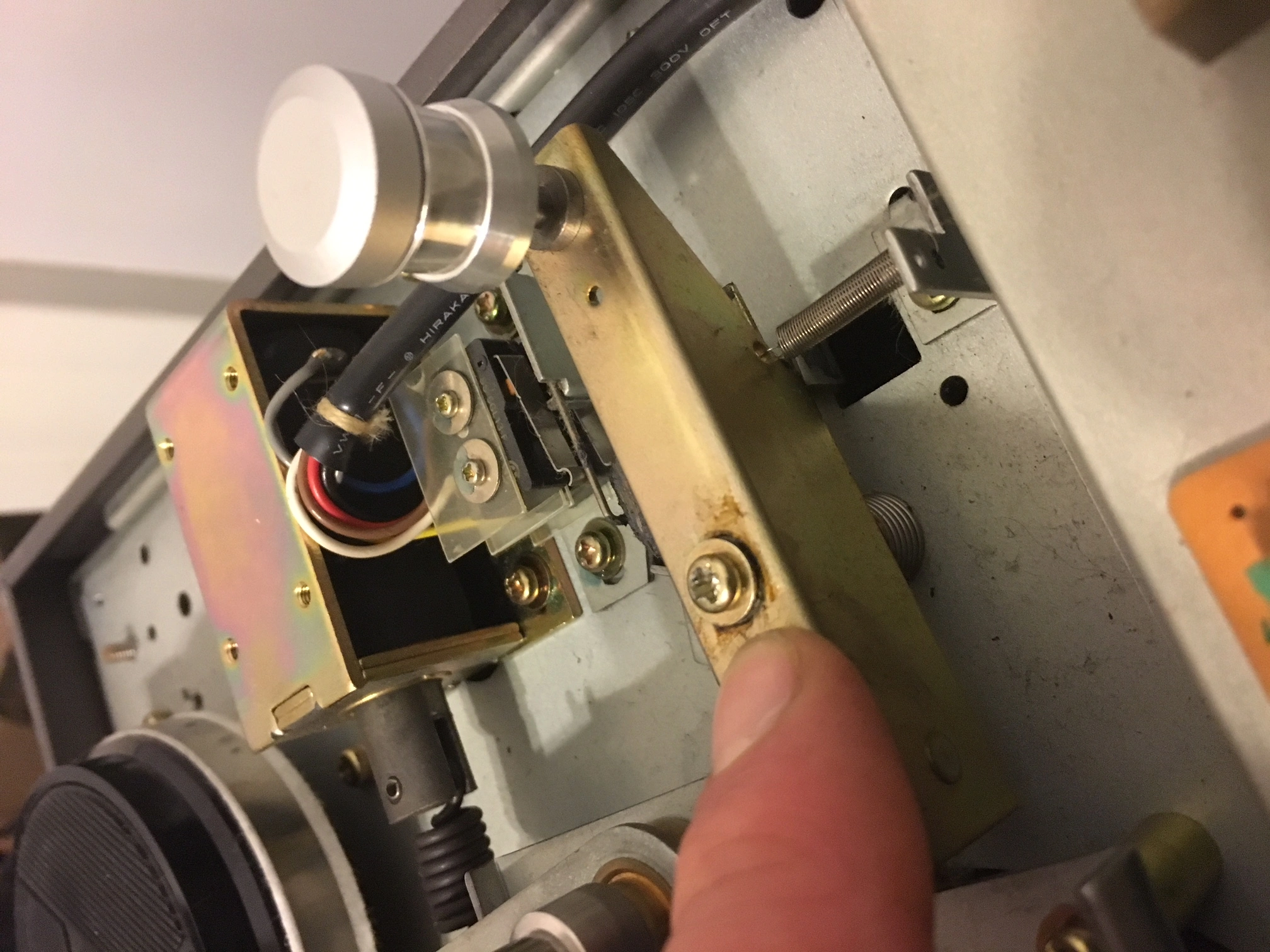

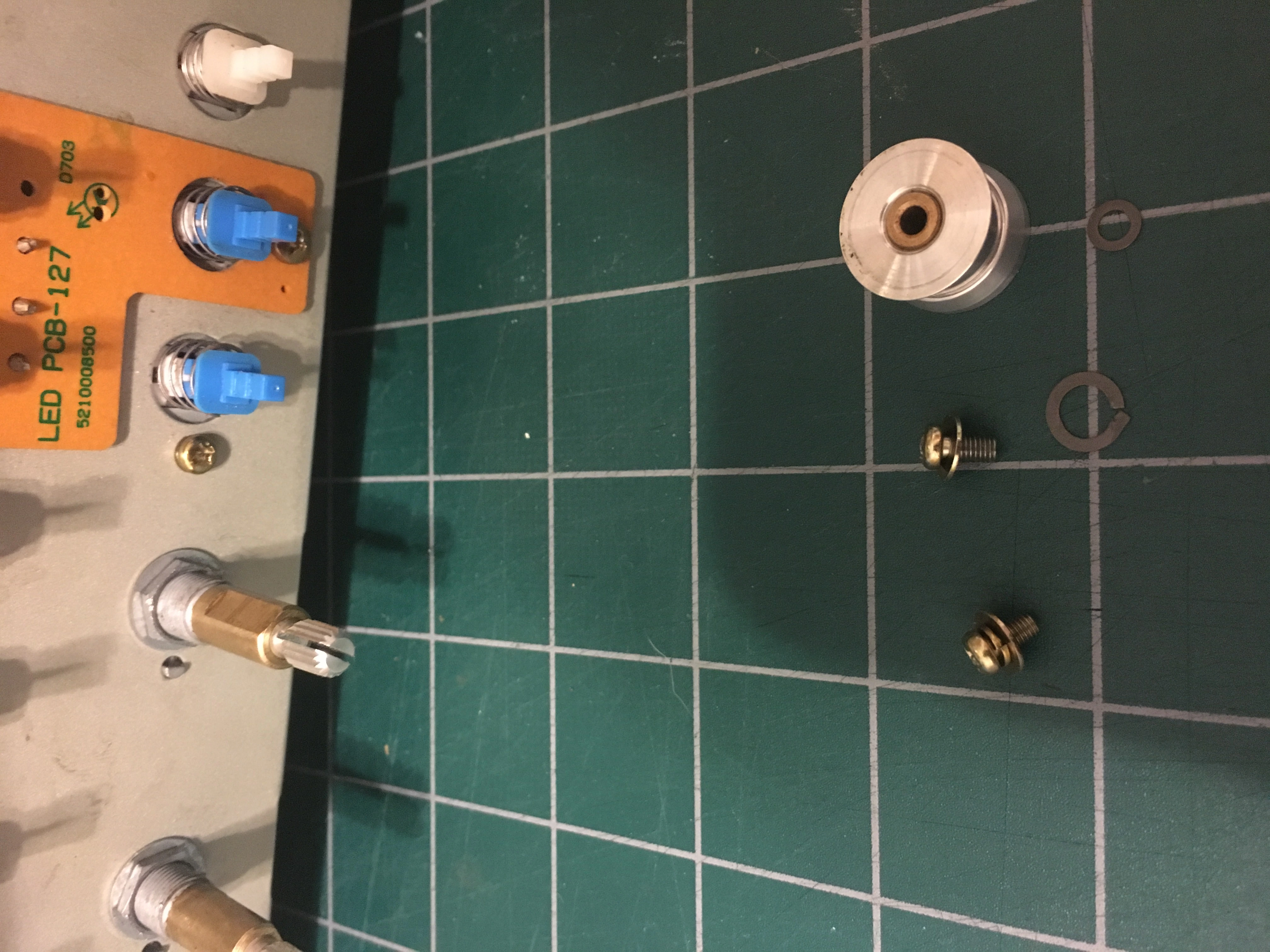

Just to be sure we are talking about the same washer, the one in questions belongs to the screw that holds the whole tension arm assembly to the base of the machine. I think you may be referring to the washers that are on the actual tension roller itself? If so, it is still helpful because I've now noticed one those is missing also. It's so strange - most of this machine appears to be in decent order but the tension arms are kind of a mess.
I'm sure it's my fault if there is a mixup. I've posted a few more pics for clarification. I removed the screw to the left tension arm assembly as an example. The one picture shows the assembly with the screw missing. The second picture shows the screw removed. So this is where it gets frustrating. Not sure how clear the photo is. But this screw has a locking washer with a large bronze washer underneath it, and a smaller thin teflon washer (on the side) that goes under that. This set up seems to be complete since the left tension arms moves freely and fluidly. The right tension arm, however, only has the large bronze washer. It is missing the locking washer and thin teflon washer. So now it seems like I need 2 parts for this piece. I also think that the part the guy at Tascam parts referenced was not for this screw, but for the tension roller.
I also forgot to mention that he told me the string is there for to give tension to the left tensions arm. He didn't elaborate beyond that. My guess is it looped around the counterweight on the inner part of the tension arm assembly. The part has been discontinued and it is not something readily available, so that too is frustrating. Maybe I can buy some string and try to replicate it somehow.
The small rubber buffer is a shock asorber for the tension arm. On my X-1000R the buffer had disintegrated, I replaced the a piece of self-adhesive 10mm thick neoprene.

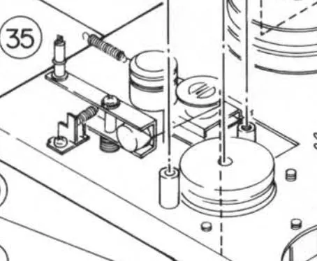

The string with the spring which goes around the black drum is a damper, which prevents the tension arms bouncing when the tape transport starts to move the tape. There are similar ones in Tascam 34 the damper assembly is mounted vertically in the 34. But from picture the 22-2 damper assembly appears to be horizontally mounted in relation to the tension arm. One end of the string should be attached to the tension arm.
Attached pic is a screen snip from the Tascam 22-4 manual of the damper, the string should have a loop, and does indeed hook around the weight on the tension arm.

Seems you should be able to come up with something for the damper string using fine braided steel cable or even stranded electrical wire and crimps or something. Maybe another member here with a 22 can measure the dimensions of the cable and loop and post?

That makes complete sense about the string's function. The string itself is actually fully intact except it snapped where the loop is. I'll have to get creative and try to come up with a replacement. Maybe use some picture wire. I just wonder who much give is needed. Maybe I could buy string and find something to replace the little metal pieces that were originally used.

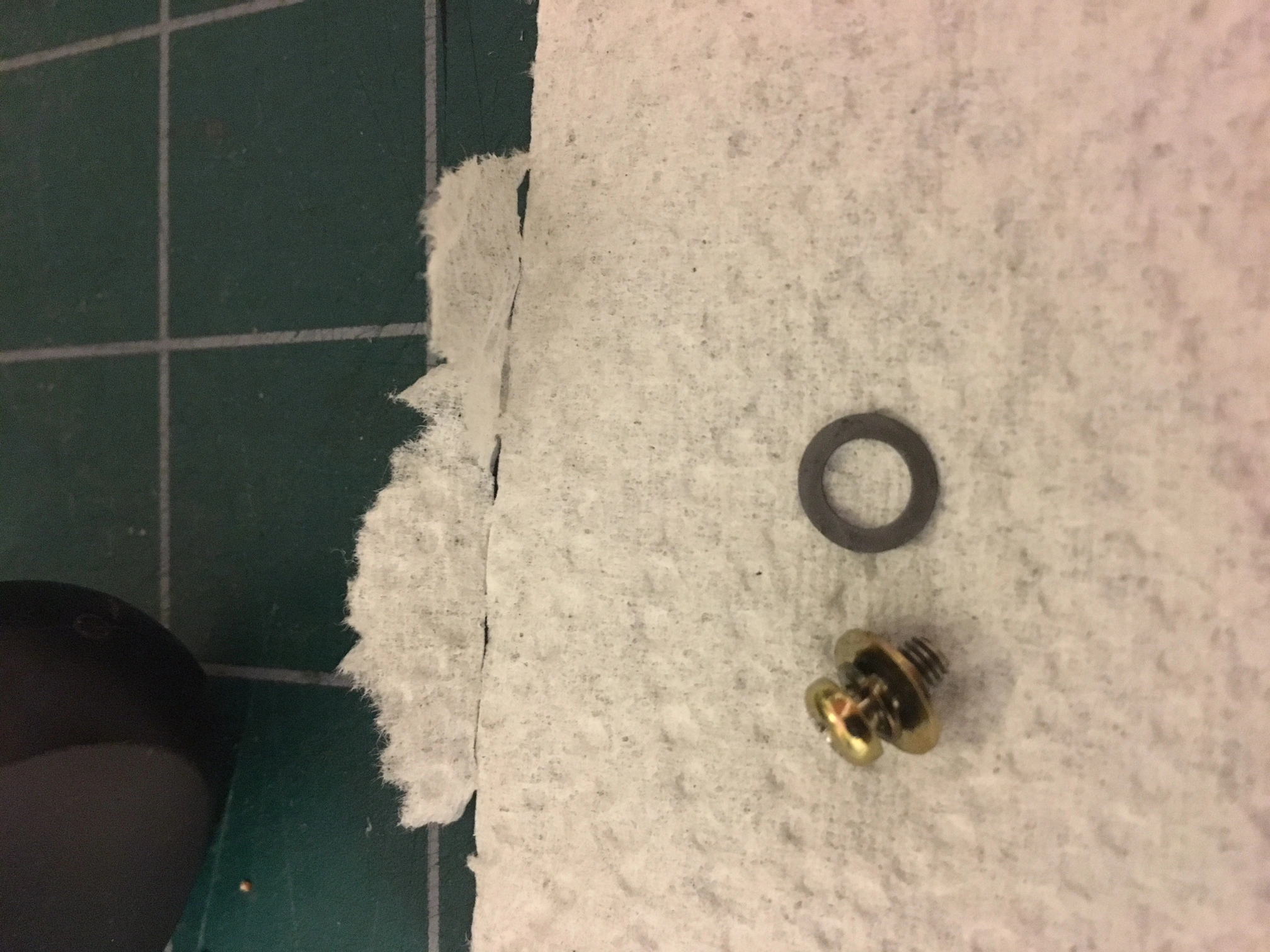

No, I need one for the tension arm assembly screw and one for the tension arm roller. I think I've made this confusing because I was bringing things up as I found them. I've included another couple pictures. The one picture shows where the tension arm assembly screw goes. In the second picture, on the right is the tension roller and the washer that goes with it. In the middle is the screw set up that held on the right tension arm assembly. On the left is the screw set up that held on the left tension arm assembly.
If you notice the screw set up for the right and left tension arm assemblies is different. The screw for the left has a smaller bronze locking washer with a larger flat bronze washer below that. The one for the right has no locking washer, but it does have the flat bronze washer, but also a black (nylon? teflon?) washer that was below it. So I'm thinking the tension arms were fiddled with my the previous owner at some point at not assembled correctly.
I did order the replacement right tension arm kit that was on eBay. The screw that came with that was identical to the screw set up on the left in the picture. So I'm wondering if the large black washer was put in as a (wrong) replacement on the right tension arm, and maybe it's not necessary.
Thanks for your patience. I know I've mixed this all up. But hopefully this helps to clarify things. I just want to make sure I'm looking for the right replacements.
