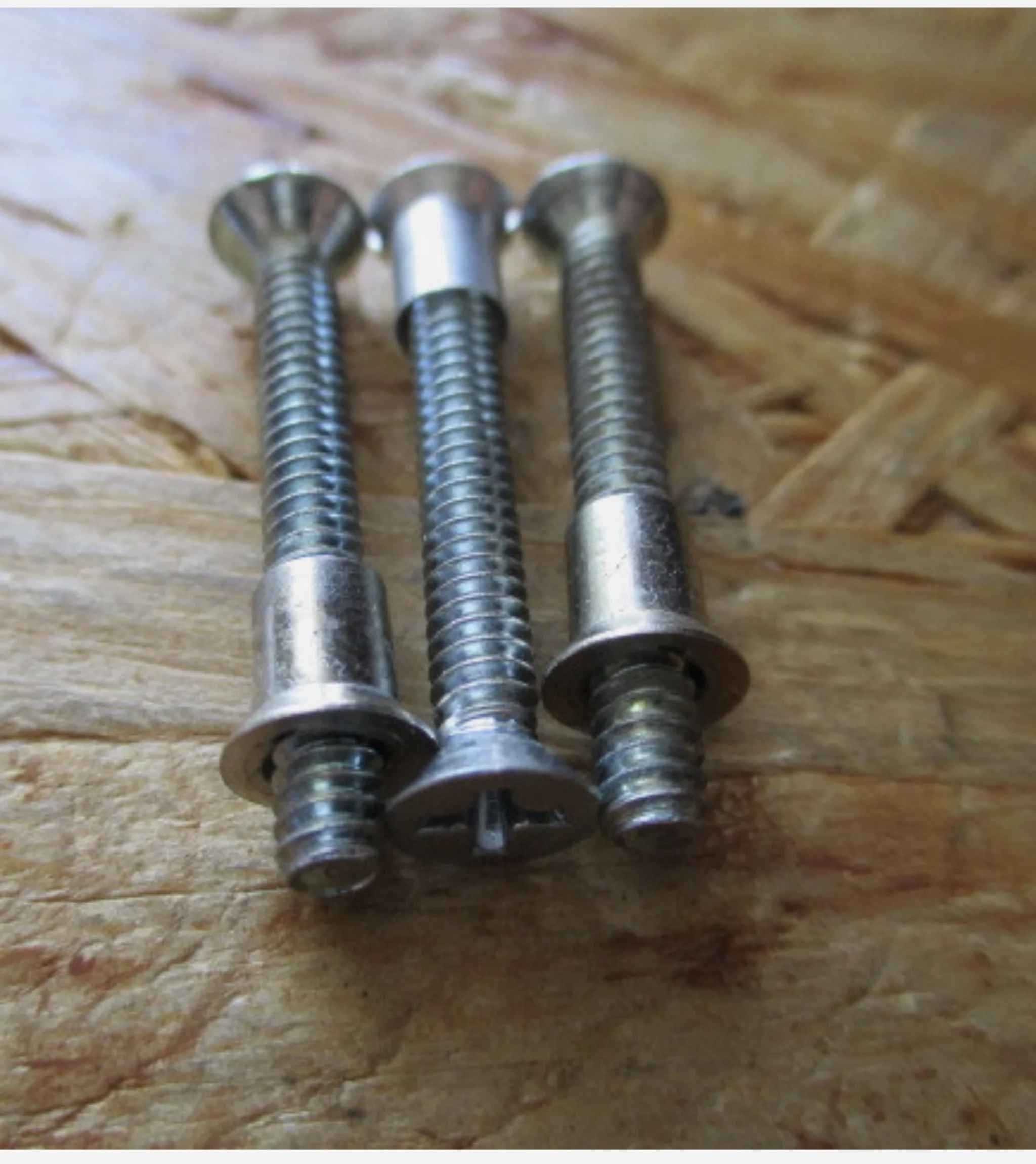

Since they are pancakes and empty 1’’ (3 screws type) are not very common cheaply, I wonder if I can use my 1/4’’ aluminium reels with the appropriate 1’’ rivet-screw combo set.
Has anyone any idea what the exact dimensions of the 1’’ reels rivets and screws are?
I've used flanges from 1/4" Ampex reels on 1/2" RTM pancakes but I don't know if the 1" tapes are the same. Some 2" tapes use 6 screws on a different radius to the 1/4" version so the flanges aren't easy to interchange. The screws are UNC 6-32 and need to be 5/8" long for half inch tapes so presumably 1 1/8" for 1" tapes. Alternatively, you could use longer barrel nuts instead of longer screws. I've often found the Ampex barrel nuts to be fragile.
Thanks for the really useful info. Aparently 1’’ e screw pancakes are exactly the same radius (checked it).
Here’s a photo of the screw-barrel set from a 1’’ ampex reel. No exact dimension given.
