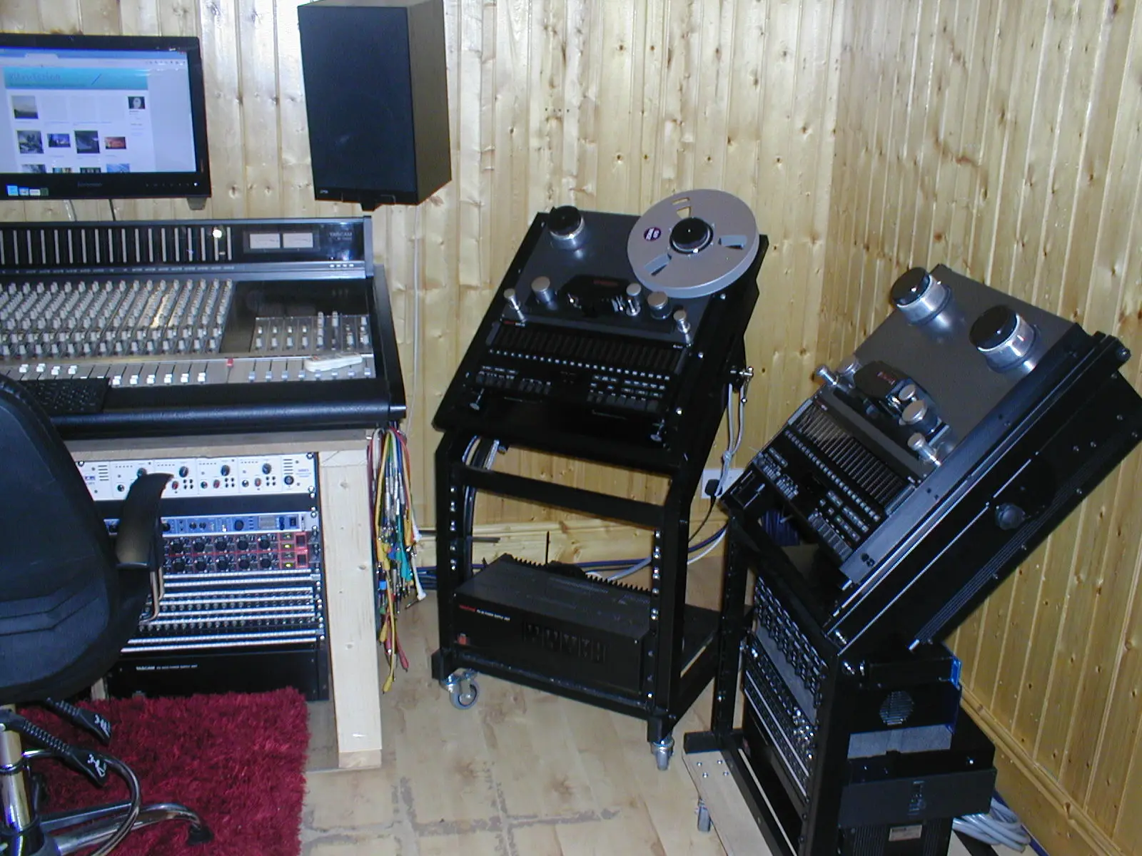

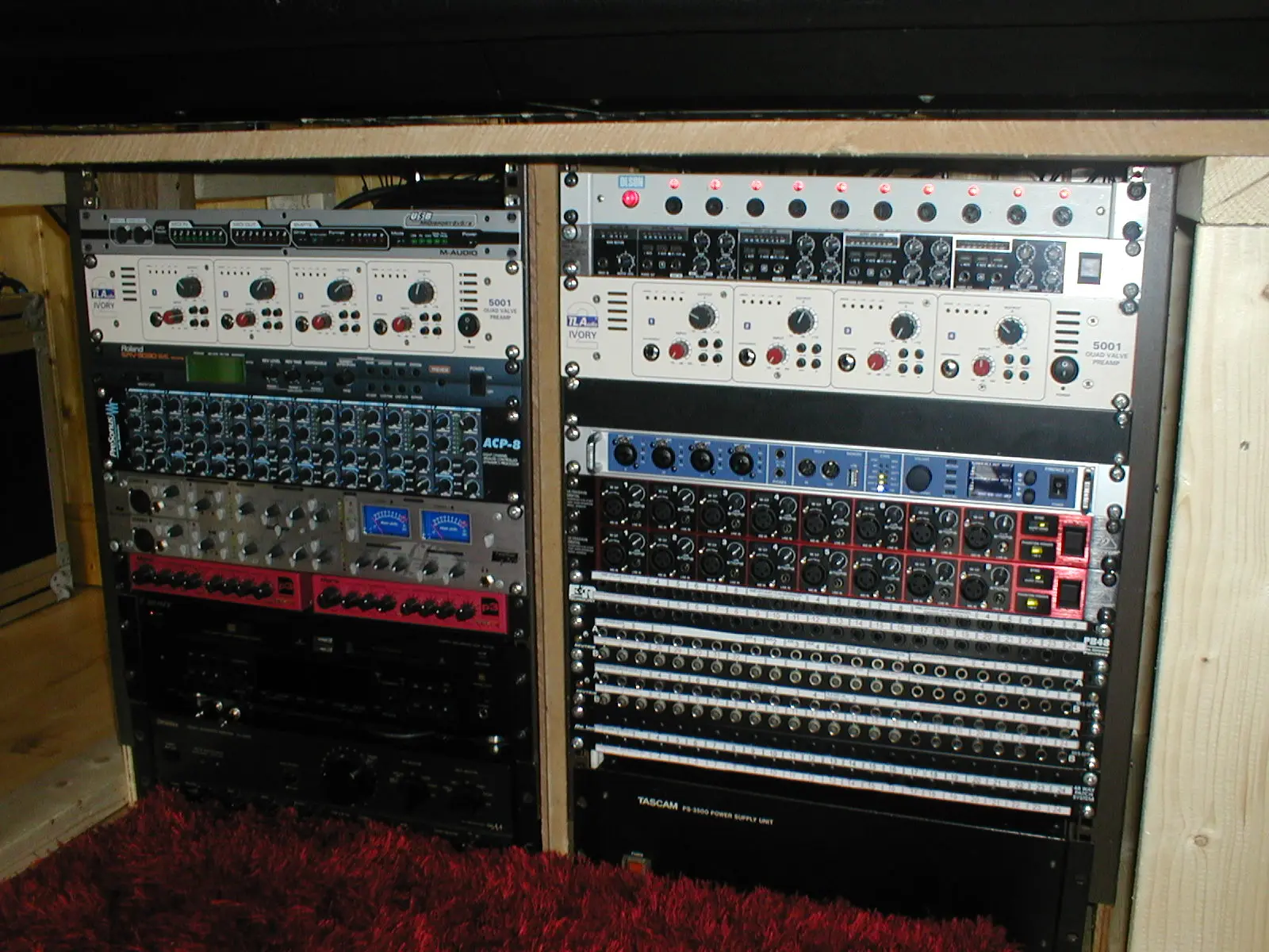

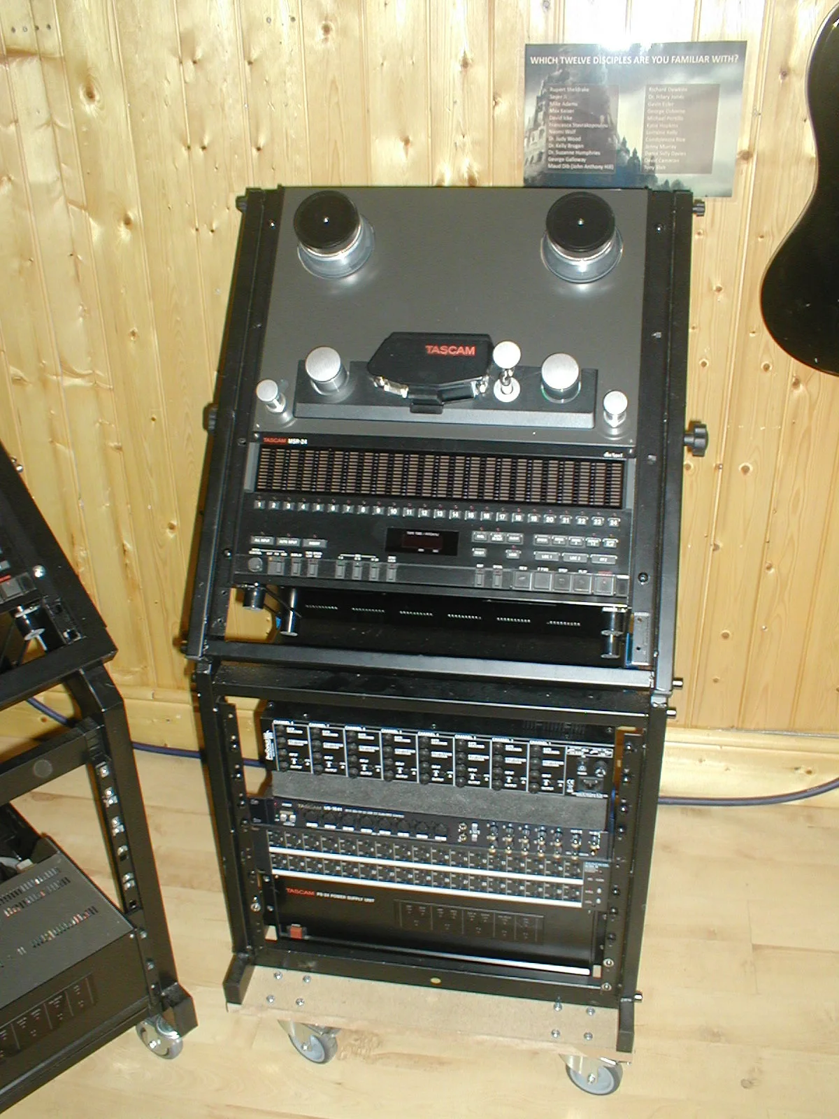

Spent more than 12 hours tearing down the studio now I've decided on which gear I'm keeping. I needed to re-do the table I had built for the M3500 and decided to re-locate all the rack gear to the space underneath the desk. I'm going to move the MSR24 back into a roll-a-round stand that I have with the space I've gained.
Another day to plug stuff back in as my legs and back gave in after such a long stint crawling about under a mixing desk.

Just wanted to say, man my studio is beginning to look good....pics to follow.
What with the MSR24 in a roll-around stand next to the M3500, we've got a TASCAMFEAST going on....
Hell it sounds good too, with the RME UFX.

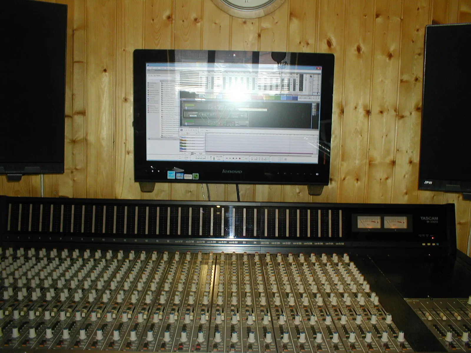

OK....just for Miro....pics and audio!
TASCAM MSR24 (2).webpTASCAM MSR24 (1).webpStudio shot 1.webpLenovo All-in-one PC.webp19 racking beneath desk (1).webp

A couple of things....everything looks really great, but I gotta ask...do you really find it comfortable to have your racks underneath your console? I would hate kicking anything by accident, and especially having to get down on my knees to make adjustments, never mind having to patch things...???
One of the things I'm doing with studio revamp courtesy of the new console, is to adjust where I have things in my racks, and I'm moving all the patchbays to a higher rack so they are more at standing eye level. I didn't have them down as low as you do, more like hip level, but I was always hunched over trying to patch shit.
I try and put the gear items that are rarely adjusted on the lower portion of my racks, and the stuff I need to get at all the time, up higher.
Anyway...whatever works...just not seeing how that's comfortable for you.
Also...do you have any kind of acoustic treatment in the room(s)...? I see a lot of nice wood panels on the walls and a hard floor, but no trapping of any kind, though I can't see all the walls, so it's hard to say.
I hear what you say about the racks being under the desk.
I don't plan on doing a whole load of patching and now at the ripe old age of 52 reaching under the desk and squatting on the floor for a few minutes each day may be the only bit of stretching and exercise I get in a day.
Once I get some ball park settings for the TLA mic pres with the different mics I own, then once again they should be pretty quick to adjust.
I haven't got a whole load of rack stuff anymore as I plan on using Reason or other DAWs for any EFX. Probably the biggest pain will be the Presonus ACP-8 when adjusting drums, but we'll see. As it is, I've ripped the studio apart so much this is how it is at the moment.

Oh by the way, you can't really tell from the pics, but the racks are set back about 18" from the console armrest, which means the engineer sits about 2 foot away from the equipment. It was a compromise that I thought was worth making in keeping the whole shebang nice and compact. I'm in no danger of kicking the equipment at that distance.

Although the control room is basically a rectangular box (4m x 6m x 2.5m) with timber cladding on the walls, it does sound pretty clean and balanced to me. I wonder if that is because of the finish. Rather than plastering the inner block wall (the studio is standard construction - a cavity wall with 4" bricks externally, 2" cavity filled with polystyrene insulation board, 4" block wall internally) I elected to batten the walls and fit 1" polystyrene sheets to the walls for heat insulation. The timber cladding is fixed to these battens. The ceiling is doubled up with an insulated void of 12", followed by another ceiling with another 6" insulation on top. It insulates well and also keeps extraneous sounds from the outside air intruding into the studio. I think the sound (lack of reflective surfaces and a little sound absorption) is probably down to the accidental nature of all this insulation.

The room may be nice and solid...no buzz or rumble...but it's all hard surfaces. You really need something to trap the low end, and some broadband trapping too. That's what will balance out the room.

Just came across this old post - I thought I recognised that particular M-3500 as I used to own it!
I bought it from a guy in Nottingham; he had managed to find a M-3700 to upgrade to and used his existing M-3500 for parts - this is the mixer I bought for about £350. It was missing a lot of knobs and some faders, didn't work properly in many ways, looked a mess but at least had the original PSU and cable. I wanted a restoration project anyway as I love electronics and audio.
I poured about £500 into it, including making up the looms and patchbays. I removed every module, socketed every IC, upgraded all the electrolytics to Panasonics. Many replacement pots, faders and knobs (thanks to Charles Hyde & Sons who were the UK spares guys for Teac/Tascam). I reckoned the mixer was dropped at some point by a previous owner, or maybe even fell over! I had to straighten the chassis and reflatten some of the fader plates. The main modules had several broken connectors and ripped pads. The blank plates (where the M-3700 automation goes) were rusty and had to be sanded and painted, as were the metal frame ends. I made a new armrest (using rubber mousepads for the main cushioning, with faux leather over the top) and eventually got everything fully working.

It's great to see how well you've restored it - fabulous job well done sir!
