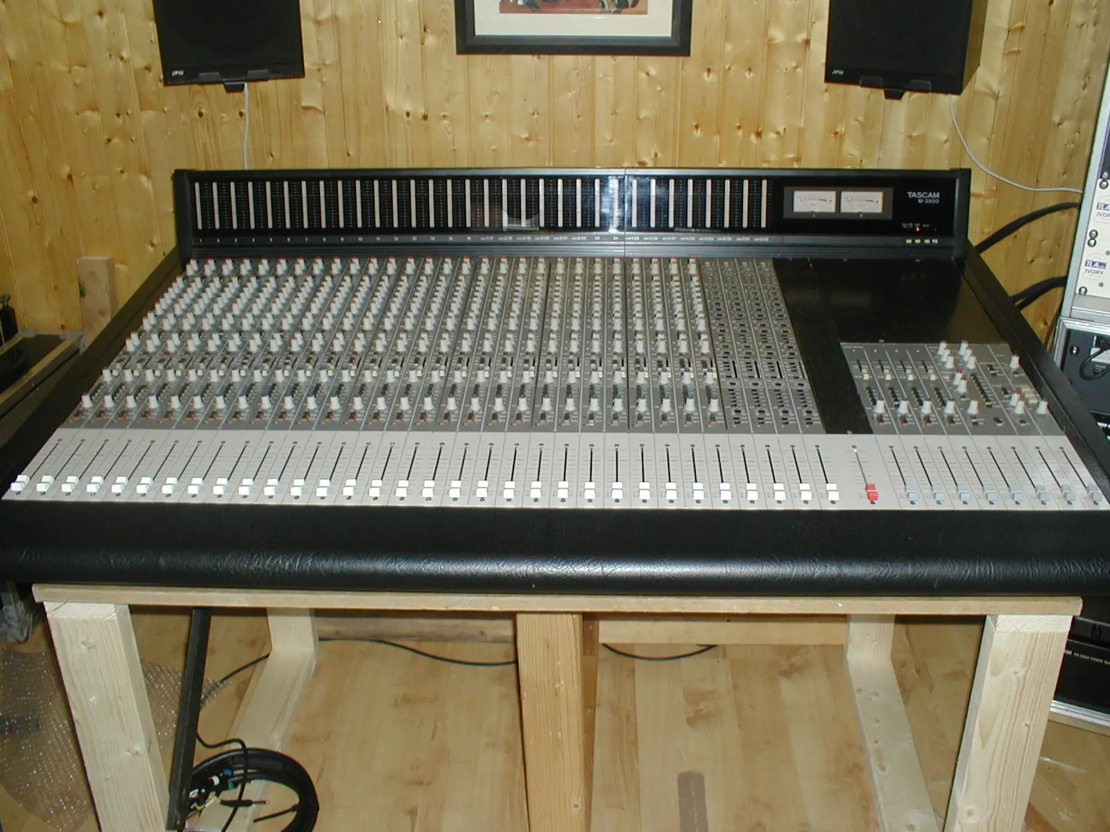

Well, it's been a journey.
I feel a lot more confident at reading a schematic now, although my brain only really works in 'serial' mode when assessing a circuit. I haven't the experience or the knowledge to understand the parallel implications of circuit design, but I can tell if a cap is knackered or in the wrong way, I've got better at the removal of resistors and caps, re-soldering etc. I also have had to re-crimp some Molex connectors, although I completely ditched my new wires for the MASTER PANEL (after a day's work) as at the time I thought it wasn't any better a solution. The console is no longer hissing, popping or behaving erratically and it is going to look terrific in the studio.

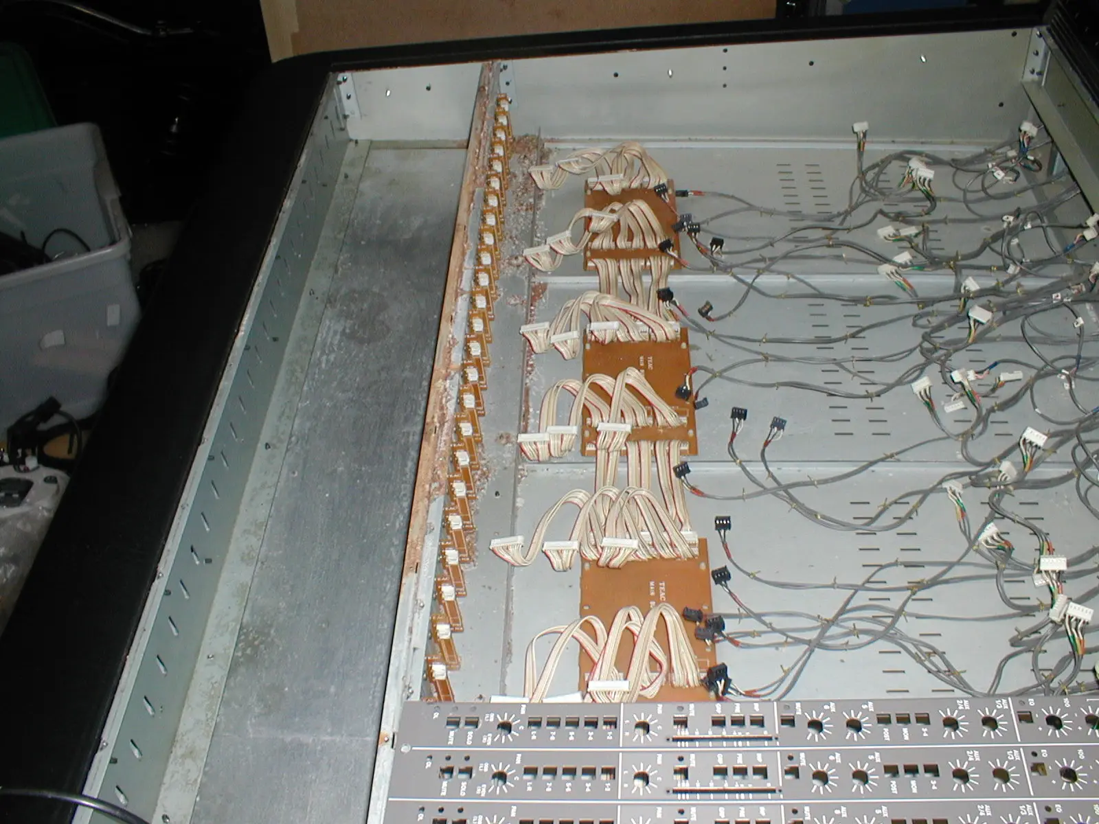

First opening of MASTER PANEL:

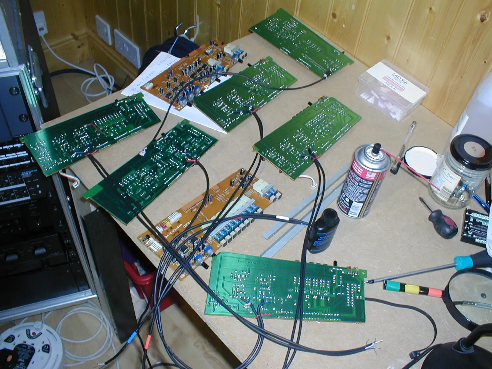

CLEANING OF CONSOLE, MODULES AND POTS:

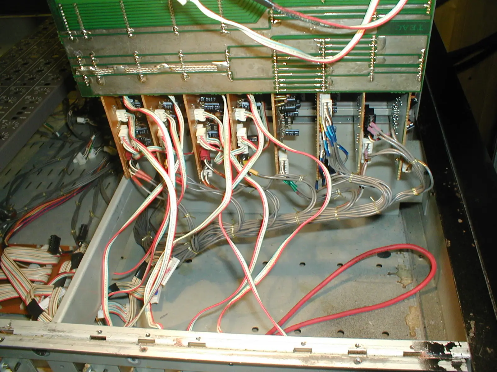

INSTALL NEW WIRING:
CONSOLE NOW:
Looking at some of the metal corrosion in the chassis...I can see why the rest of the board is showing issues with the connections, etc.
My tried and true solution to all metal-to-metal connectors....first I clean with Caig DeoxIT D100 (the pure stuff, no solvent)...wipe relatively dry...

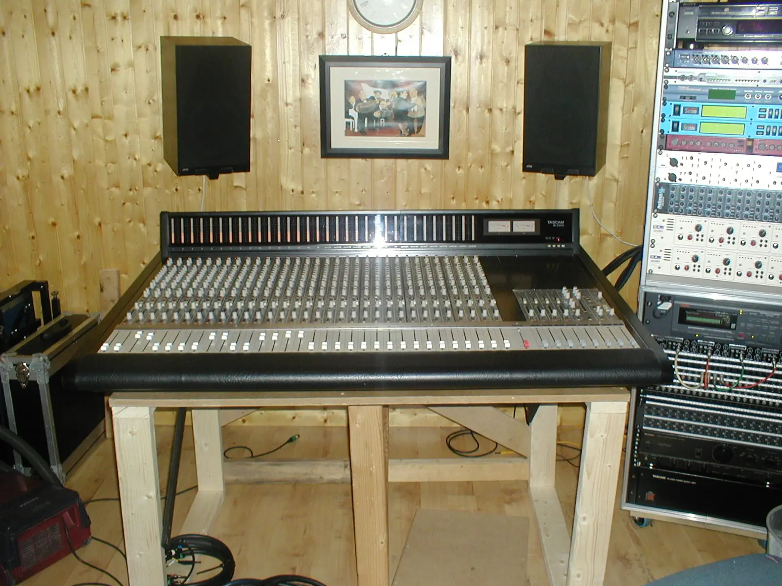

Just noticed that last pic was from before. The console now looks like this:
Guess what,,,,,turned the mixer on for this pic and GROUP 8 has gone AWOL :laughings:
I'm pretty sure it's because of the contact between the BUSS TRAY and the card itself. I'll get some of the stuff Miro suggested and the next time I dismantle the MASTER PANEL I'll thoroughly clean then ube it with the Gold stuff.
Al
So I cleaned the MASTER PANEL with the stuff Miro suggested and then applied the Gold stuff. It's sorted out everything except the 'SENSE' signal on the four EFX return solo settings....I can live with that.
