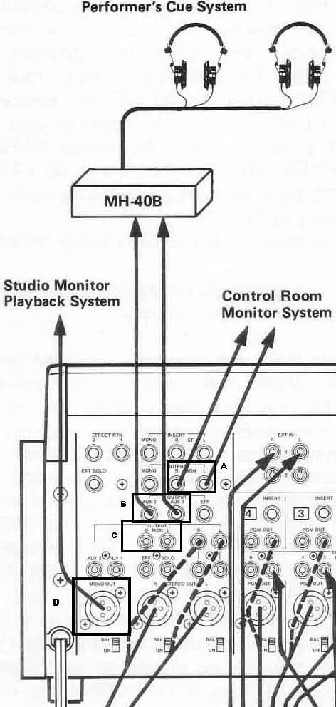

I scanned a part of the manual that shows the output section of the mixer, and I made boxes around some of the inputs that I was unclear about. :eek:
From the manual diagram, it looks like:
BOX A, (1/4" jacks) would be hooked up to my POWER MONITORS,
BOX B, (1/4" jacks) would be hooked up to the HEADPHONE AMP.
But,What would you use BOX C (RCA Output L & R) and also BOX D (XLR Mono Out) which says 'Studio Monitor Playback System' Although. I'm not sure what that means. :confused:

Box C is the -10db RCA secondary monitor out which could be used to feed your second set of powered studio monitor speakers. I made reference to them in my first post. If you look closely at those jacks, you'll see that the letters "MON" are written in-between those jacks and those stand for monitor, just like the 0db, 1/4" jacks above them.
The diagram also makes reference to the AUX 1 & 2 outs which would provide mono cue output mixers suitable for use during overdubbing but this would require setting up a separate mix which is different in level then what you've got going on through the 100mm main channel faders on each track.
The long and short answer here is that the 300 series mixers offer many ways create mixes and sub mixes depending on what your needs are. In many situations a cue mix is necessary for performers who need to hear more and less of particular parts of the production in order to perform their part to their best ability so, setting up a cue mix through AUX 1 ~ 2 can accommodate two separate mixes to two different musicians at the same time provided you have enough outboard headphone amps to feed each player their own mix. As I said, you can make it complicated or as simple as your needs and imagination desire. Simply make up their mix from the AUX 1 & 2 knobs on each channel strip. To keep it simpler, you can also just create a main stereo mix which is built from the main channel faders and pan pots.
As for what adapter-splitter to use, that will depend on what kind of connectors your powered monitor speakers have on the back of them. The mixer's side of the adapter will be a 1/4" plug and the other side will be whatever the speaker's required jack is. Most music stores and places like Radio Shack sell them.

And your box D is a mono out feed of the main stereo mix which can also be used to feed to an amp and speaker in the studio to allow the musicians in there to hear a quick mono mix of what you're doing in the control room, assuming you have a control room? :D

I never realized how many options that you have to create mixes and sub mixes with the 300 series mixer! I would actually like to keep things simple, and just use (BOX A) 1/4" Output jacks for my power monitors, and use (BOX C) RCA Outputs for my Headphone amp. BUT! I really!!!! like the idea of creating a cue mix, and using (BOX B) the AUX 1 & 2, 1/4" Output jacks for my headphone amp. So, that I have more control over what the musicians hear over the headphones! That is really cool.
So, if I connect (BOX B) Aux 1 & 2 Output jacks~ to the input of my headphone amp~ Would I then be able to control how much instrument is heard through the headphone amp, by using the AUX 1 and AUX 2 control knobs on the board? or is it a bit more complicated then that? :o
Also, what's the simplest or more straight forward way to control the mix levels, or volume when using BOX A, & BOX C ~ BOX B, I'm assuming that I would use the Aux 1 & 2 knobs. However, is there also a master level control for Aux 1&2, or no?

Ahhhhhhhhh, okay, now that makes sense. So, since (Box D) is a Mono Output, and only has one XLR jack, does that mean that you would only hook up a single powered speaker, in the control room for the musicians to hear a quick mix (assuming you have a control room, of course) and what controls the levels for (BOX D) Is it the BLUE MONO slider fader marked 'Mono' on the front of the board? :rolleyes:
The short answer here is yes; use it just like how you described to create a mix that is tailored to the performer's mix needs to play their parts.
If you want to keep it even simpler, just use the AUX 1 jack and green level controls and split that output to the stereo inputs on your headphone amp unless that unit has a mono button which would put the same sound into both their ears.
The bonus to using this performer's cue mix out is that it will leave both monitor outs available to your two different sets of powered studio monitors and will save you the need of getting that splitter/adapter we were discussing previously.
And about you question about the blue colored fader, that indeed controls the level to that balanced XLR output jack on the back panel.
Yes, the master level knobs for the AUX feeds control the over-all level of the sub-mix you created with all those green knobs on the channel strip.
