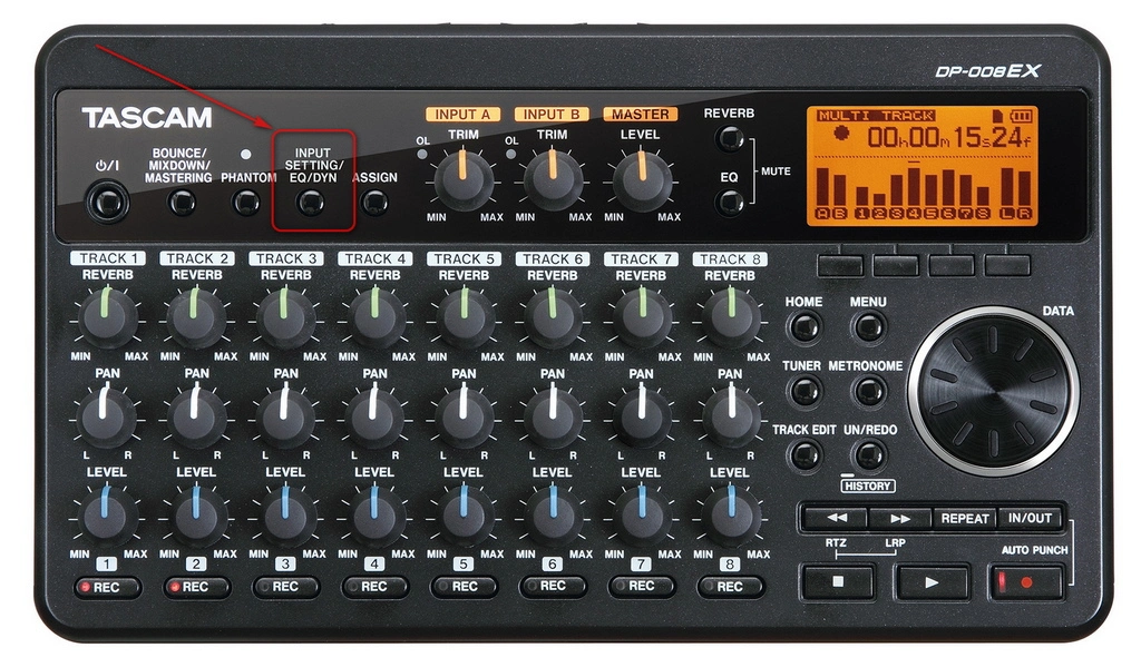

Does pushing the button noted in the image below get you a selection of inputs? I quickly looked at the manual (pg14 & 42 ?) and this is the button that was mentioned. Block diagram in the manual also shows this as a 'switchable' selection.
okee dokey ...no surprise to me ...i'm a little "slow" :guitar::rolleyes::guitar:
got it ...thanx
