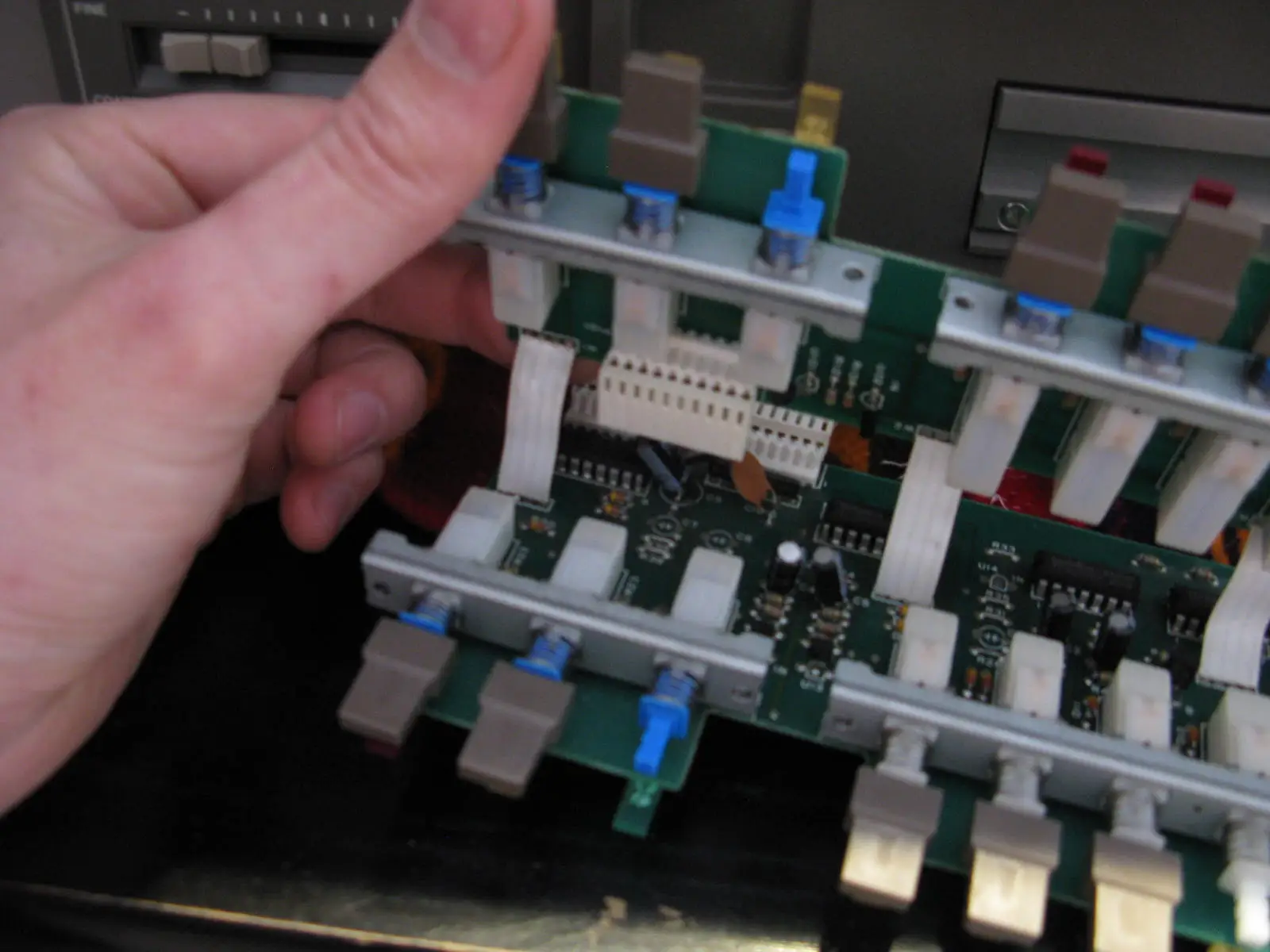

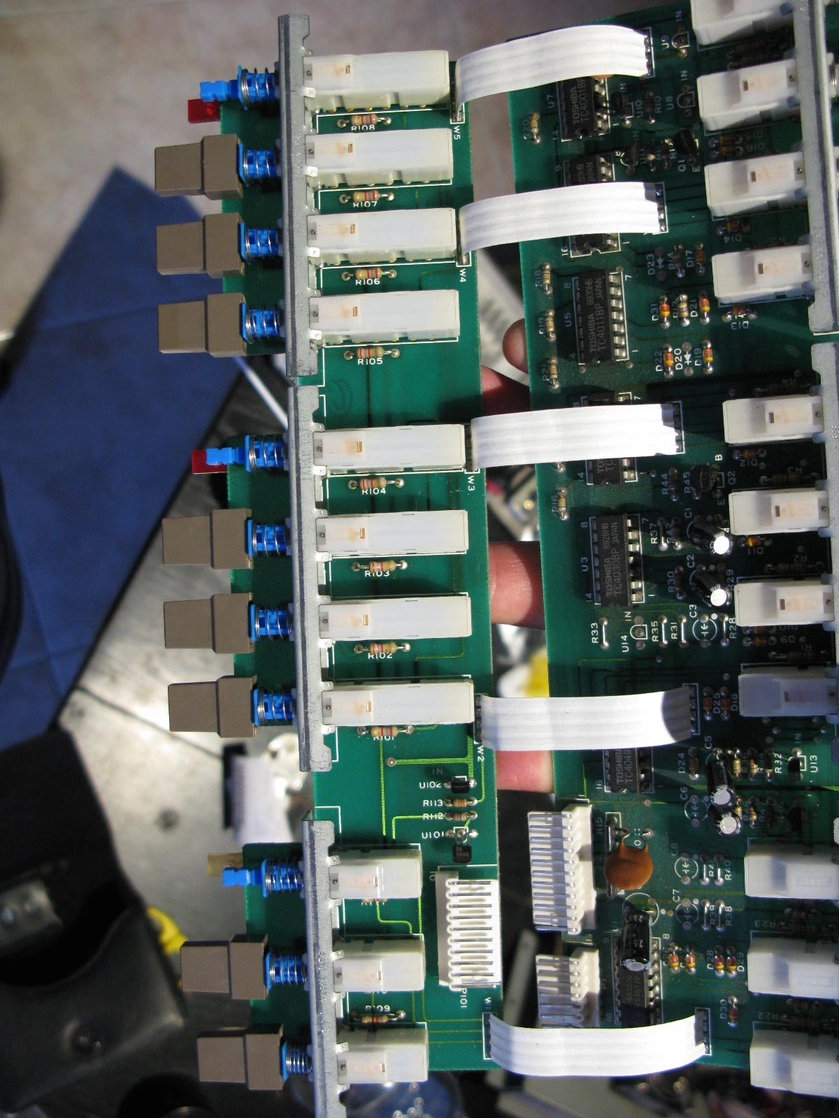

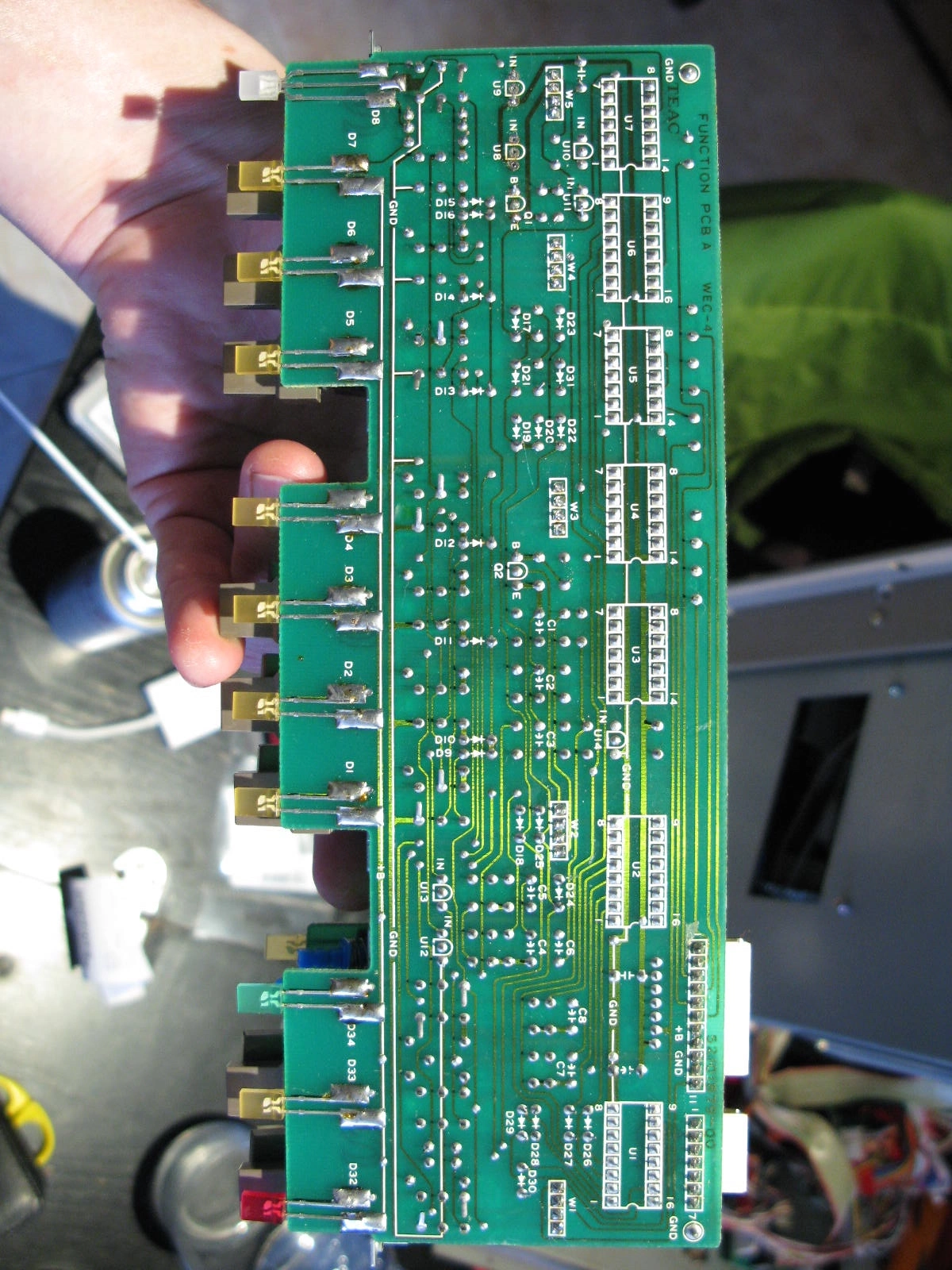

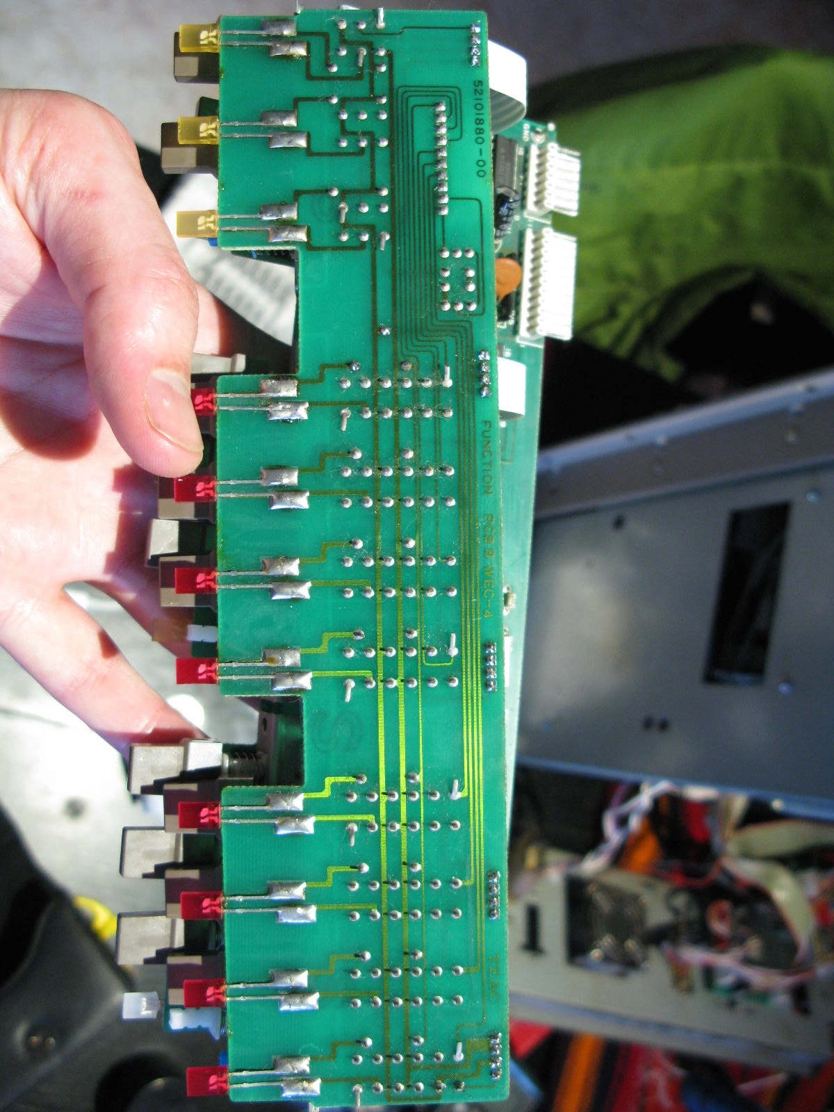

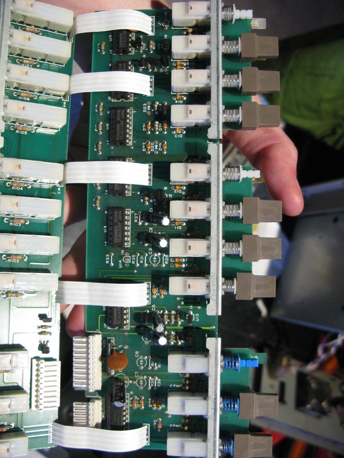

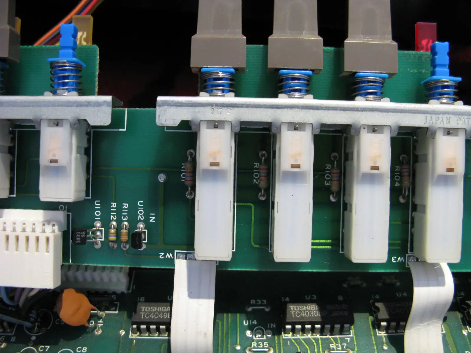

I've attached some pictures, and I've checked all the paths to the LEDs and all seems ok. There's also some resistors which I'm not sure how to test.

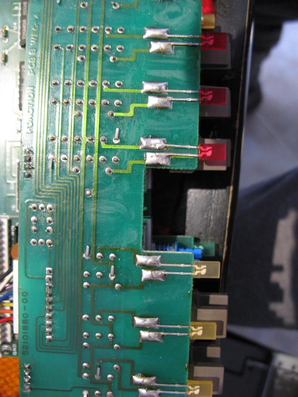

There is a gorund pin on the lower PCB assy, and I was checking the path to the REC LEDs and when touching the LEDs left leg and the ground with the multimeter I see that there is LIGHT!!! This also happens with the nearest leg of the same switch, which of course is connected to the ground
Does this narrow down the problem to a grounding issue? or maybe its the resistors?
I think I'm getting closer to the solution, just need little help from my friends!! :)

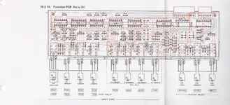

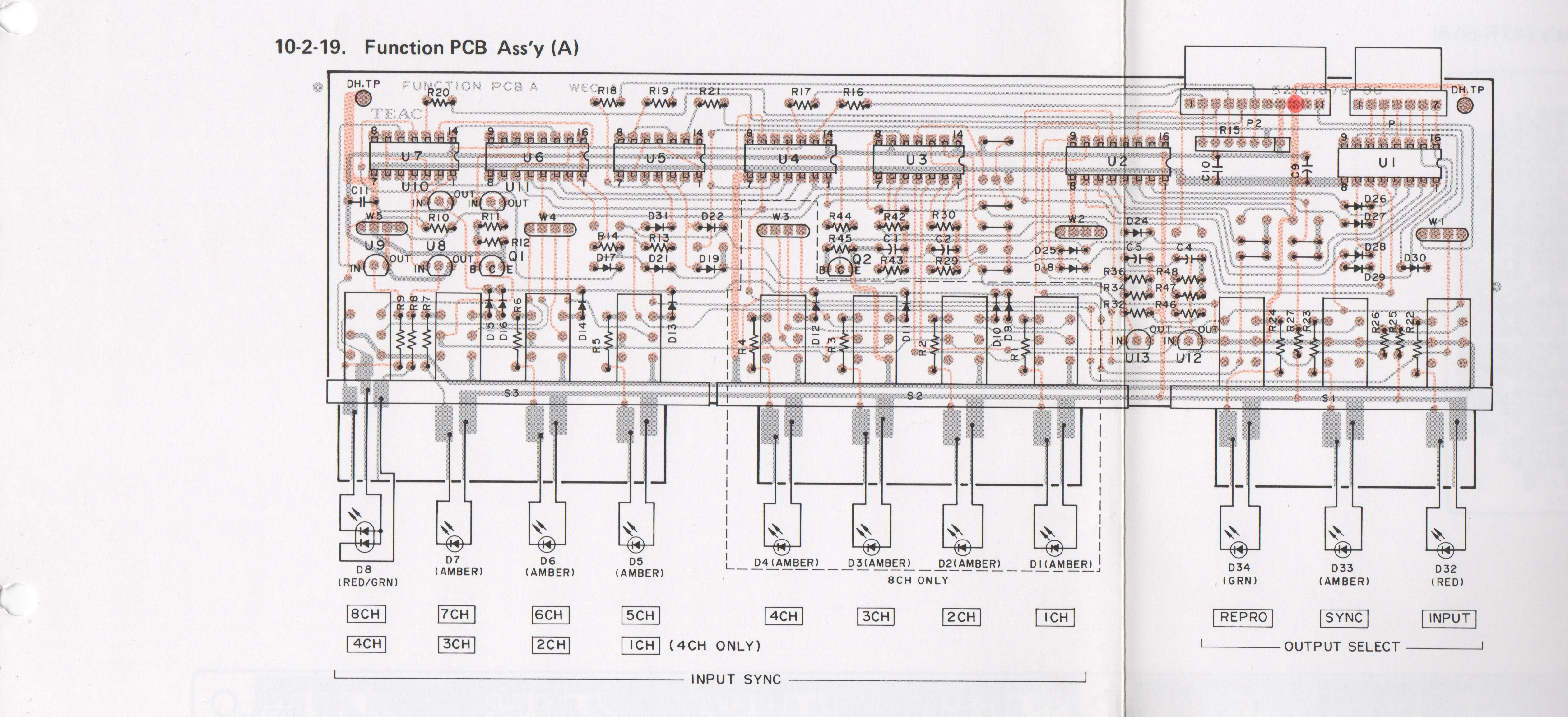

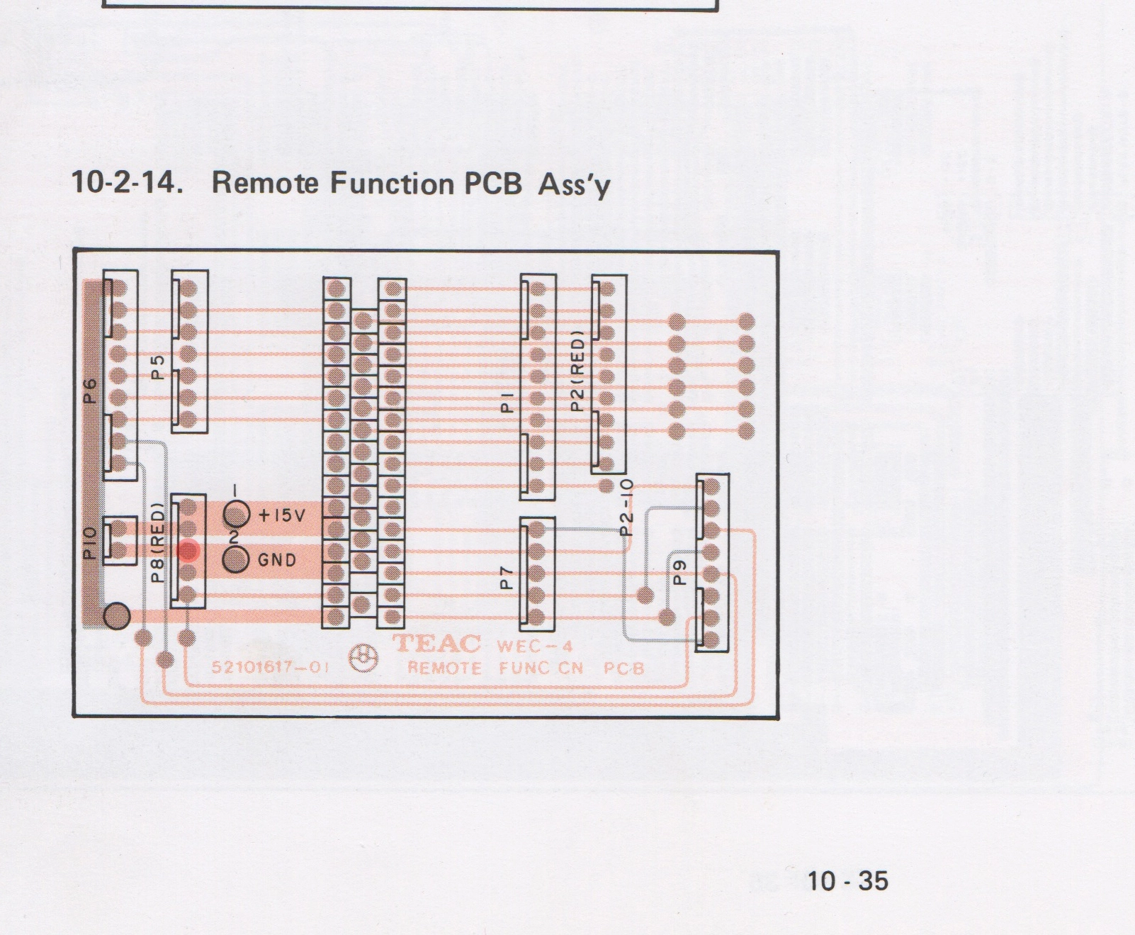

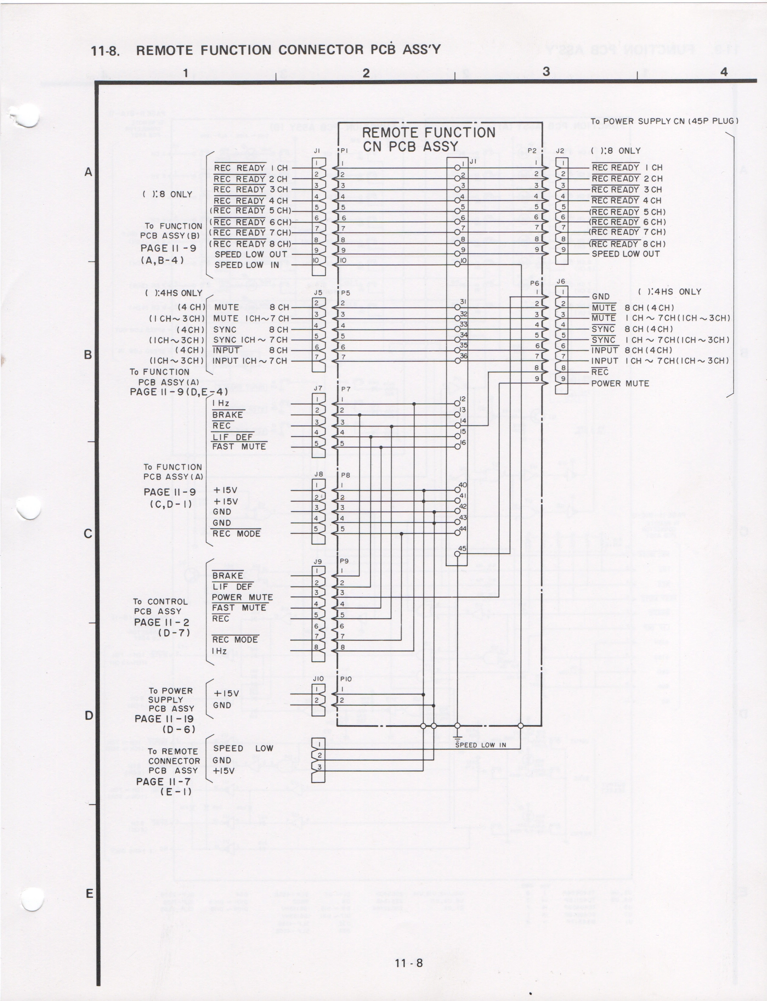

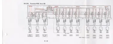

I have attached the PCB layouts, I have studied them and then I followed the ground path from the PWER PCB all the way through the wires to FUNCTION PCB ASSY A and then from this one to the the B. From there I checked everything is continuous until it ends on every REC switch.
And because the test I did makes them work, I suppose that there has to be a place where the ground reaches the LEds leg, am I right here? so I can't find this on the layout, but I'm sure with you expertize there is something I'm not seeing!!
The thing is, I'm sure the switches are working properly as I wrote on an earlier post, because when in record/play mode they light up on the VU's and repond to the ON OFF state. So the problem I have is the the LEDs themselves.
So I know I can get to the bottom of this.
cheers!!

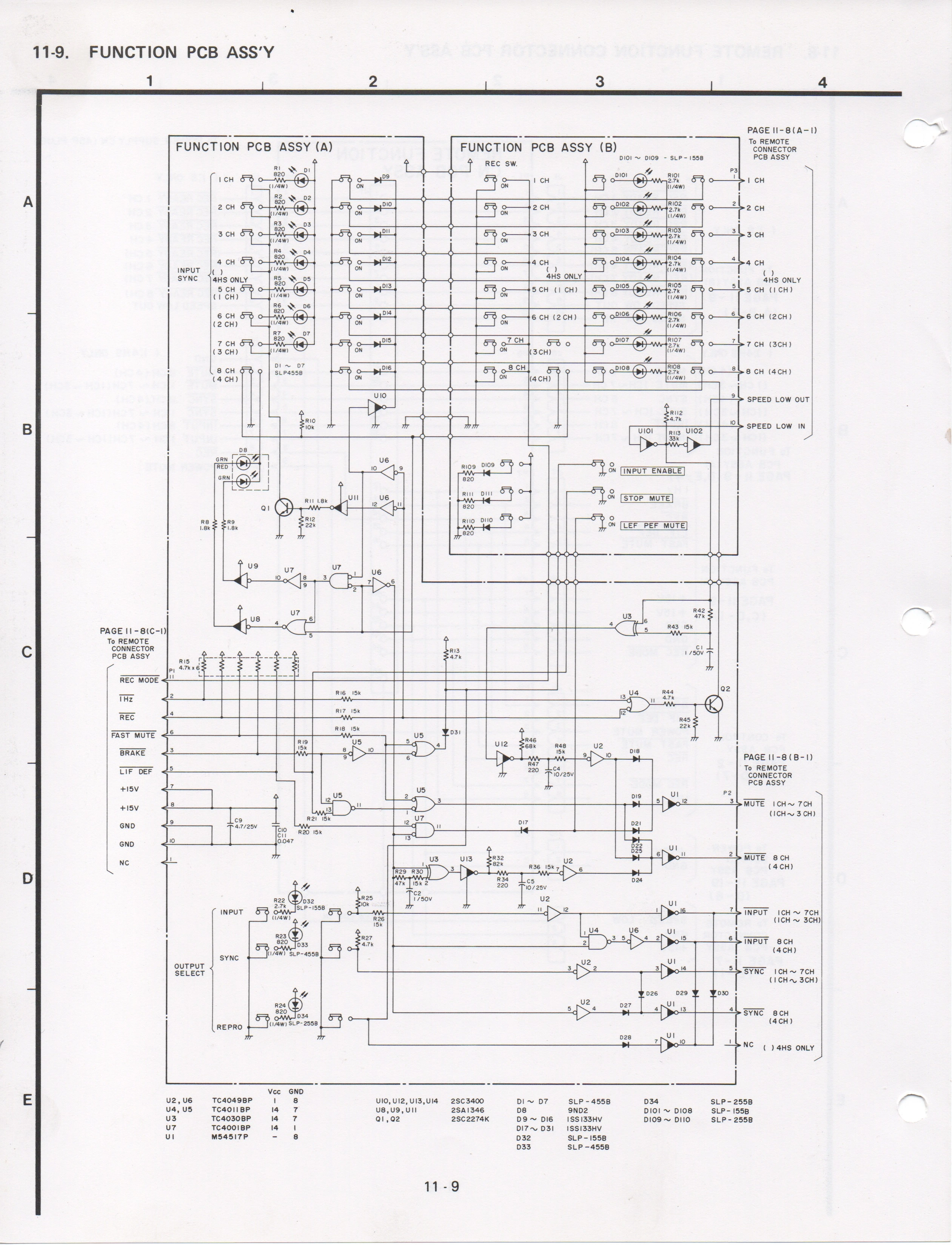

On the last schematic, (11-9), there's a two wire jumper that goes to the record switch and lamp PCB and connects to the larger PCB below which has the sync switches and lamps. The ground for the red record lamps goes through that two wire jumper. Most likely, your ground break is somewhere in that jumper path.

So I've been working long hours on this. replaced the ribbon conectors between the two PCBs that looked like broken connections, but still no red LEDS.\\\
So I've been keeping on the layouts and studying them.
I've come to see that maybe there are a pair of drivers, transistors that may be bad, as they are supposed to turn one of the lights and switch between green and red, but there is no change, so maybe this could be the driver Skywavebe at tapeheads forum told me about?

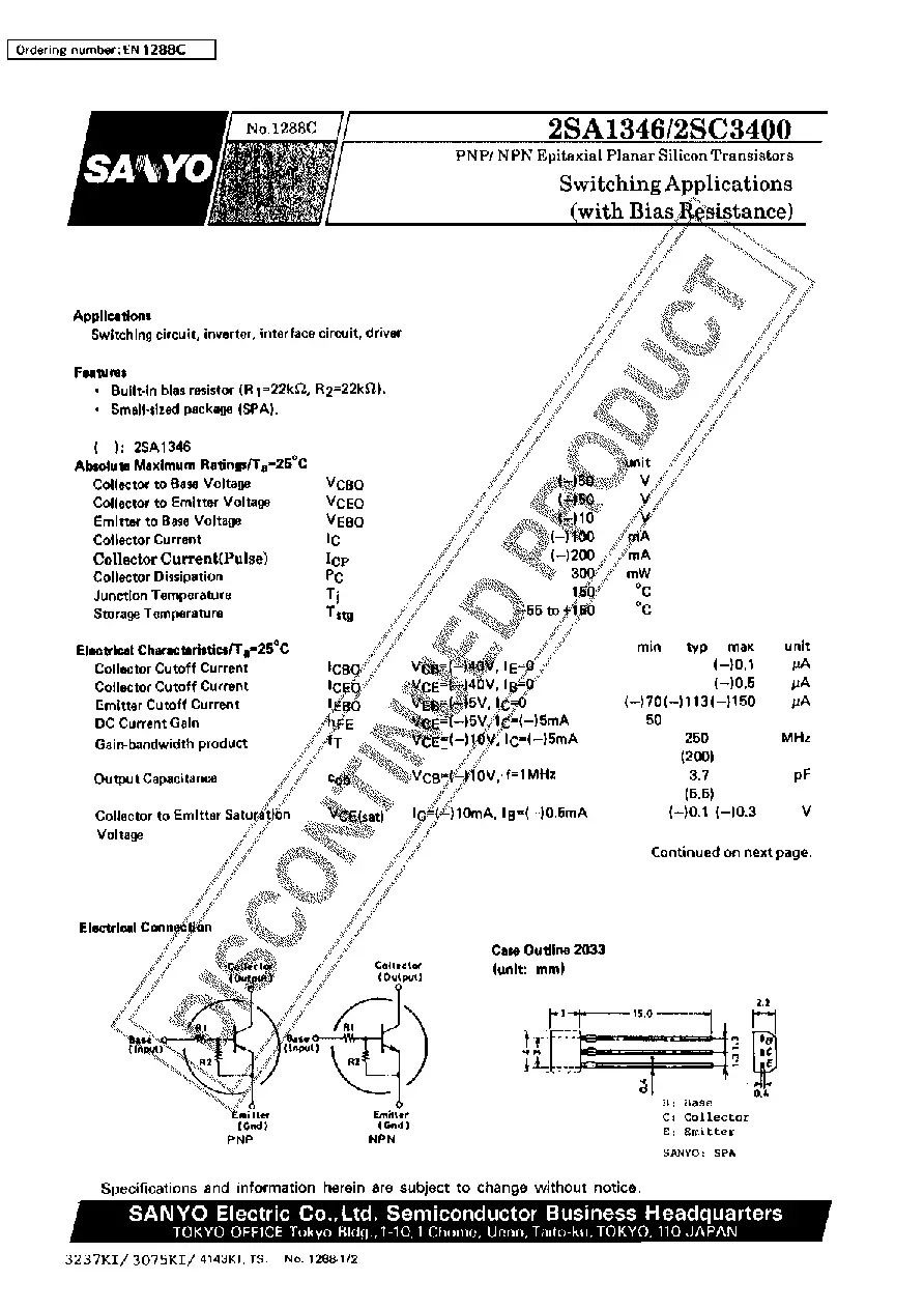

ok I've attached the datasheet for the driver. Will try to find them tomorrow and buy new ones and change them.
I saw that transistor that was going to ground and thought it might have gone bad but I have no way of confirming that over the web. Replacing it, as you plan to do, will be the surest test of its fitness, obviously. I was also hopeful that just a break in that two wire jumper would have been the simpler and cheaper fix. I made no mention of changing out the 4 wire ribbons that you mentioned replacing so I'm not sure why you took that direction?

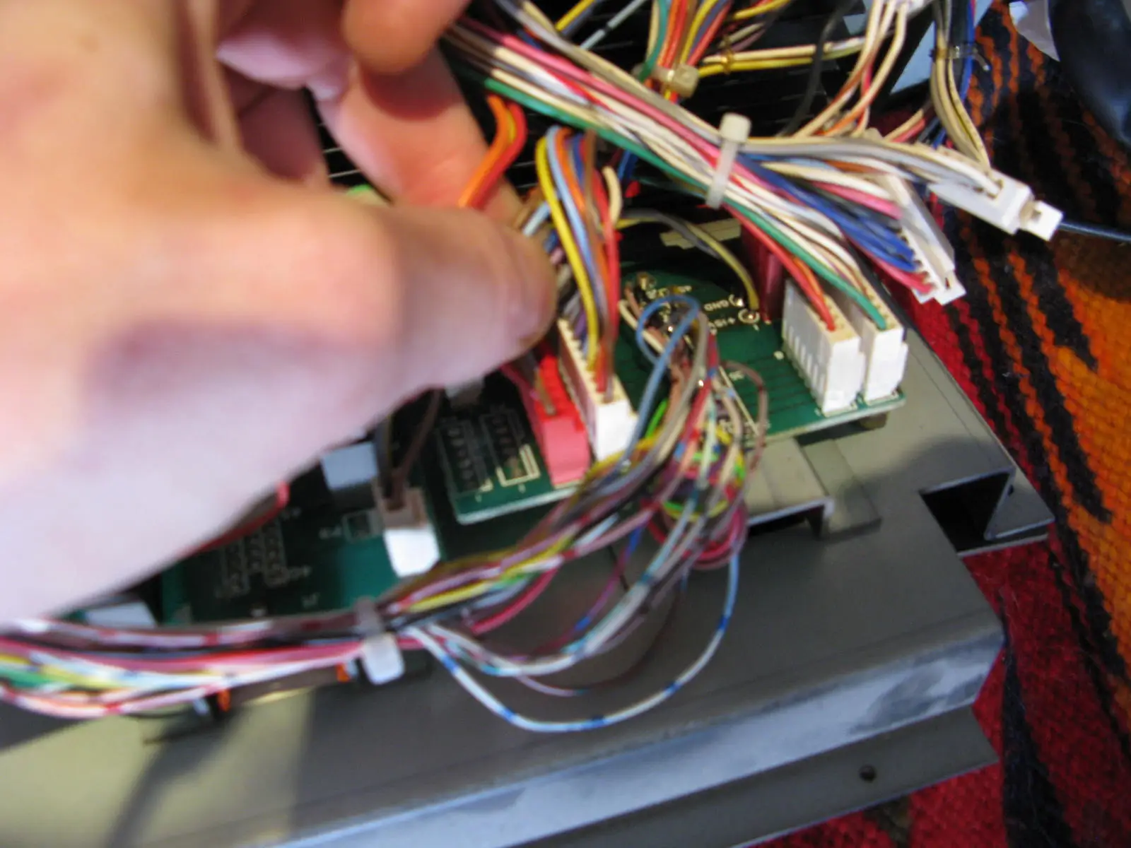

I found the two wire jumper in the layout but I couldn't see it in the PCB layout itself, I only see the connections between both PCBs happening through the 5 wire ribbons, but I can't find the jumper. So I thought maybe changing the ribbons was the way to go.
From the pictures I posted in earlier messages do you see the two wire jumper? maybe its not there because its actually missing? If you check the layout drawings could you point out where it actually is?
I'm not quite even sure what to look for, but only connection between the two PCBs are the ribbons as far as I can see.

I cant see the 2 wire jumper in any of your pics either. But your pics don't show the "control B" PCB in its entirety on both sides of that board. I would need to see that in order to figure out where that jumper should be.
Cheers! :)
Thanks for taking and posting the additional pics.
On the first photo, along the top edge of the card, I'm seeing a ground buss path imprinted on the card that runs the length of the board. The missing termination to ground jumper wire would seem to be at either end of that path as neither one seems to contact to ground, So, if you put a wire jumper in place between that spot, (first contact point at the top of that board on the left) and run a short wire to the ground terminal post on the "A" board below it which is on the corner of that A board, that should do the trick.
Why its not there in the first place is a mystery to me as the schematic you posted earlier clearly documents a connection which doesn't show up in the real world. Weird.
Anyway, you mentioned earlier that doing that temporary jumper worked to solve the issue, so just go with that and call it a day. ;)
