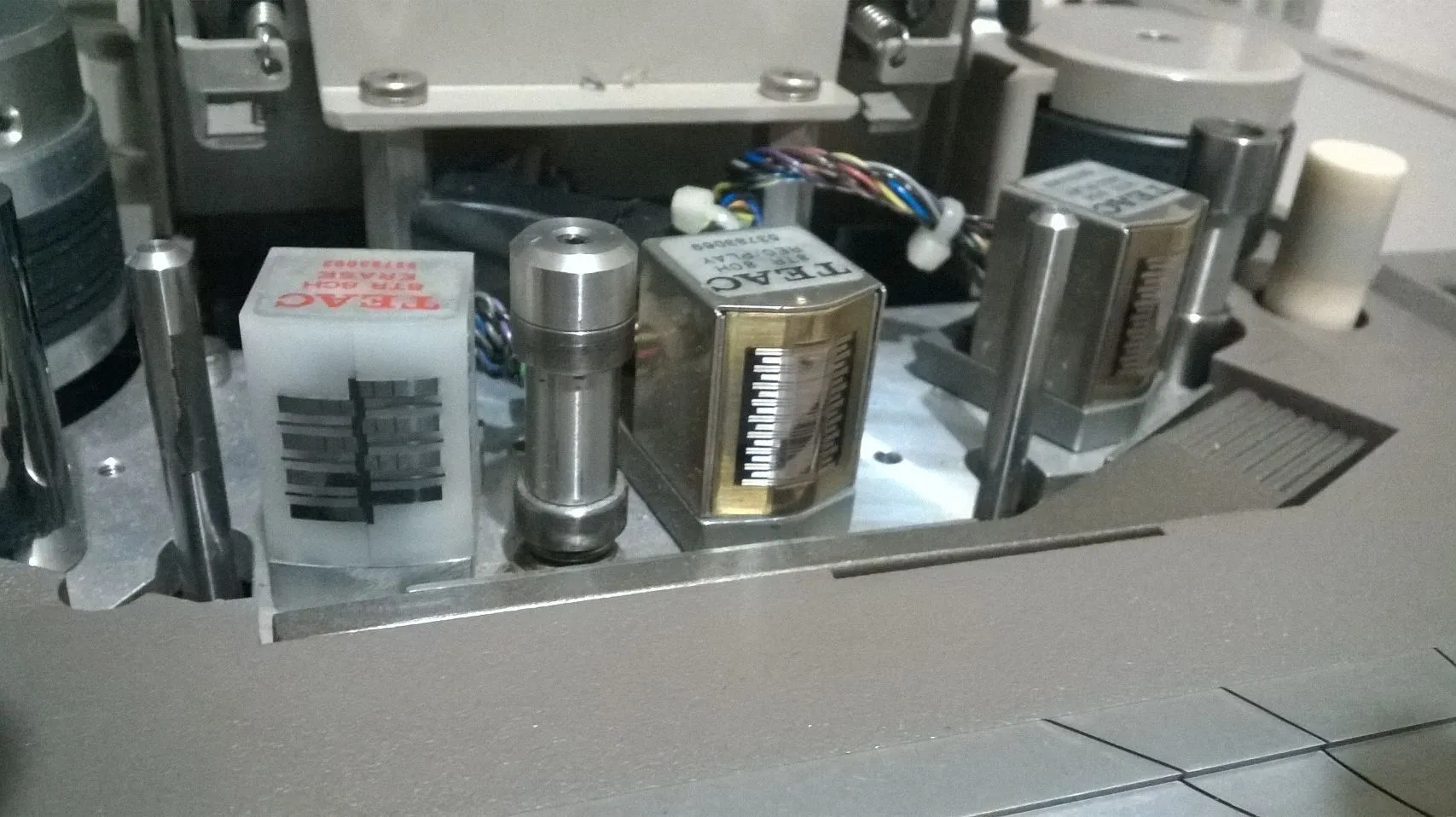

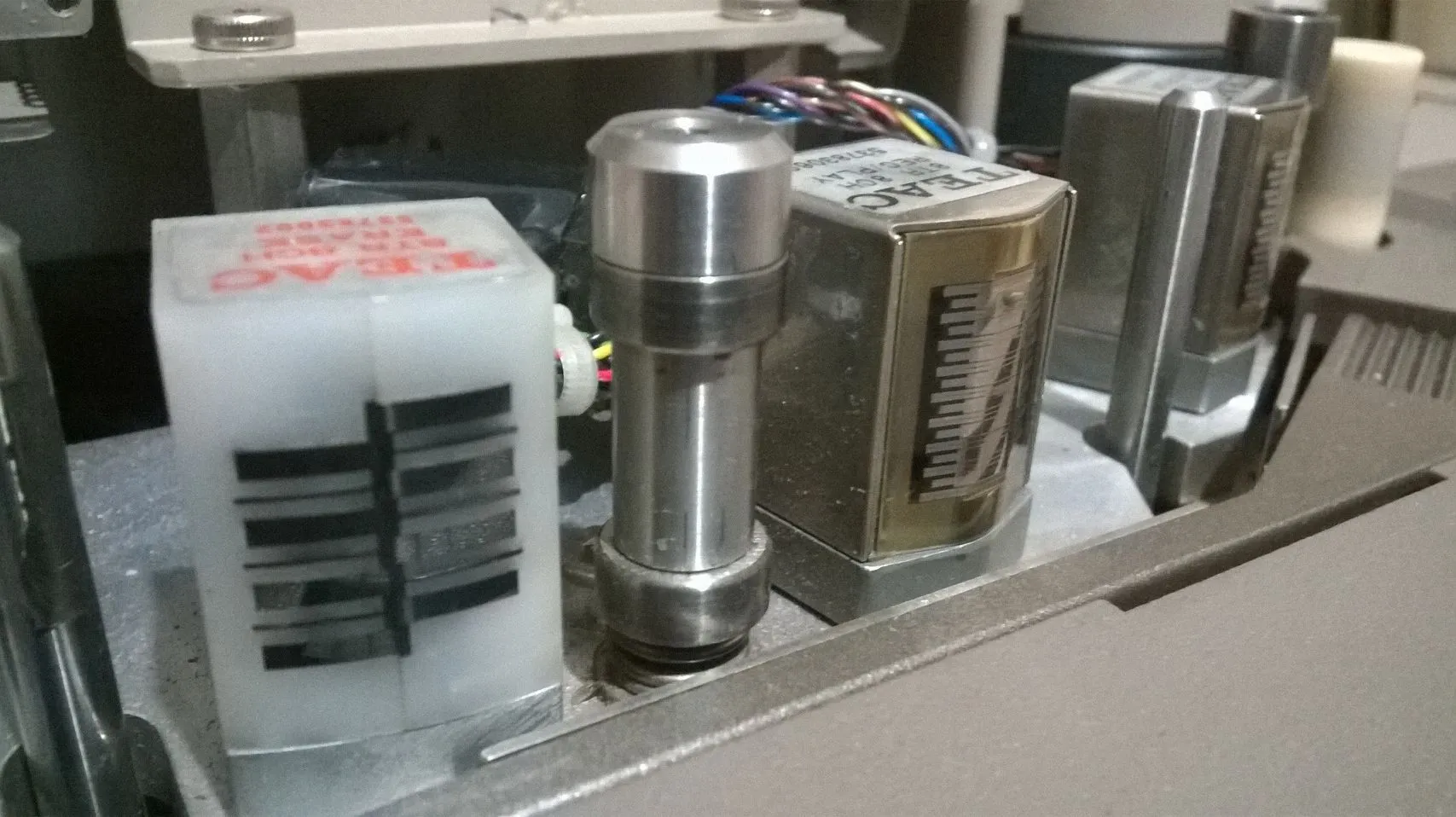

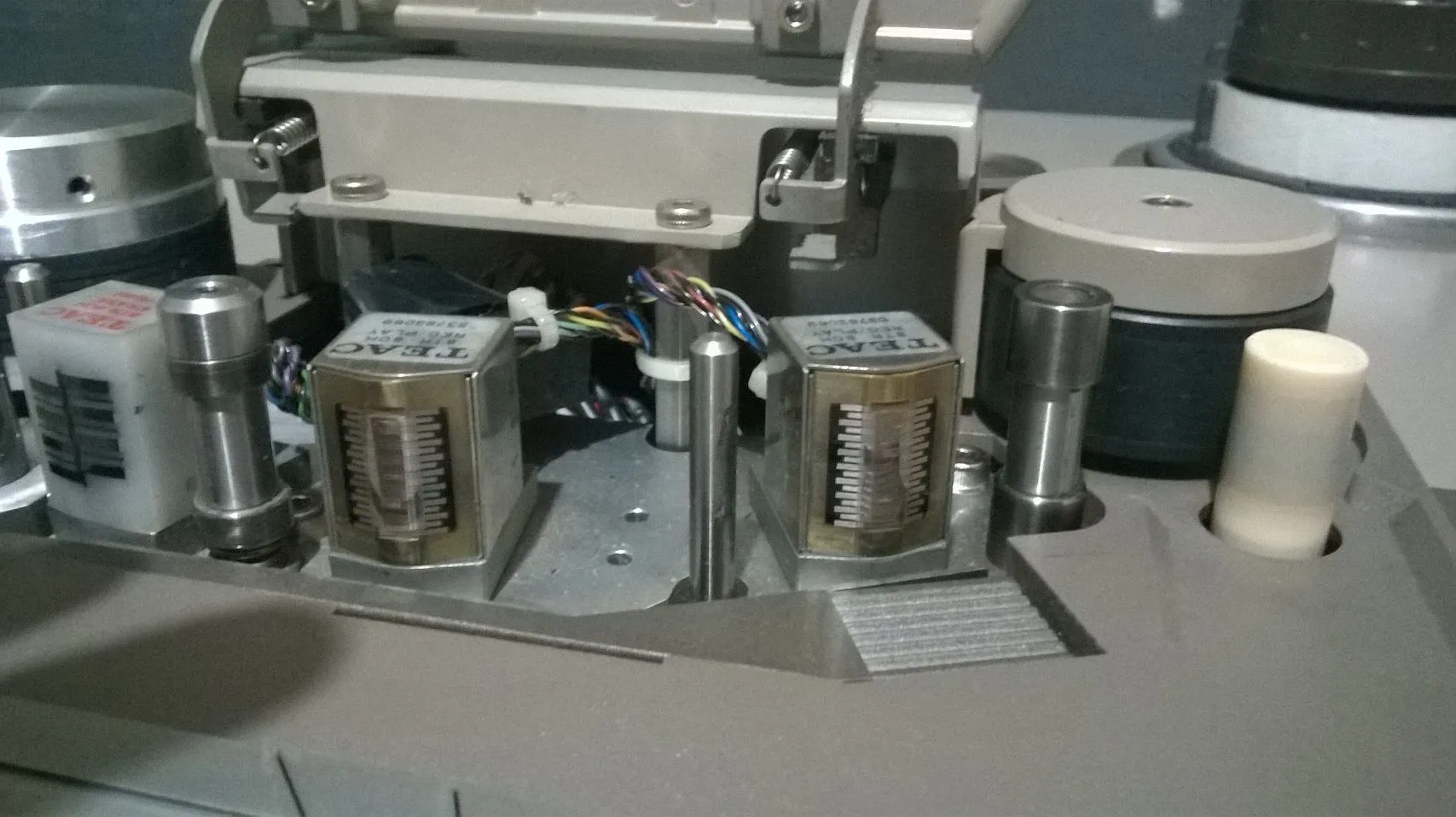

also here are pictures of the heads, how do they look to you? Not the best pictures I know but its what I've got this far.

The head wear looks pretty minimal and even top to bottom. So the mechanical alignment is good.

I think they have a lot of life left but John is the expert to ask.

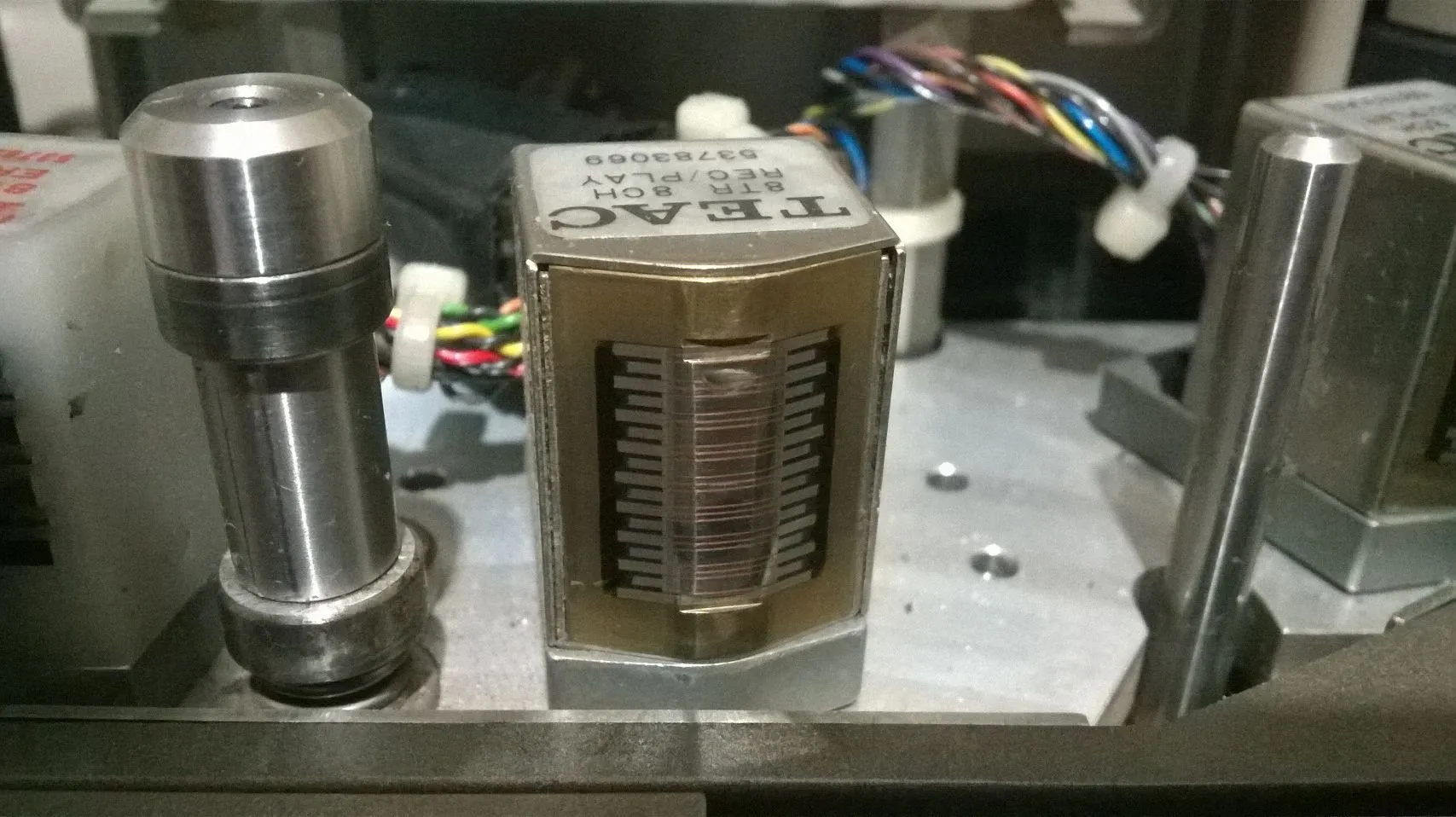

There seems to be like a blurry spot on the second head on the first channel, I saw this before but he told me all audio had been checked, but it now seems to maybe be a problem.
Can you see that stain? could this be fixed with cleaning of the heads??

If it is just a "stain", it should be able to be cleaned off with a good scrubbing with isopropyl alcohol or methanol if its really caked on, ala sticky shed residue.
If its anything other then a stain, I'm not sure what to say without seeing it in person.

I think...
the heads look like-new, lifters show no wear, save for some sticky shed on one of the posts.
The crown, contact area of the heads still have that curved appearance of a new head, not a flat spot like a used head.
I'd say if all the components and interconnect cables are accounted for, go for it.

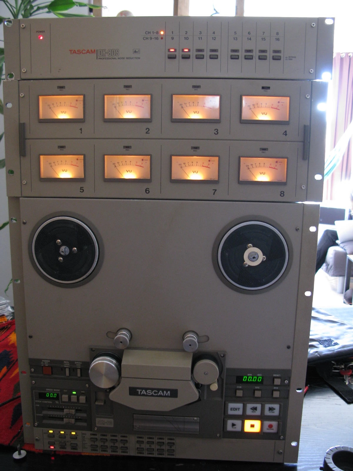

Ok So I’m back from the trip and got the machine with me!!
Everything seemed to come together as the day I was going to test it I received an answer fro John French about the heads saying they looked very good with life left in them and offered good prices for relaxing or even new ones! And when I got there the heads were clean and the stain appears to be gone!
Now for the testing part. The seller said a technician tried the machine and made a bounce with it from another deck, and apart from the tranport craziness everything is ok. It appears the machine has had all its caps changed by previous owner, this the technician confirmed, and pinch roller appears ing greatshape so do the lifters! so this was great news!
EVEN THOUGH I didn’t have that much time to try it out, just got to make sure the signal got to the vumeters, every cable was there, and everything turns on, and tried out all the switches.

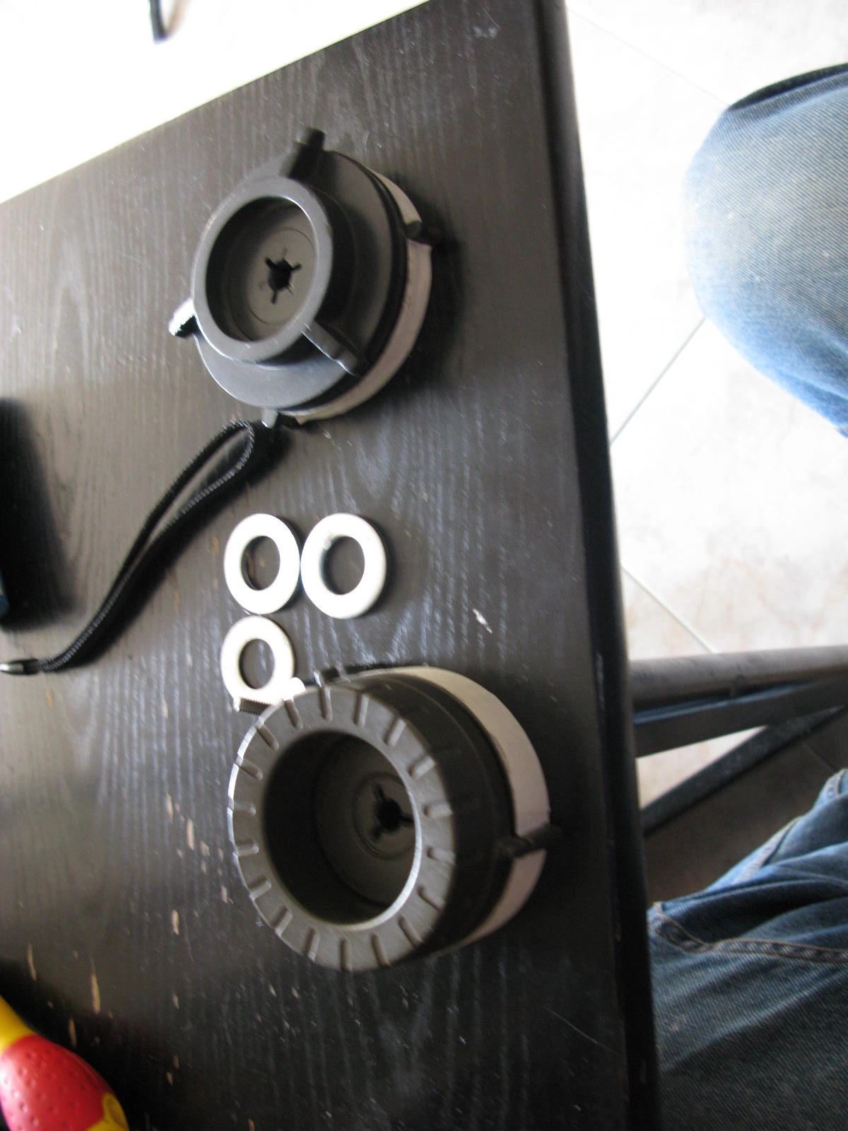

I loaded a tape he had and noticed that the NAB adapters are in pretty bad shape, one original tascam that appears to be faulty and another one (don’t know what brand) that uses a couple of washers to get the right distance!
Everything appeared ok, the only problem of course was the craziness of the transport controls, they went ll over the place, when pressing PLAY all buttons seemed to light on and machine went crazy. Then after turning it on and off again something different happened.
But the problem I didn’t get is that the rec buttons for arming tracks appears to not be working, none of the lights come on, but everything else on the module works OK. But as I knew the price is great and have the original manual with me, went ahead and took a risk and brought it home. I believe as the heads are ok anything else I can fix with a little patience.

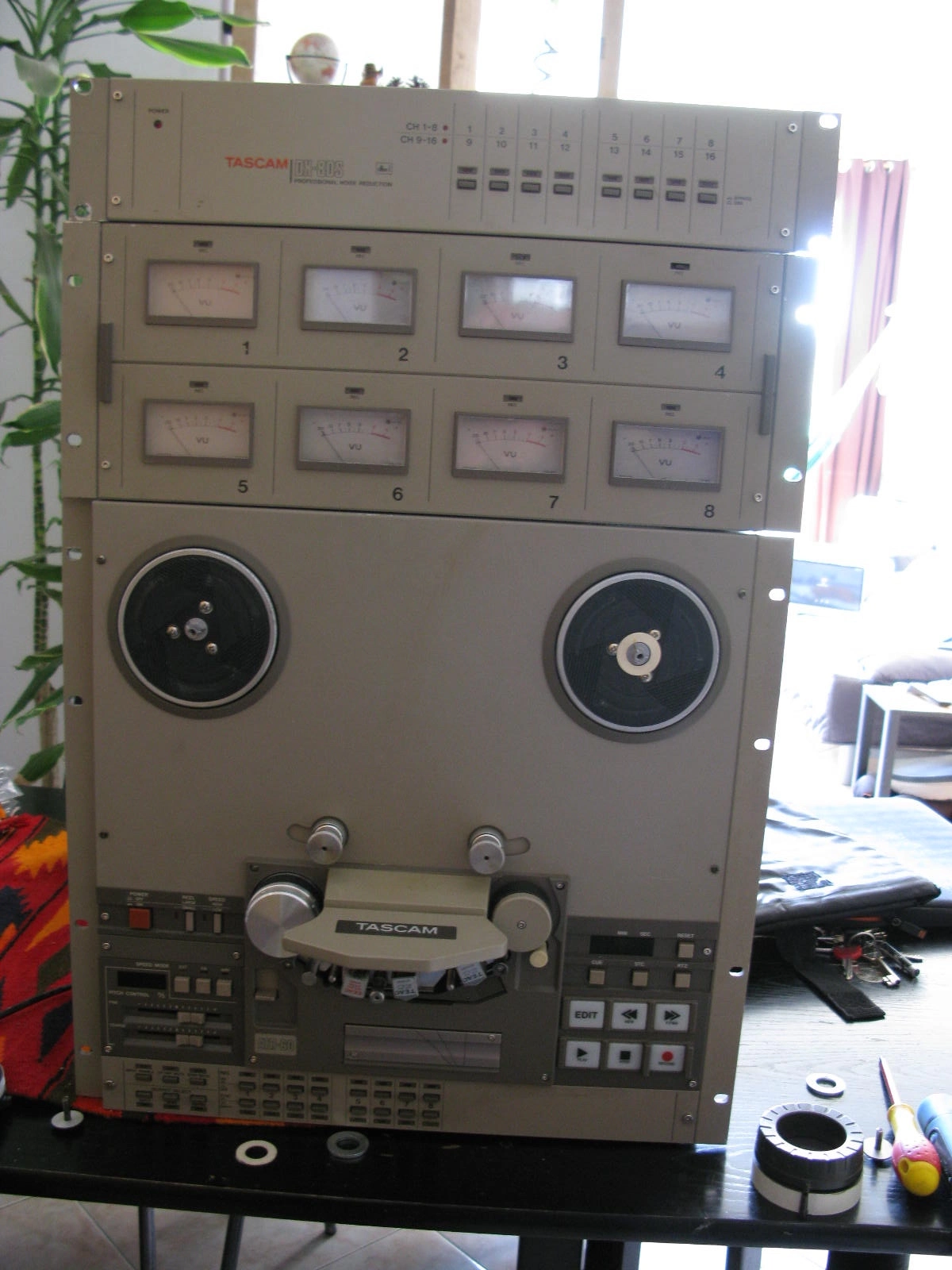

SO NOW HOME. I don’t have any tape yet, but went ahead and turned everything on again. And I have some questions, maybe someone can help me with:
1. The capstan is always moving, is this normal?
2. I raised the lifters and tried the transport and everything seems to be running smooth!!! How come? could this have something to do with the NAB adapters that didn’t hold the tapes properly? I don’t know what happened but whenI tested it everything went crazy and now without tape everything works OK.
3. The rec buttons still don’t work!!!? I’m pretty sure I’m doing something wrong. Is there something I should check for? something not connected? Every vomiter registers audio when trying it out but just can’t get the tracks armed.

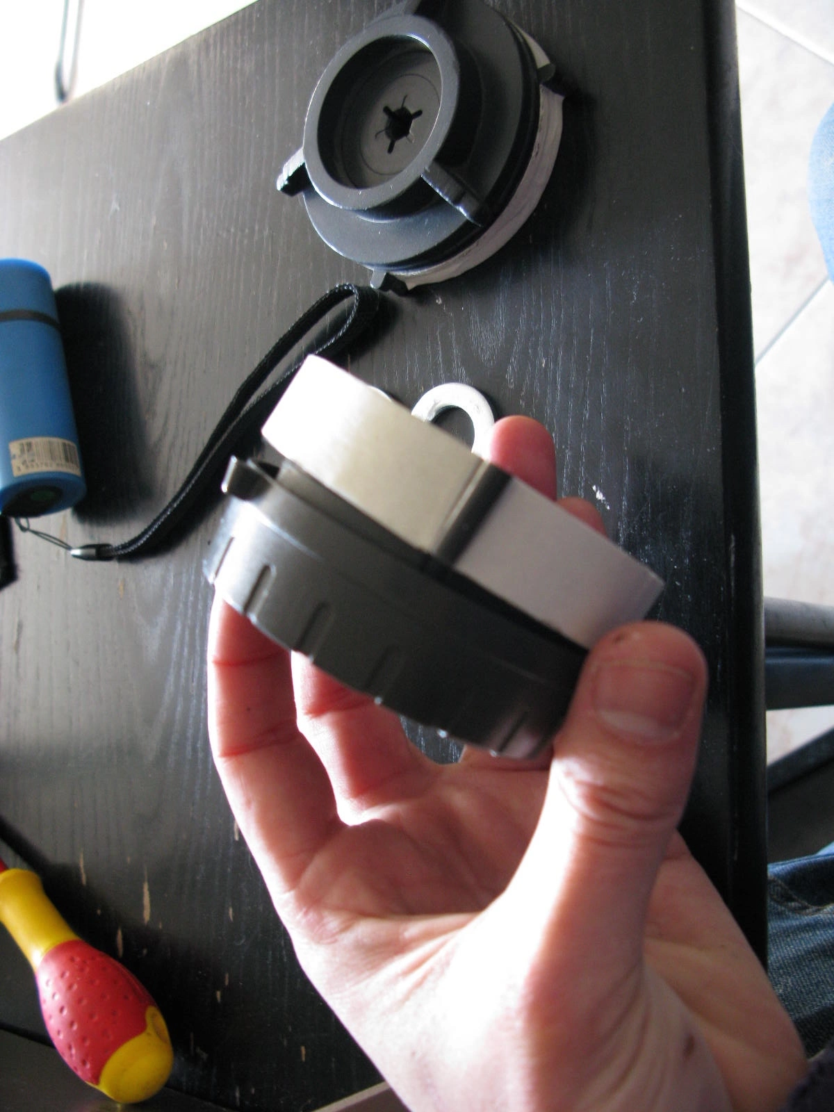

Be careful if you remove the tach wheel. There is a thin fragile fan thing on the back of it that triggers the foto sensor. You have to remove the 2 screws that hold the foto sensor and move it out of the way. Then use a 1.5mm allen wrench and remove the cap on the tach wheel. A phillips head screw holds the wheel in place. The tach wheel controls speed and direction. The 30-60 series machines were wave soldered. Its possible some of the solder joints have gone bad.

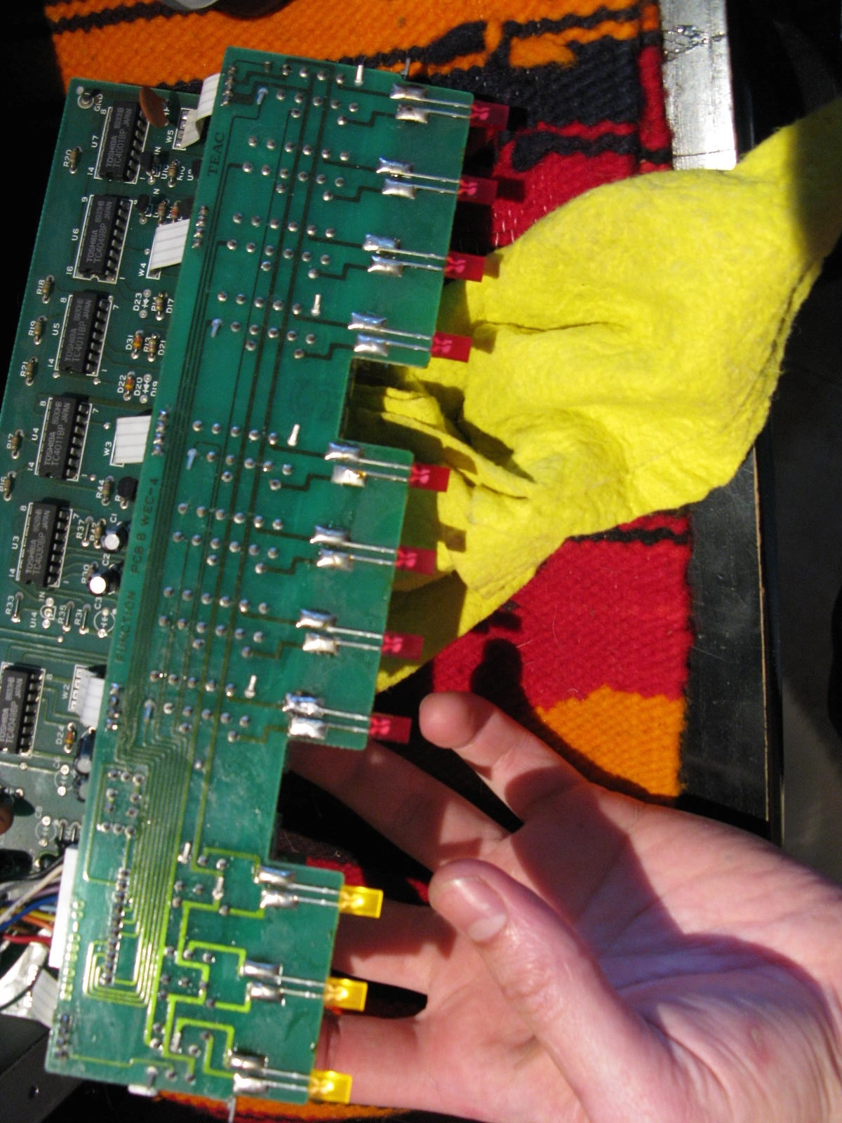

I did get to see though that the REC switches DO work, because when getting the machine on rec mode the lights on the Vumeter module DO work perfectly, so the switches seem to be working!!
So I thought maybe the lights where bad, so I went ahead and changed one light with another I know works but this only proved that the light bul is working, so lights are not the problem.
So I know the switches work, but the lights don't turn ON ont he rec module!!
any ideas?
Already have tape on the way to try it out, but I can't get why this lights don't turnON!!! all solder pints look good on the PCB for the switches, so how come it sends signal to the lights on the VUMETERS but doesn't send signal to its own light??

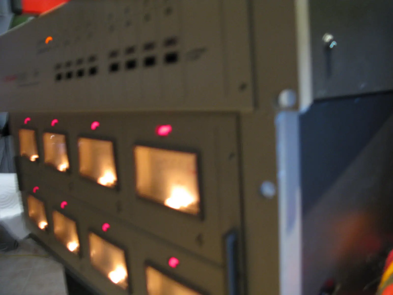

No I haven't checked that, what confuses me is that the entire PCB board has lights and all seem to be working fine. The bulb only goes to the switch and then I could only traced down the entire switch's path. But if some bulbs on the board work fine doesn't it mean that the path up until the board from the power supply is fine?
Here's a picture of the board and the lights working on the vumeter module when the deck is set to recordIMG_4220.webpIMG_4219.webp
