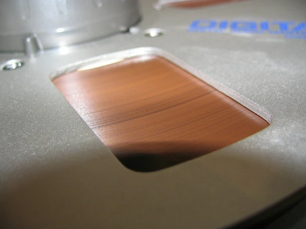

Cory,
Nice pack. And yep you're doing it right, ie: aways put the new reel on the takeup side, rewind to wherever the work is and FFW when done. That way the tape will forever be tails out.

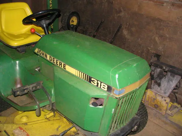

I have been taking a break to work on "Bessie"...
She's working again...thank goodness...the grass was getting tall. :eek::rolleyes:

Please, if able, check out the video...
In the latest post in my Tentelometer thread.
I'm still having problems getting the tensions right on my 58. The video shows my measuring technique. Wondering if anything looks wacky with it.
My measurements are:
PLAY
supply side 60g (should be 75-85g)
takeup side 80g (A-OK)
FFWD
supply side 60g (A-OK)
takeup side 140-160g (should be 180-200g)
REW
supply side 30g (should be 60g)
takeup side 80-100g (should be 180-200g)
The spring on the supply side tension arm is absolutely maxed and I'm still not getting the minimum playback tension.
Now here's a thought: could it be related to the reel motor? I replaced the reel motor on the supply side. It runs really quiet and smooth but I thought it would be a good idea to put in a connector in case I need to take the motor out in the future rather than have to desolder it from the PCB. Is that a bad idea? Could that effect the ability of the motor to muster the appropriate operating tension?? :confused:
Tape pack looks great after a FWD SPOOL.
