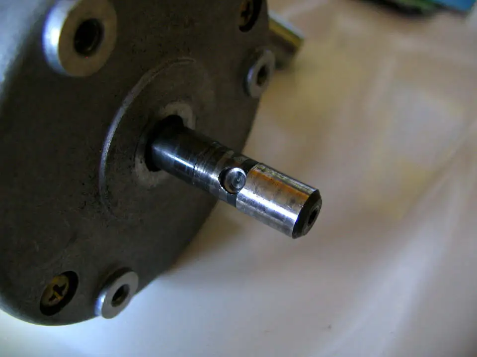

Opened up that motor out of the parts 48...
I was surprised to find that the motor I pulled from my parts 48 last night actually looks somewhat high-mileage. :( But it ran really smooth, and the wear inside looks vastly different from the yucky supply motor I pulled out of the 58. Fine dust from brush wear rather than bits and pieces and scoring. So anyway, the bearings are in good shape, and there's life left in the brushes...I cleaned it up as good as I could.
Took this picture to show the difference between clean commutator sections and the dirty ones pictures a few posts ago.
Prior to cleaning this motor there was some buildup in between the commutator sections, but nothing like the motor I pulled out of the 58. To clean it I used an air duster, toothbrush, and a little iso alcohol on a swab to wipe the faces of the sections when I was done. Took 60 seconds. You can see the trough being worn on the commutator by the brushes. I'm assuming this is normal, and this motor looks to have many miles left in it. The questions is whether or not it will perform differently in the 58 than the one I pulled.
To be continued...

So I got the motor back in...I don't remember it being that noisy in the 48...it is a sad sounding motor...I think maybe one of the bearings is actually going bad, but I'd cleaned it, it was soldered in so I figured I may as well test it out.
Got it installed, loaded tape and ran some basic tension adjustments/tests and y'know what? Its better! ;) Not up to spec, but better.
