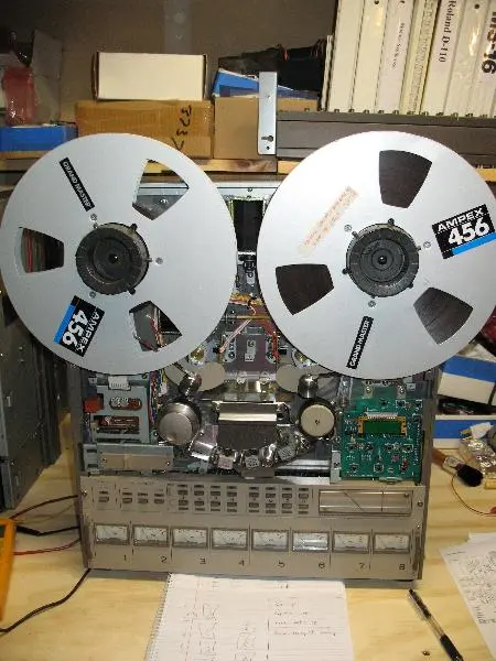

As you may know I picked up Sweetbeats Tascam 58. It has a few problems but much potential.
I've been a bit crowded in the garage<<<< er, Studio with too many decks and not enough space. I need to finish off a Pininfirinna Spider Europa project and a few others as well. But to make things go better I built a 32" x 8' workbench. This will allow space for the 58, the DX4 recap/calibrate and the 32 and atr100 and Hardy M1 DIY and GR mp2 and , and , and.
Anyway, I did get the bench up and have the 58 there. I was able to get the power supply working. I had to dig around for a while to find a 7805 regulator in a parts box along with a 7815 and some transistors. I was able to scavenge some parts off the parts 58 that made it all work. There was a problem with the +|5 v logic supply that was traced to a faulty replacement 7805...
I'll post some photos as things get more interesting.
The take home message here is that I pulled the fuses that supplied the power supply board and then brought up each rail individually. Fixing the rails as I went. So pull the fuses, select a rail or pair of rails to work on (I started with the +5 logic rail) and unsolder the wires taking the rail to the deck. That isolates the supply rail until you have it working.
Once a rail is up and clean resolder the PS to deck supply wires and power up listening for "something bad".
The end results is a working PS and no smoke. The controls do not work yet. If you hit play it starts the take up reel moving backwards and then stops. But this is progress.

I got a bit more time into the deck. Lots of things were fixed and I'll only post about the more interesting ones. All in all about 15 parts were replaced so far.
First the PS was brought up rail by rail. Then each subsystem was connected. Then the capstan motor control was fixed. Then the reel motors were tested and some basic servo alighment was done.
I was really puzzled with the take up reel. All was wired correctly and things were just not working as expected. Then on the threshold of a dream last night I realized that the motor was running backwards. I studied the schematic and nothing would allow this as designed. I checked the wiring again and all was well there. This leaves a few possibilities but being a PM DC motor and being a pragmatic person I just reversed the leads to the motor.... The end results is shown in this 8 MB video http://studio.arafel.org/tascam-58/Tascam-58-transport-test.wmv
No audio cards yet, no servo calibration, tape rubs across the reels and who knows what else. But this is progress.

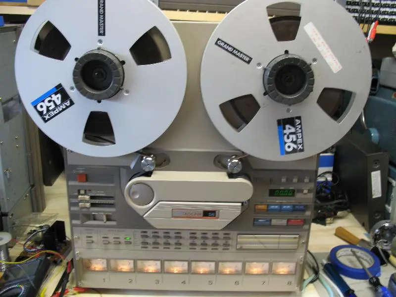

Channel 8 was kinda messed up for playback so I was able to do some work on the channel card and then I was able to calibrate it to a 250 nWb/m tape. Both sync and repro caled up +-2 dB except at 32 Hz which is normal. Just a quick cal.
Moving over to a record cal I found that - it did not record. All the record LED armed and enabled as one would expect. But it remained in playback which is actually good news. This indicates that part of the cmos logic on the control board is toast. Might not be too hard to locate.
So the plan is to get record working then do some upgrades on it. Bias cap upgrade so that it can bias GP9 and 499 and ATR. Replace the relays on the channel cards. Upgrade the opamps to something like the LME49860 and a few select EQ caps.
Then calibrate it for +6 and bias to one of those tapes. Might be nice to mod the master bias so that one could switch between different bias levels.

I got some time to work on this deck again today. It now records but has not been calibrated yet.
All channels did not record but did playback. I poked around looking for logic errors that would mis trigger the relays and such. It all looked good. Scratching my head a bit it dawned on me that to record you need the bias signal.
With the scope I was able to prove that there was no bias. Off to the master osc board and no signal there. Quickly swapping in a spare the problem remains.
So, pull all the channel cards and power up and the Master Osc is working.
One or more channel cards is pulling the master osc down.
It turns out that channel 8's card is the reason. Of course given that this was the card that was mis-inserted. Another oddity is that the master osc was running at 125 kHz and should have been 145 kHz. A quick adjustment and the osc is on freq.
To make the long story short I farted around with channel 8 card for a bit then just swapped in a spare that I had. I needed to install a few caps that were not in my spare.
Right now all channels playback and record. I think that tomorrow I'll swap in the bias coupling cap mod and do a full calibration and see what we have here.
The mod will allow biasing a +9 tape. The deck is normally biased +6. I'll stay at +6 for now but who knows.

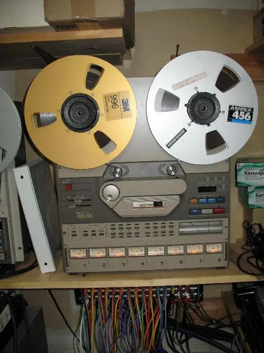

Well now - Just finished up calibrating this deck. I think we can declare victory. Calibrated to +6/185, Biased to 499. Records +-3 dB from 40 Hz to 24 kHz. (those are the -3 dB points) -4 dB at 35 Hz. 2 dB headbump at about 150 Hz.
The only remaining problem is that some of the relays appear dirty (ch 3,5 and 6) and can read low until bumped. I had planned on replacing the relays anyway.
I used a 220 pF Wima cap for the bias feed. This is actually too much as that with the 220 it just can adjust the bias low enough to find the peak with 499/GP9/996. THis means that it will not find the peak with 456 so you would have to overbias by ear.
The stock feed cap is 100 pF - So when I replace the relays I'll put a 180 pF in there and rebias.

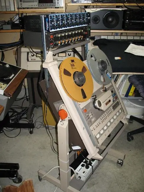

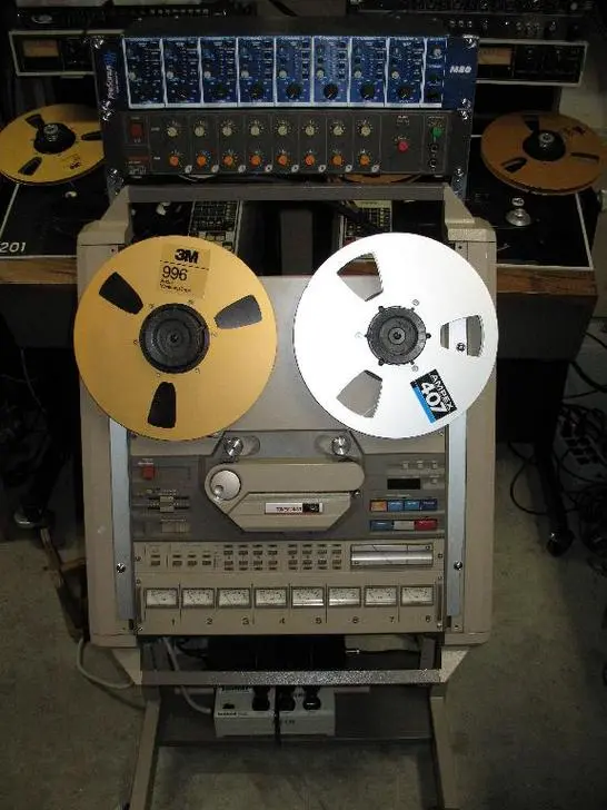

THe 58 is in the roll around rack and I thought I needed a little more to go with it. So I cut up some rack mout rails that I had lying around and drilled and tapped some mounting holes in the roll around. Thus I have 6U or more rack space about the deck.
I've put a Presonus M80 8 channel preamp (Jensen, OPA627) and a Tascam M1B. This lets you record up to 8 tracks and monitor on headphones.
Regards, Ethan

Truly good to see progress on this, Ethan.
I've seen a riser kit for the rack I have my BR-20T in...wish I could still get one. I think it adds 8U above similar to what you have done there.
Any subjective or objective audio tests with this mobile unit?

This riser is adjustable. Currently set for 6U but could go to 8U or 9U.
The 58 is an outstanding deck. I really fell for it once I got I got it going. My 38 will be sold as well as my MS-16. The 58 will cover all my tracking needs. I'm mostly a 2 track direct stereo recordist anyway. And the MS-16 takes up too much space.
I've not got any "real" tracking done on it yet. I'm setting it up for a remote recording session with a guitar player I know who wants to play all the parts as well as sing along. This is where the M1B comes in.
