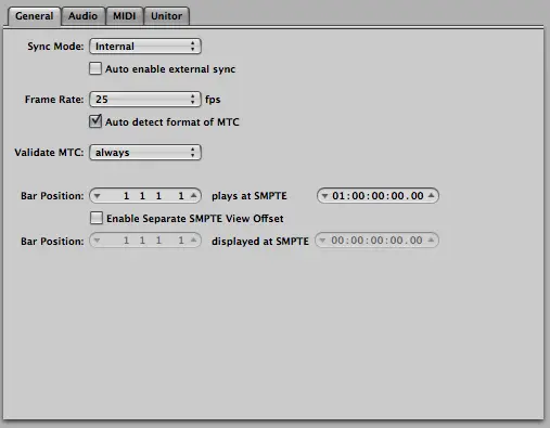

Okay see I get these different options and I don't understand what any of them do... an explanation would be appreciated here.

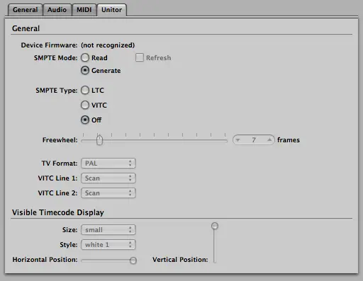

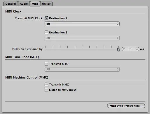

Don't do anything with the MIDI tab. Everything is fine there I think. that's is for syncing to MTC and generating MTC and MMC (MIDI Machine Code).
The Unitor tab...leave the mode on "generate" for now...set SMPTE type to LTC.

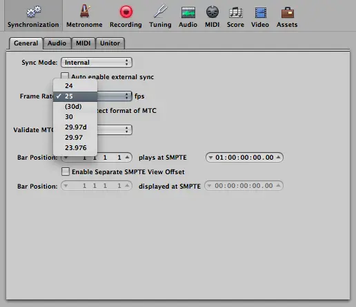

On the "General" tab:
  • What options are available on the "Sync mode" drop-down?
  • How about on the "Frame Rate" drop-down? You actually can leave that at 25fps (frames per second), but 30 drop-frame is more standard (29.97fps), but not really critical unless you are planning on taking your tapes to another location and syncing with another device...

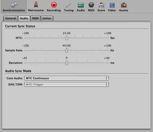

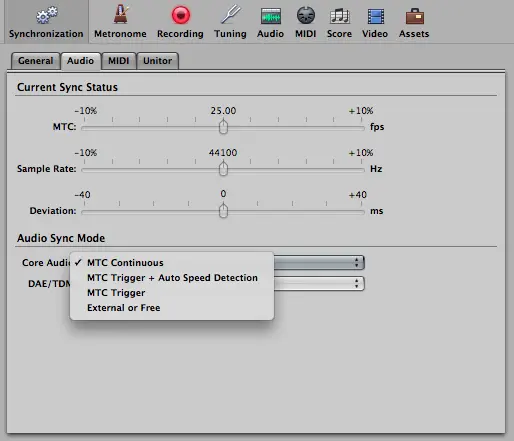

What is on the "Audio" tab?
Here are more pictures of the options....

Thanks, Maddogg. Here's another picture of the Audio tab.
