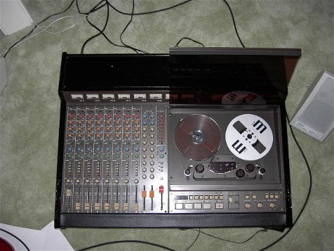

herm i just tried what you told me and it didnt work...all i get is dead air. i wasnt putting it on rmx...so i figured that would be the problem but still no results. once i get my hands on the camera ill post a picture just so if anything is immediately and visibly wrong you or someone else could point it out..thanks for your help anyway
btw: i was using a line in (and compensated accordingly) instead of a mic. im low on mic cables at the moment. i did get readings on the track one VU meter as well as the stereo VU meter when recording. but none on either during attempted playback. i wonder what im doing wrong?
here are the pictures
these are the pictures of the 388...tell me if anything looks fishy
From your pictures, it appears that you have threaded it properly.
When recording, you must arm the track or tracks you wish to record on and properly assign them through the mixer channel routing system.
When recording, you must press the play and record buttons together. If you've done that much right, you should see solid red record lights on the track or tracks you are recording onto.
Through your monitoring system, you must have a cue mix set up so you can hear whats on tape for playback.
Did the previous owner indicate any issues with the machine?
