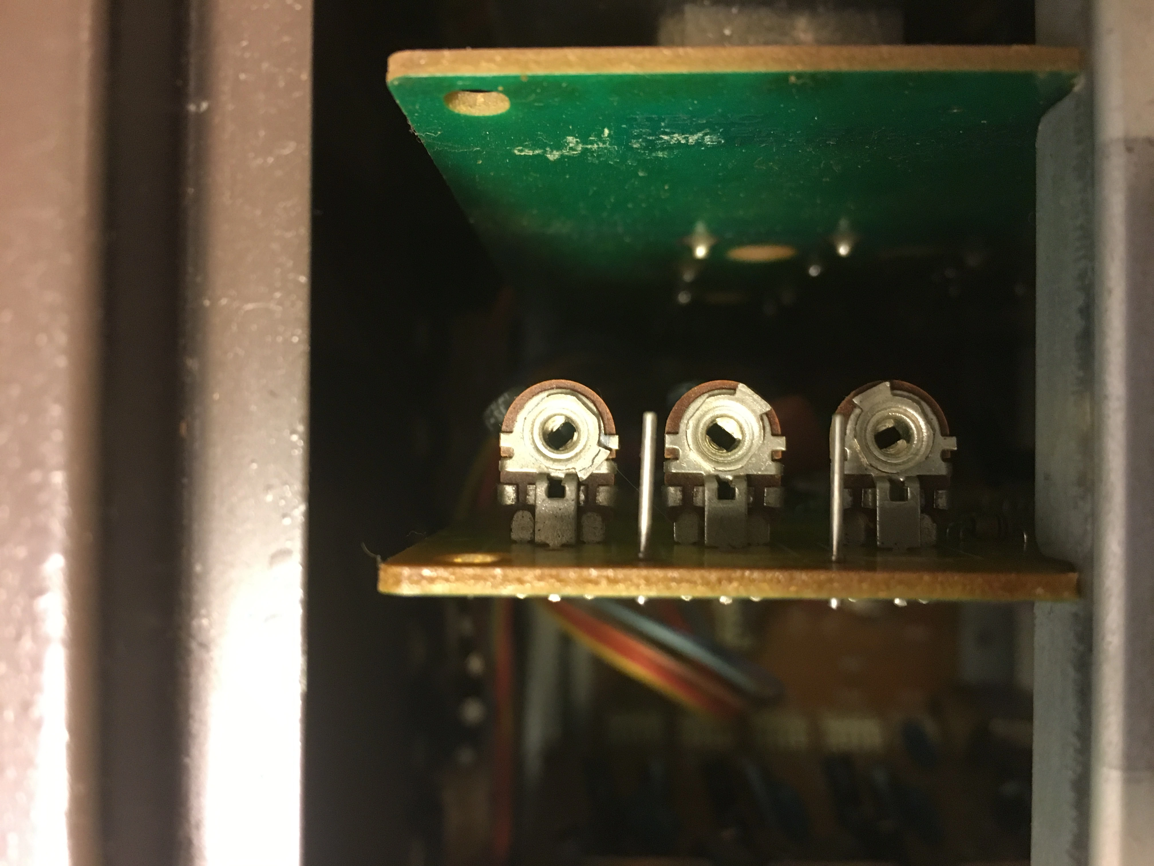

I finally had a chance to try the trim pot again tonight. I noticed something this time that I didn't notice the first time. The top of the trim pot has a a ring with a little tab on it. There is a little metal piece that prevents this tab from moving fully. In the picture below the trim pot on the left is for the right tension arm. It is turned as for clockwise as it will go because that metal tab is being obstructed. Does that mean that this can't be adjusted any further? Seems kind of strange. It's pretty much in place now, but I think it would be better if it was just a hair higher.

I’m wondering if the trim pots normally only need to be turned a little normally? Mine has gone fully clockwise and still the tension arm is not high enough.

I would definitely recap something one board at a time. That way, if you mess up and it pops a fuse, you know which card has caused the problem (i.e. the last one). You'll most likely have to adjust the tape tension a bit regardless.
Why don’t you start by just swapping in the spare reel servo card?
You won’t harm anything by swapping in a single card per se, recapped or not.
I suspect your problem is not related to a failed electrolytic cap though...could easily be wrong about that. But you should be able to achieve proper tension within the sweep of the trimmers. The thing is, you are not actually setting tensions with the trimmers that adjust the tension arm position. That’s only part of the procedure. You need a tentelometer to properly set the tension and then adjust the positions of the tension arms and who knows where your tensions are at until you do that. So there could be component failure, or you just need to do the full tension set procedure. Swapping in the spare reel servo board will tell you...something. And like I said there’s no compelling reason to recap it first. Just try it. That’s my advice. Where I’ve run into trouble on a 388 is trying to run it *without* one of the servo system boards or components installed...the 388 is kind of hairy to sort out problems like this because power rails go through several boards, but some here and some there and I’ve cooked something before because I took one board out and that resulted in an over-voltage elsewhere...I’m talking about the servo system boards, not the r/p, dbx, meter, bias and balance amp boards to the left of the cardbay...those can be in and out piece-meal with the unit powered, but the stuff on far right...cap servo, reel servo...keep those both in when powering the unit.

Re-seat the connections to the cap servo board, and power supply...inspect the connectors and solder joints on the plugin boards, and look at the corresponding pins on the motherboard for damage, tweaks, etc.
I finally swapped the servo cards. The trimmers on my spare machine were actually maxed out (fully clockwise) when I pulled it. I plugged it in as is, and the tension arms were actually worse. The left was close to accurate but the right was barely lifting and wobbly. Seems like even if there is an issue with the card/cards, there is probably a greater tension issue going on. The problem is, I don't have a tenelometer and can't really afford one at the moment. They are just too much new. Is there any other way to check and properly adjust the tension without one?
