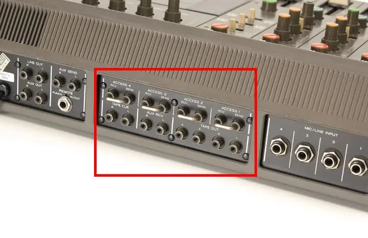

Yes, I used the out of the PC and ran an RCA into the back of the Tascam. Which input should I use on the tascam? I don't see a "line-in" that takes RCA (they only take 1/4" cables).
Hammer, which of those would I use, the Tape Cue, the Aux, or the Access?

No, I think there's been a misunderstanding.
When running the drum tracks into the 244, you need to come in through the main 1/4" track/channel inputs (use RCA-1/4" adapters if necessary). Use 1 and 2, pan them hard left and right to keep the stereo spread of the drums.
Then when you go out of the 244 and back to the CPU, run out of the RCA line out jacks on the back of the 244.
