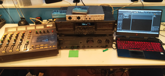

I pulled out some 30-year-old recordings the other day for nostalgia, intending to transfer them to Cakewalk files, knowing the only playback method I had was 30-year-old equipment.
And sure enough my TASCAM 244 has shat its pants. The rubber on one of the wheels has perished, there's a huge hum and the cassette seems to be stuck in play. So, I have three questions for this wonderful group.
1. Does anyone know any repairers in NSW, Australia?
2. Do all 4-track recordings (cassette) work on all other 4 tracks of different models?
3. Is there anyone willing to convert about 12 x 4-track recordings to individual digital files? I could pay if it was reasonable.
Thanks in advance.
