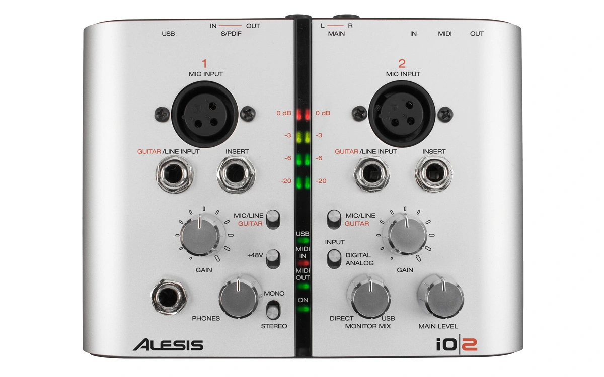

Could someone please walk me through this? I am posting a picture of the alesis IO/2 but not of the 244 because I think you guys know how to handle that one.

you are correct, there is no way to get all 4 tracks transferred to the DAW simultaneously because your interface inputs only 2 channels simultaneously.
You’ll have to dump them 2 at a time and line them up in the DAW, which can be problematic, or get a different interface with at least 4 simultaneous line input channels.
Do you know anyone with another USB AI? If so you can, I understand run two AIs together and get 4 track recording with a mac. Even the cheapo Behringer UCA 202 would do.
You can also do this with a PC and Samplitude (never tried another DAW) but the tracks will not be sync'ed, does not matter for short, say 5mins of track.
Yeah, you need four inputs. I have a 244 and a Focusrite 18i8 and transfer all in at once. It is great. If you do two at a time the wow and flutter will result in timing/alignment problems that you can't really fix.

Thanks, I think I'll try that. So I go from the Tape Out with the RCA in the 1/4" Input from the Interface and then record into the DAW, am I correct? Is there anything I have to consider on the Interface with the settings, or with the 244? I have all the switches in safe on the 244.
With problematic you mean the sync probably? The song is about 2.30min long. I hope this won't affect too much.
Over 2:30 it shouldn't be an issue assuming your 244 is stable (as far as wow and capstan speed), but what you want to consider is the nature of your tracks. What material have you tracked? If it is 4 tracks of stuff that was tracked one at a time or no more than two tracks at once, it should be fine to transfer two at a time, but if you have 3 tracks that were recorded simultaneously, like you recorded a choir with two overhead mics and a third mic on the soloist, there will be mic bleed, and if you transfer the overheads in the first pass, and the second pass includes that soloist mic, it may not sound the same...the little variations in speed of the 244 may introduce some phase/comb filtering issues. Basically, if you are going to break up an analog multitrack project transfer into multiple smaller track counts, the material you transfer should be tracked using a simultaneously recorded track count no higher than the maximum number of tracks you can transfer.

Outside of that, set your output levels of the 244 to maximize signal strength without clipping the outputs, and set your DAW input levels at your interface with the same idea...maximize signal strength without clipping your inputs.
