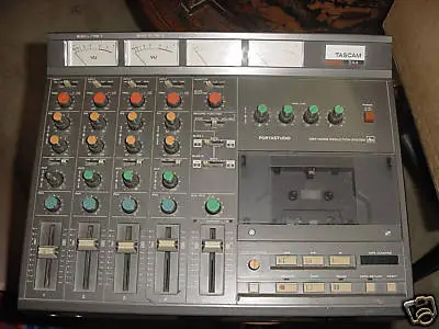

Often times you'll find condenser mics that have capability to run on an internal battery. All of my condenser mics have internal batteries,... mostly TEAC/TASCAM mics and one SHURE BG 5.0, for the record.:eek:;)
(This one's a little dirty!).:eek:;)
