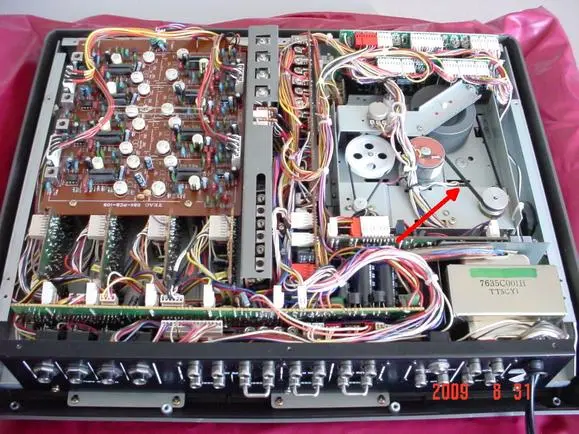

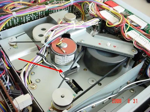

Nate,
While I don't own a 488 specifically, there are many things in common between the portastudios, including belts. You will need to carefully examine the bottom and figure out which screws to take out to open her up (the bottom part). Tell ya what.... Lets go step by step. If you can, post a photo of the bottom of the unit (not opened yet) and we'll figure out which screws to take out. Next would be to take a photo of the bottom cover off. We'll then look inside and figure out the next step. The belt should be pretty obvious when you open er up. It should look something like this (see attached - arrow pointing to capstan belt). Heck, if you can just unscrew the bottom panel (should be straight forward) and skip right into a few photos of the belt section then we'll be good.

Hey man, thank you sooooo much for the reply. My 488 is at a friends house. As soon as I get it back I'll post the pic you requested. You all are truly wonderful people. Thank you.
Nate, not a problem. Post back when you can. We'll work it out. :)
