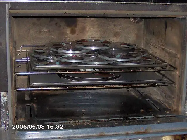

Thought I'd photo the oven arrangement. (I apologize for roommate's dirty oven. Cookie sheets are totally clean, though.)
This is 3rd baking batch, done for 32 hours. (Didn't think I'd have the patience to wait that long.) It was mainly for that lonely AGFA 369 on the bottom rack. Have 6 hours of stuff on there I very much want, and the 10 hr and 16 hr bakes didn't stop the sticky-oxide shedding.
1st batch had four 10" reels on bottom shelf, six on top. 2nd batch had same.
I couldn't waste that top rack, so arranged all my 7" reels of Ampex 456. Notice:
1. The two racks are very close together, so they are both "in the middle" and not near top or bottom.
2. The 4 slots on bottom allow for pre-heated air to come in during the short times the flames are on.
3. The 7" reels are arranged to allow air flow to all reels.
4. The cookie sheets should allow any upward-flowing new hot air to disperse around sides as it mixes with slightly less hot air already over tapes. (Of course the intake slots are already at the sides, anyway.)
I could have taken Ampex out after fewer hours, but I figured these are 2nd gen. edited copies of stuff whose originals is on 10" and whose editing I will do in digital domain later, so not terribly critical to me. So I wanted to see how the Ampex would weather the 32 hours.
And I sure hope 32 hours is long enough for that blasted AGFA!
And with all those 7" reels, one can see why I don't want to do any flipping!

Comments on the pictures:
I wouldn’t stack the tapes, but keep one layer on each shelf. Also, the trays (cookie sheets) under the reels will prevent adequate air circulation.
A convection oven is a specific forced air type. If you use a regular oven you will have to really move the air. Air flow seems to be as critical as temp and RH.
