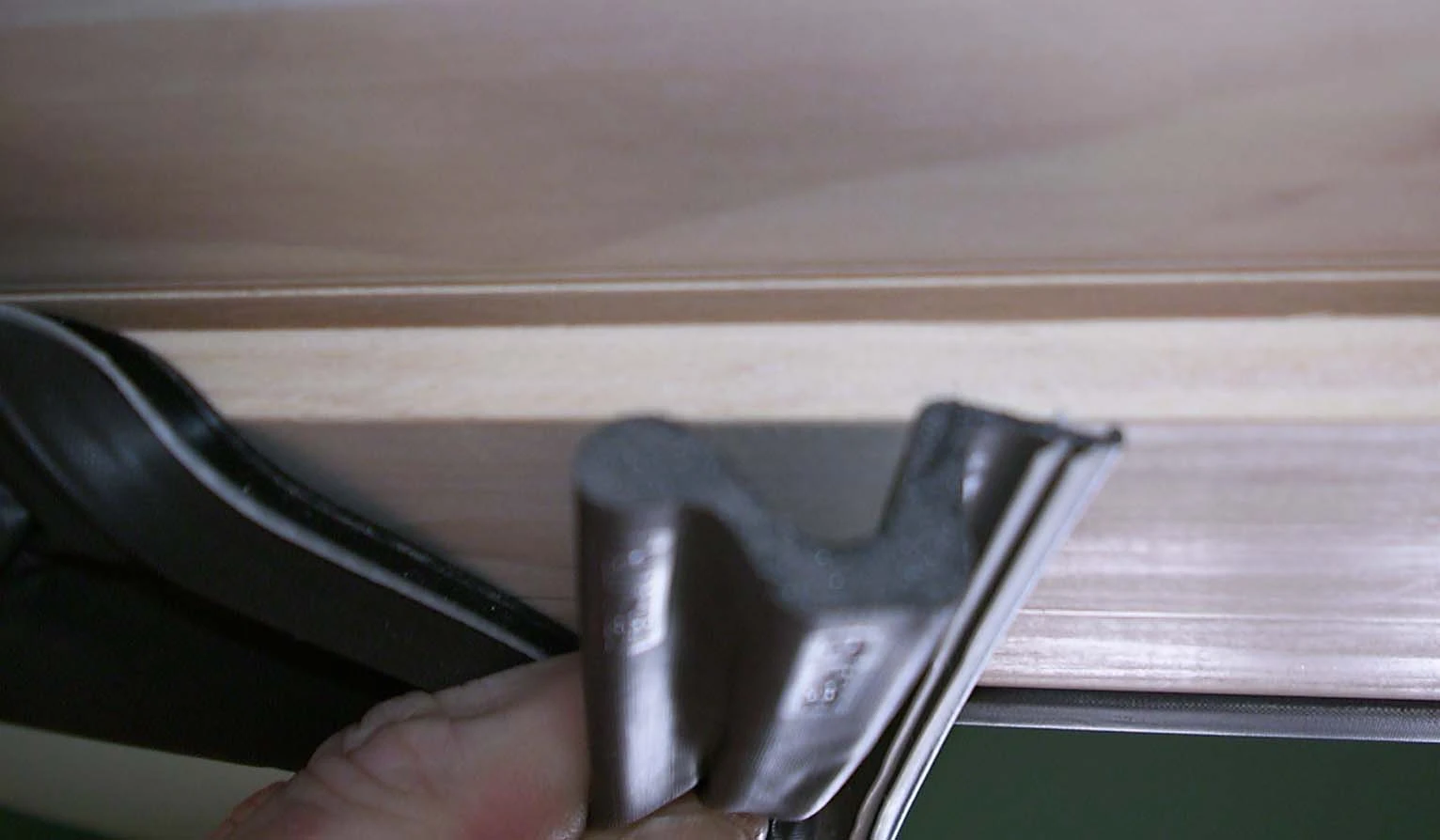

If your door trim has a weatherstriping slot around the perimter ( see photo- the slot is about a saw blade wide and 1/2" deep) perhaps you can use them. I used a multiple sweep on the bottom of the door. It has 4 sweeps in one for a good seal.
Here's the weatherstripping profile. the fins on the right grip to hold it in the slot.

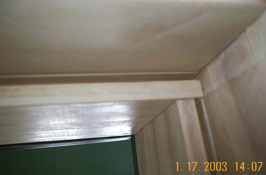

and here's a photo of the weatherstripping slot in the trim.
It's probably basic carpentry stuff, but I'd always used the stick on stuff at HD and never seen how the real stuff goes in.
