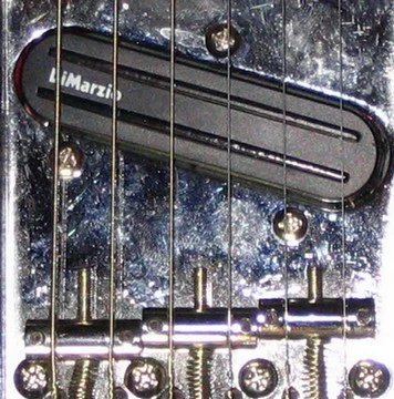

My weapon of choice in a Tele bridge position is a DiMarzio Chopper-T, a dual blade design humbucker that sounds great when stretching strings as you are never in between the pickup poles. It's a 4 conductor wiring scheme that I use a push/ pull tone pot on to switch between single coil and humbucker modes. In humbucker mode it has an output similar to an older PAF humbucker (260mV) so it has a nice rock tone but cleans up well for blues and rockabilly stuff.
I used this diagram (coil cut diagram) for wiring the coil tapping of the humbucker-its the same with a push/pull pot or a Double pole/Double throw switch. The push/pull will give a stock look without any extra holes in the control panel.
http://www.stewmac.com/freeinfo/I-DIMARZIO.html
