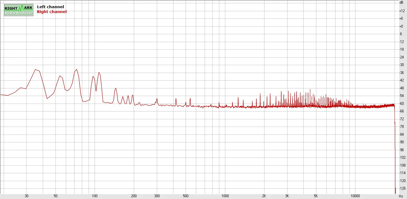

I attached a file - the volume is massively boosted, but it's pretty easily audible at normal volumes. I only get it with an instrument plugged. This is my bass with single coil pickups, both at full volume. If I turn down either of the pickups, I get the characteristic background hum of single coils, but the intermittent noise still comes through. I also tried with a guitar with humbuckers - the noise was considerably lower, but I could still hear it. I tested with three different instruments.

The noise spectrum is a wide band pulse centred at about 4kHz and thus not likely a "coherent" source like a radio station. An electric discharge "zapper" would seem favourite. It is important to know if the noise is being picked up on the guitar cable or gets into the DI anyway. Do you have a guitar pedal? If so, plug that in sans guitar and check for noise.

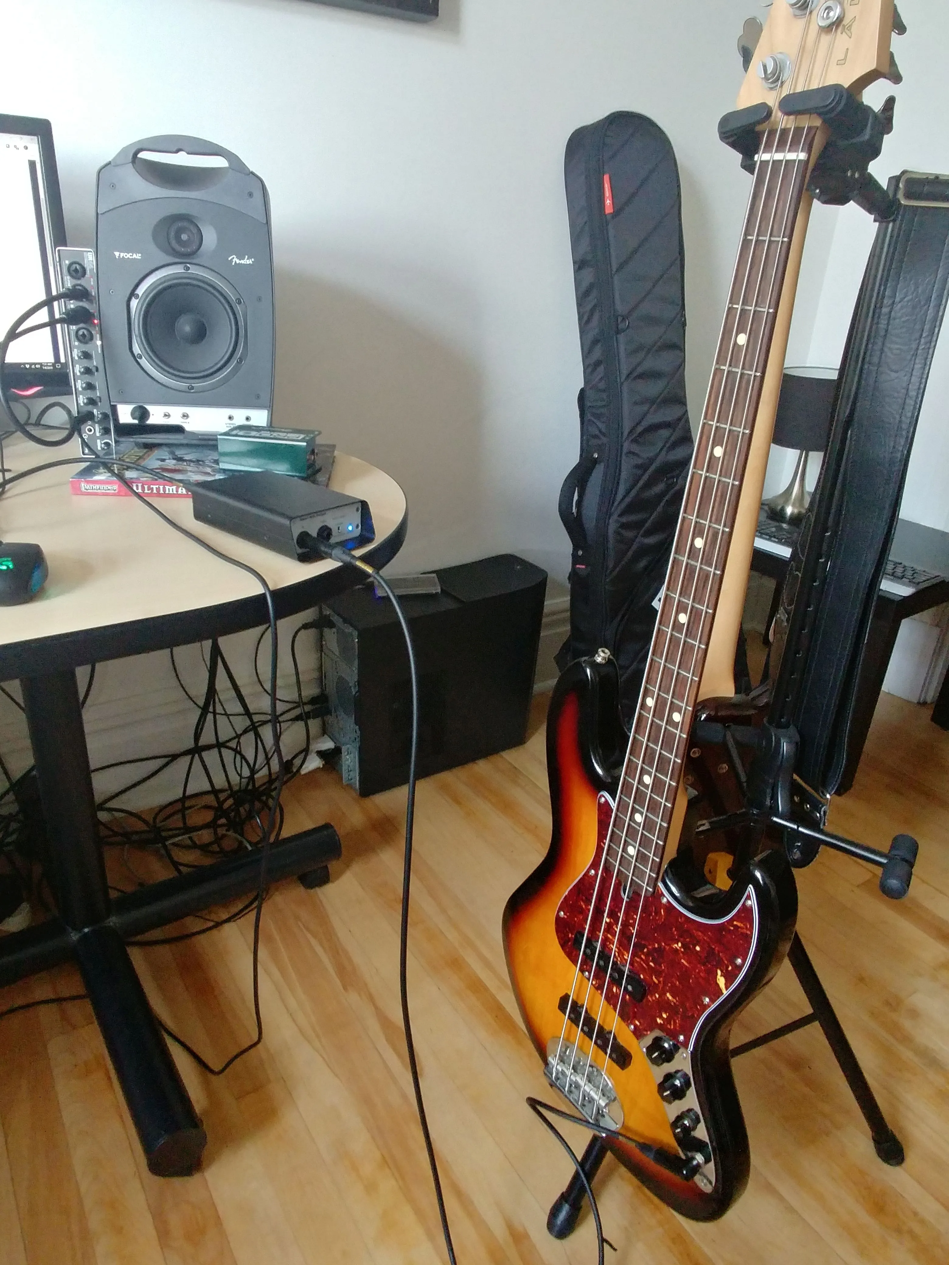

Just looking at your picture, and what little I can see of your physical setup...you've got a bit of a cable rat's nest that should be cleaned up, and you should separate the power cables from the audio cables and avoid running them all on top of each other.
The other thing I notice is your audio interface/preamp is wedged between the computer monitor and the speaker monitor. I would not have that there.
I don't know how else you have things...maybe you should post a few more pictures.
You are absolutely right about the cables at the back of my PC, and I suspected as much about the interface being placed there not being such a good idea.

Actually - I had to smile when you posted the picture of the guitar. I've got an American Standard 5 string bass and it would pick up things in some venues and be totally quiet in other places. I bought new pickups, lined all the cavities with copper foil and the noises went away. The culprit was eventually tracked down to a switch mode PSU in our stage rack, which is only 4 feet away from me in most stage setups. The Fender pickups just seemed to really hate it. in truth, maybe the foil would have done the job?
Haha! Yeah, I do get some serious noise on stage sometimes, but I just keep my hands on the instrument and roll with it.
Is that a Fender, bluesfordan? Mine is a Lakland :P The original pickguard was white, but a friend of mine made the tortoiseshell one I have on it right now. Gotta admit it looks cooler now!
