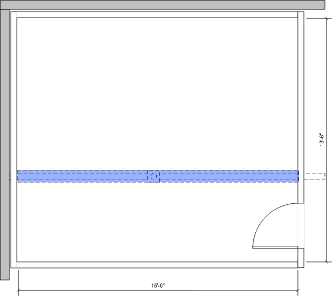

Basement Studio Help
What a great forum. I am glad I stumbled on to it. I just hope it's not too late. Here's what I have so far. It's a basement studio/practice room. I will be recording acoustic instruments with mics. Complete sound proofing would cost too much. So my primary goal is to reduce the amount of transmissinon as much as possible, focusing mainly on the ceiling. Two of the four walls boarder the existing poared concrete walls. The ceiling started at 81 inches. This immeadiately ruled out two things: a drop ceiling and a solid exterior steel door.
For the ceiling I installed 2x8 hangers between the existing joists, staggered at 2.5 ft intervals. These are pretty tight. I then installed R-19 insulation in the joist cavities. The ceiling also has resilent channel running perpendicular to the joists. The walls are 2x4 studs with R-13 insulation. Both the ceiling and walls have 5/8 inch drywall. The floor is covered with a short cut loop carpet.
So far the drywall is installed and the next step is to tape and mud. There is one beam that runs through the room. This has a soffit around it that is 8 inches wide and 8 inches from the ceiling. The post on the beam is also frammed out at 8x8 inches. All the electric will be run on surface mount conduit. This includes the lighting which will be those bulbs that have the cage around them. I plan on installing a wainscoating around the walls that will be 48 inches high. This will be 1/2 inch MDF with a poly clearcoat finish.
As I mentioned before, I'll be recording and mixing in the same room. As it stands right now the room is pretty live with just the drywall and carpet. A couch, desk and some cabinets will be the only furniture for now. Before the construction sound freely traveled from the basement to the first floor. I could actually hear our baby roll over in his crib from the basement. I am not too concerned with the walls. Our mechanicals are already walled off and should not be a huge problem when the door is installed (solid interior door). I am hoping that the ceiling will be acceptable once it's taped and mudded. What can I do if it's not?
As for treating the room what should I do? The beam soffit may cause some problems, as will the square shape of the room. Any suggestions for placement of monitoring would be great. Also any acoustical treatments (foam) and placement would be welcome also. Lastly, the room will be on it's own electrical circuit. Is it OK to have the lighting on the same circuit. It will be standard incandecesant lighting.
Thanks again.
Charlie

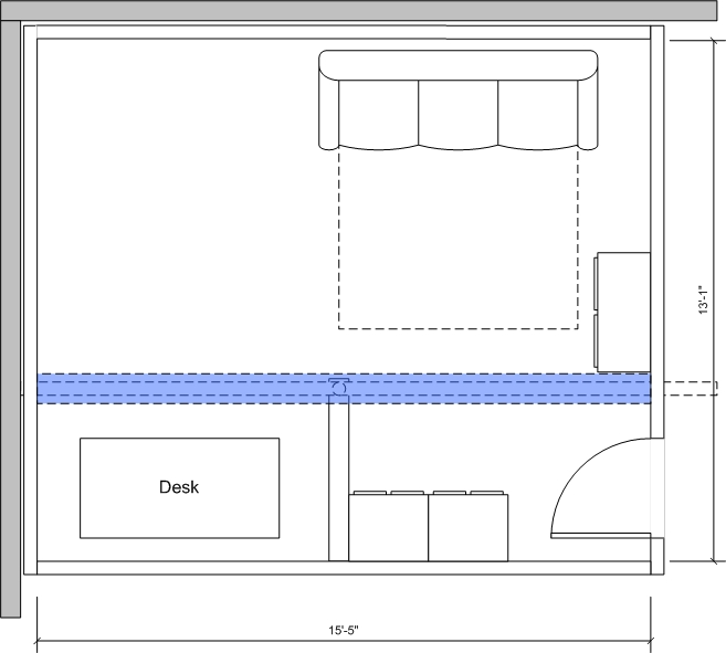

Here's an updated picture of the room. The beam and post running through the room is soffited with drywall (blue highlight). The wall running perpendicular to the beam is a half wall (36" high).
Any help would be great. John great plans on the panels. Your input would be very helpful.

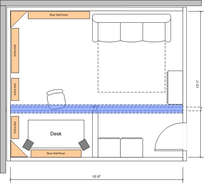

Actually I was looking at different plans that I assumed were John's. The link you posted answered most of my questions. But, I still have a few.
- How are these mounted to the wall? Can they be hung like a picture?
- Are the dimensions on the plans hard and fast, or can they be altered to suit the space?
- Are these designed to go from floor to ceiling?
- Can masonite/hardboard be used for the top&bottom of the corner units and backs of the side and rear units? That would drastically reduce the weight of these.
- Are the seams of the boxes glued and screwed to achieve an air tight fit?
- Lastly, how is the insulation suspended in the corner units?
I have attached yet another revision of the space. This time with proposed placement of the wall units. Let me know how it looks.
Thanks.
I knew a forgot a question. That blue shaded area of the picture is a beam that is soffited. Is this going to cause any problems? It hangs down 8 or 10 inches form the ceiling.
buck
OK Buck - lets go through the questions :)
The boxes must be sealed so if you have a plywood backing you can hang them, if not you must seal and screw to the wall.
The slots are set to be a broadband low- mid absorber so I wouldn't change those dimensions. The rear wall absorbers can be altered, say make them 6" or 4" deep but you loose out on the lower absorption frequency that the depth off the wall gives.
Not necessarily, but preferably. :)
yes.
yes
The aim is to fill the area with insulation so just toss it in.
As for your beam, just wrap it in insulation and cover with cloth.
cheers
john
