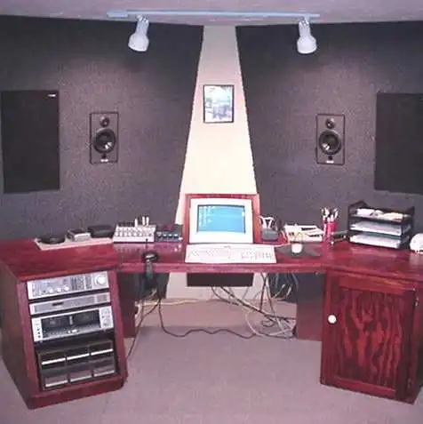

I recently finished my combination control-tracking room. I have not done any sound treating yet but plan to soon.

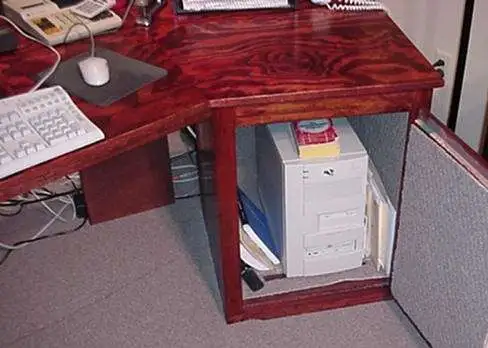

Pic #1 desk, rack on left side, super quiet case on right side. Proto-J's are 5'2" apart, same to mix position.
Pic #2 close up of case.

case closeup
Here is case

Larrye,
It's looking great..........love the soffit mounting on the near-fields.
:cool:
Man that looks sharp, and functional too. Great job.:cool:

Ok... I like it.. and it looks nice.. but aren't those near fields to high and far away.....
Other than that It's great, but that nearfield location bugs me..
Voxvendor,
Nearfields are flush mounted and 5'4" apart. They are the same distance from my ears at the mix position. The soffits are tilted down so speakers are aimed directly at my ears.
Is this OK?
Larry
Larrye,
I think that should be fine. John's abscence from here may be due to continuing phone line problems. He mentioned something about that a couple of weeks ago. Then again, if I was living where he is, I would find other things to do than come on here all the time:) :) .
:cool:
Larrye.
Nice looking space! Before you start treating the ceiling, I guess the question is: how does it sound in the room, and what acoustic problem are you hoping to cure by putting up ceiling panels? To me, It looks like you've already got quite a bit of absorbtion from the carpet on front walls and floor...

Well, the high, spacing and direction are good... But to me the whole point of having near fields is having them *near*
I would rather see them on stands just behind your desk, and then you can have the mid-fields on the wall where they are..
But remember, thats just how *I* would do it... you should do whatever you think is best for your application..
Joe
Vox,
The picture might be a little deceiving. They are mounted in soffits about 1"6" behind the desk, aprox. 5' from my ear. So if they were on stands they would be about 4' from my ear.

I have a ring or extended reverb in the 1000 to 1300 Hz area, I think. I am not real sure how to analize the room to determnine my problem for sure. John sayers looked at the drawings I posted and said I need to treat the low ceiling over my desk. My room sounds kind of hollow on soloed vocal tracks.
What's weird about the specs. is that if the facing is out toward the sound source the absorbtion of the low frequencies is much better. It looks as if the fiberglass will behave more as a broadband absorber. If I place the facing in it will absorb the high frequencies and not the low.
Any Ideas?
