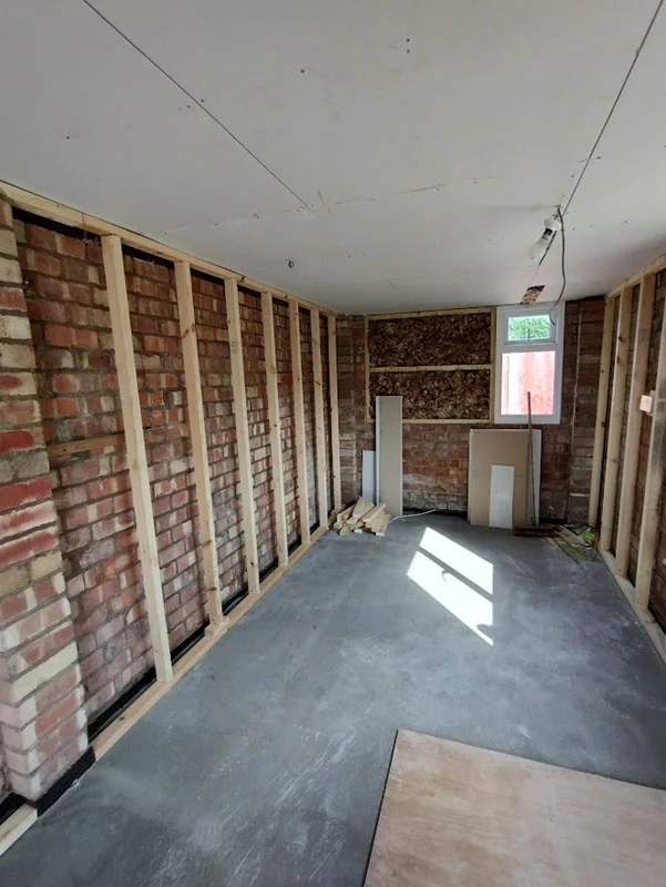

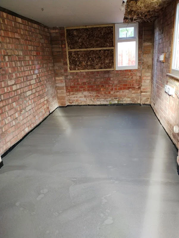

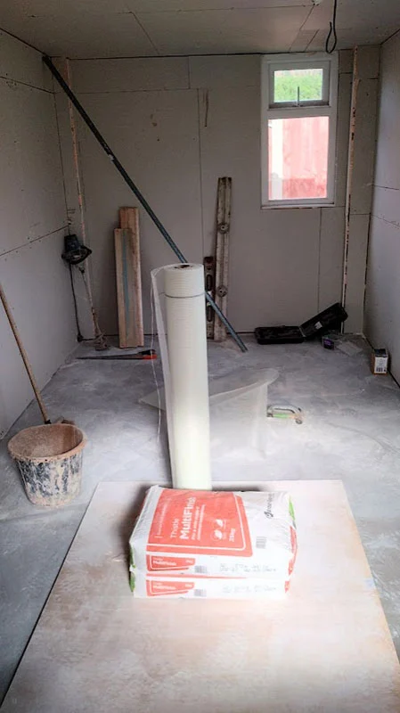

Hi I'm in the process of turning a brick built outbuilding (17'3 x 8.1) into a studio.
A new cement floor is down, a stud wall filled with rockwool and plasterboard finished on ceiling and walls.
I was automatically going to put carpet down but after looking around there seems to be a couple of sides to the argument - carpet vs hard floor.
The room will be for mixing and vocals, no other live instruments and the ceilings, walls and corners will be sound treated. Any views on this please?

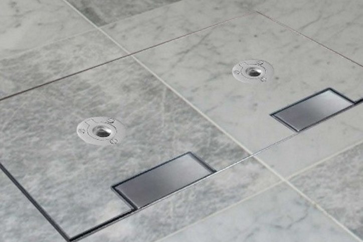

Then 19mm flooring grade chipboard but be creative! you can put cables in there and use "dips", mains and audio connectors in trays in the floor. Yes, stick carpet on top but have lift out panels for access. With a bit of planning you can have a 6+ XLR output just where the drum kit sits, a couple of XLRs and a headphone jack plus juice where the guitar/bass/kbds be. CAT 5e/6 shielded cable is a cheap way to get 4 mic lines down one 6mm cable. Put in at least twice as much cable as you think you will need...then a bit more!
"Live v dead"? With some of the flooring board cover some with carpet but seal the other side, varnish say. These can be flipped as absorbers or reflectors. Acoustic guitars often sound better if the player is seated on 4+sqr m of a hard surface. Drums often benefit from being raise a few cms.
Make some "GOBOs" vertical panels you can put around drums and amps to control sound. Get clever. Put acrylic windows in them. Put a row of power outlets and XLRs on it and an IEC socket to a dip. Wheels! ...***T! I wish I was 50 and doing this again!

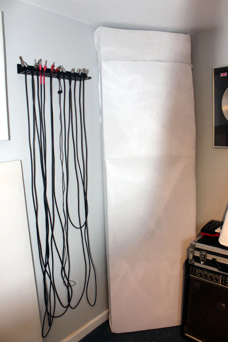

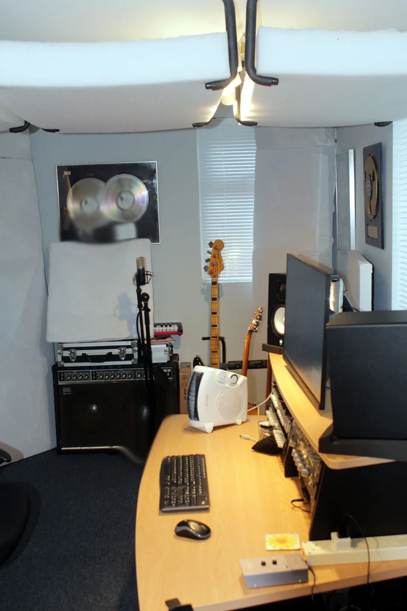

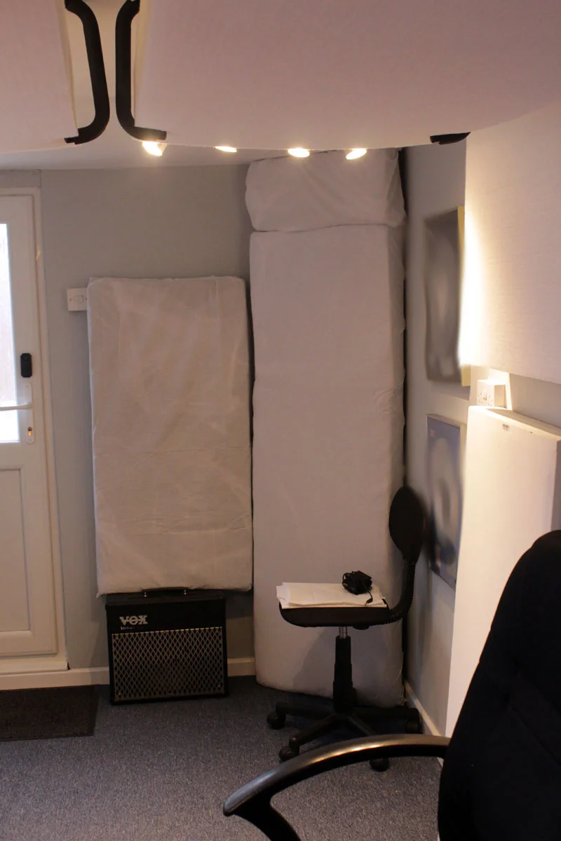

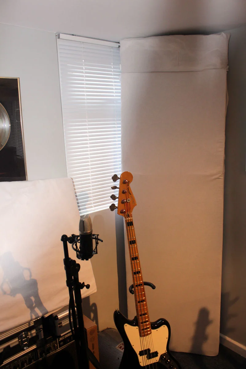

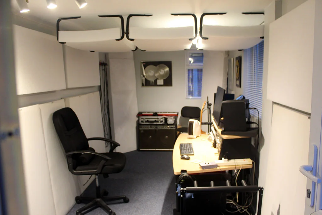

All up and running now, it's quite cosy and needed lots of treatment, I made the RW3 floor to ceiling panels and I already had a few pre made standard size ones.
On the ceiling above the listening spot is Iso bond which work very well.
I took some REW measurements if anyone can help interpret for improvement purposes.
Tbh, it sounds pretty good in there but if I can do any more before I get back on the musical treadmill I'd be grateful for the advice.
Also, there's a bunch of guitars to go in as well.
