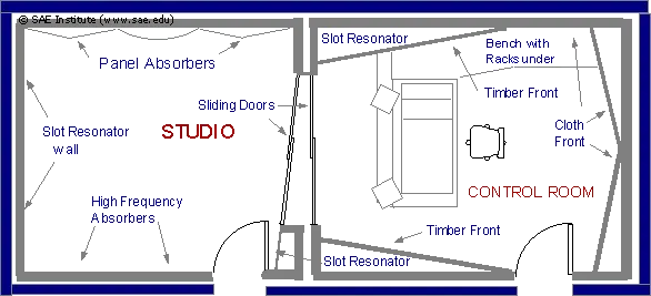

I'd make the large drum space a drum/live room, the bathroom and isolation booth and the other large space the control room
bookmark this site...
SAE Website
this, just with a bathroom vocal booth somewhere should work for you... (from the studio plans section of the above site)

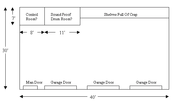

Here's what my garage looks like now:

Are you wanting to turn the space into nothing but studio, or does it need to be a garage? I mean are you wanting to build walls, add doors, sound treat and make it perminant??
Or are you looking for the best "let people come over and use it" set up.
SpaceBoy
The rooms that are build are full with insulation and they're permanent, but I still need it to be a garage. I would like it if I didn't have to build anything else. I still park my cars in there. I want it so people could play where my car is normally parked and it wouldn't sound too horrible. We've mostly been recording in basements. I doubt the garage would sound worse.
I'm sorry, I missed that part in your first post.
So sound proofing is not needed. If there are no neighbors and you don't have to "keep it down" then I would open all the garage doors and aim the guitar amps towards the openings. Use some abosoption materials behind and beside them. Otherwise make some temporary walls or gobos to use to handle all the reflection.
