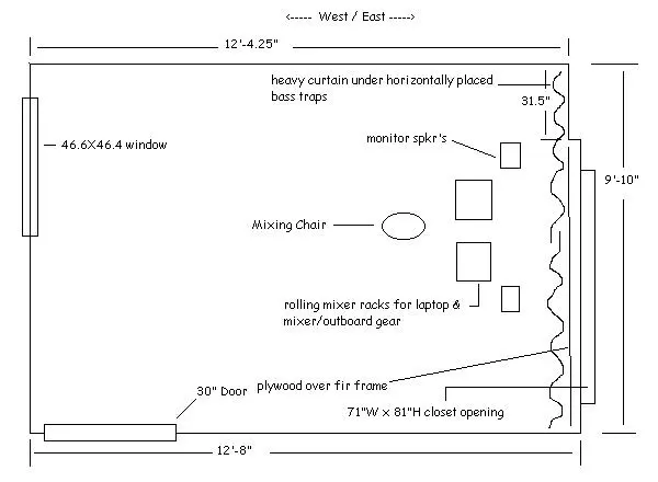

just finished painting the extra bedroom/studio space and putting up track lighting. The question I have pertains to the crude drawing I've attached (I hope). On the north and south walls next to the curtain, I plan on attaching auralex foam with bass traps horizontally above the curtain and a mirror image aray of the on the west wall. Four diffusor panels will go directly overhead of the mixing position and i'm thinking of making some moveable panels (gobo's?) for the west wall to attach more auralex foam and diffusors. the walls and ceiling are textured drywall and the floor will be engineered hardwood. I plan on using the area by the west wall for setting up drums or isolating a vocal are with gobo/foam. Any suggestions, hints, etc?
Thanks
Eric

In a room that small diffusion will just make things worse. The smaller the room, the more absorption you need. And the absorption should work down to the lowest frequencies. Curtains and foam will do very little for the severe low frequency problems present in all rooms that size.
If you've already bought the foam and diffusors, then it's too late. Otherwise, you'll do much better to buy rigid fiberglass and wrap it with fabric, or buy products based on rigid fiberglass.

So you mean that the folks at Auralex are liars when they call those items "bass traps" and they won't really work? I have standard wedge foam for the walls and foam "LERND" bass traps for the upper corners of the room. They won't work, or are they just not the best?

The Auralex foam is OK, to a point. The basic foam does work for higher frequencies, but the bass traps are only marginally effective. As Ethan mentioned in his first post, if you haven't already spent your money, you will get more bang for the buck with a rigid fiberglass product (ie. Owens Corning 703 or equivalent). By using 703 you have a product that can be configured for whatever you need. For instance, a 2'x4'x1" piece wrapped in some fabric to hide the ugly fiberglass will give you better mid and high frequency absorption than the 2" Auralex (at a much lower cost per square foot, too). Take 2 pieces sandwiched together and put them diagonally across a corner, and you create a bass trap that is many times more effective than the LENRDs (especially if you construct a sealed unit; see www.ethanwiner.com/articles.html or visit the sae website linked from www.johnlsayers.com for more info).

Ethan 'n DDev, i've just about had it with the hoops i've had to jump through to find someone that is remotely interested in selling me Owens Corning 703. O.C. says they will only sell it to professionals and the professional contractors i've talked to aren't even remotely interested in selling it to me unless they get contracted to do the install which then makes my auralex a whole bunch cheaper. Think i'll stick with the auralex for now. It'll be a big improvement from the carpeted condition the room used to be, so i'll live with it.

No. Just stack them adjacent and then leave a single air gap between the group of panels and whatever you mount them to. For wall and ceiling mounting make the air gap equal to the total thickness of the group of panels.

No, not at all. It's a matter of effectiveness. All materials absorb some amount at all frequencies. So even thin foam absorbs to some degree, and thicker foam like a LENRD does absorb at bass frequencies. The real issue is how much they absorb. For a given thickess, foam is less effective than rigid fiberglass. My company's products use rigid fiberglass - which is also fireproof - and we add other materials to further improve low frequency performance. If you visit my site (below) you can see a performance comparison of what we sell versus other popular products.
Again, if you already have LENRDs and flat foam, then just make the most of it.
