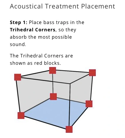

I'm not sure that the corner door completely eliminates the corner. Even a corner door may leave a small amount of wall space until you hit the door frame. And then there is the wall space above the door. Depending on the ceiling height, this could be a couple of feet. And finally, there is the corner space where the ceiling meets both walls. These Trihedral corners are fairly important and I would try to treat all four--even if it required some innovative steps.
