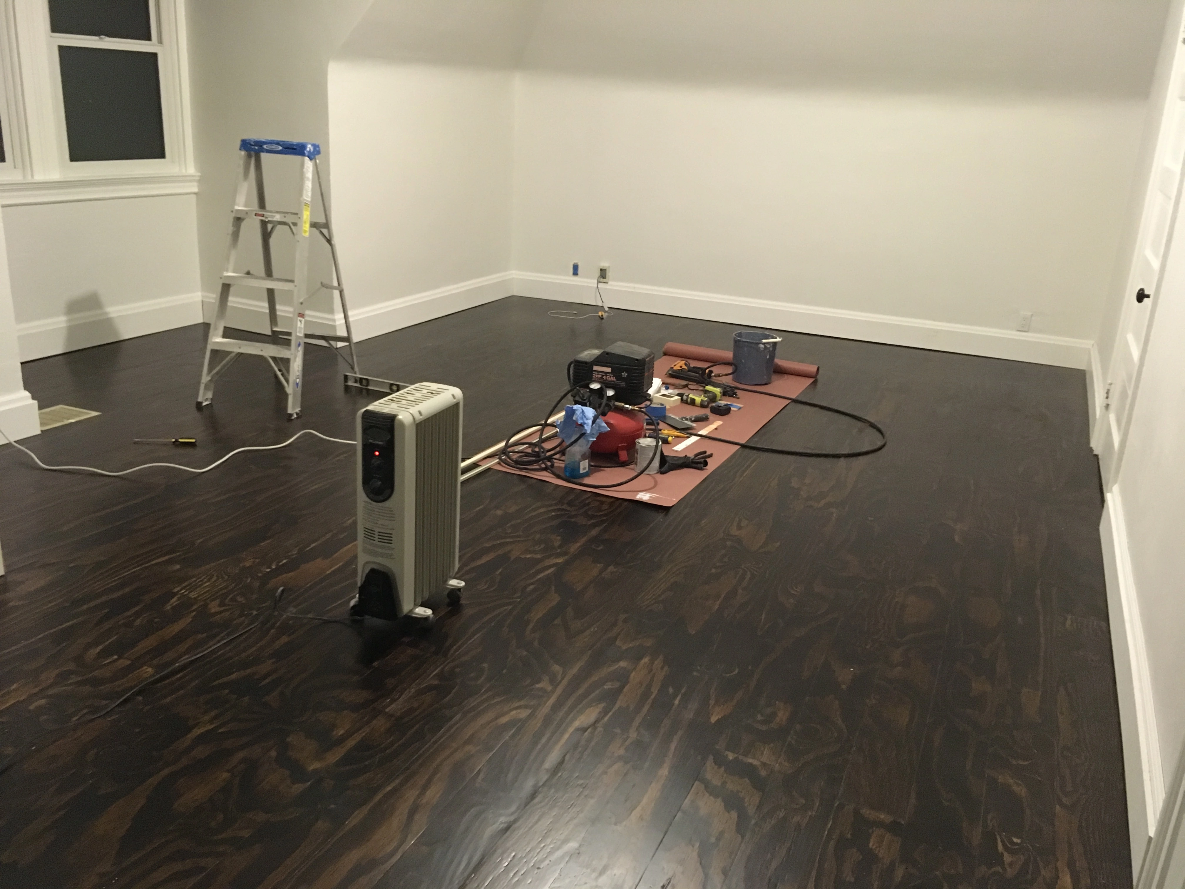

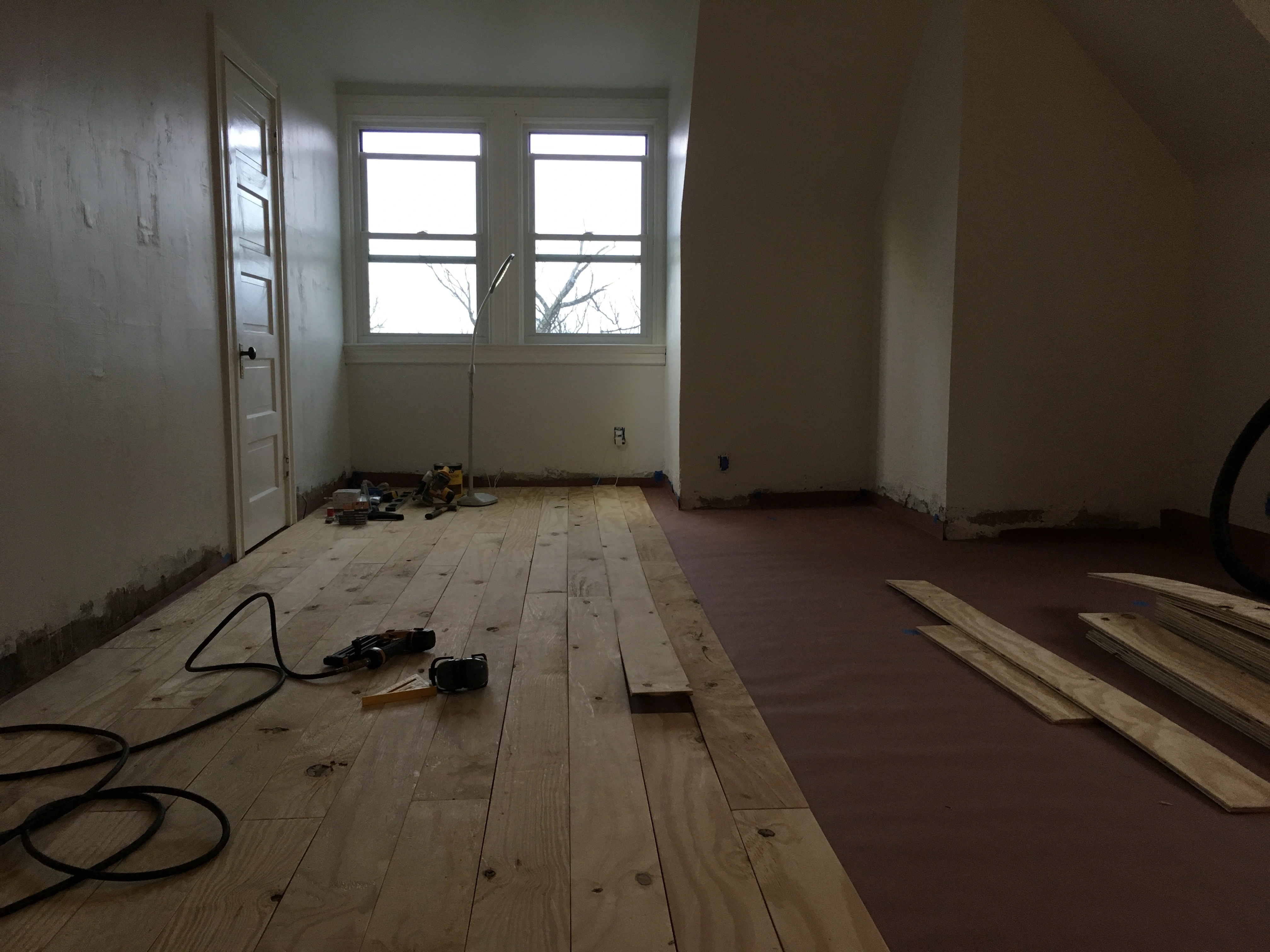

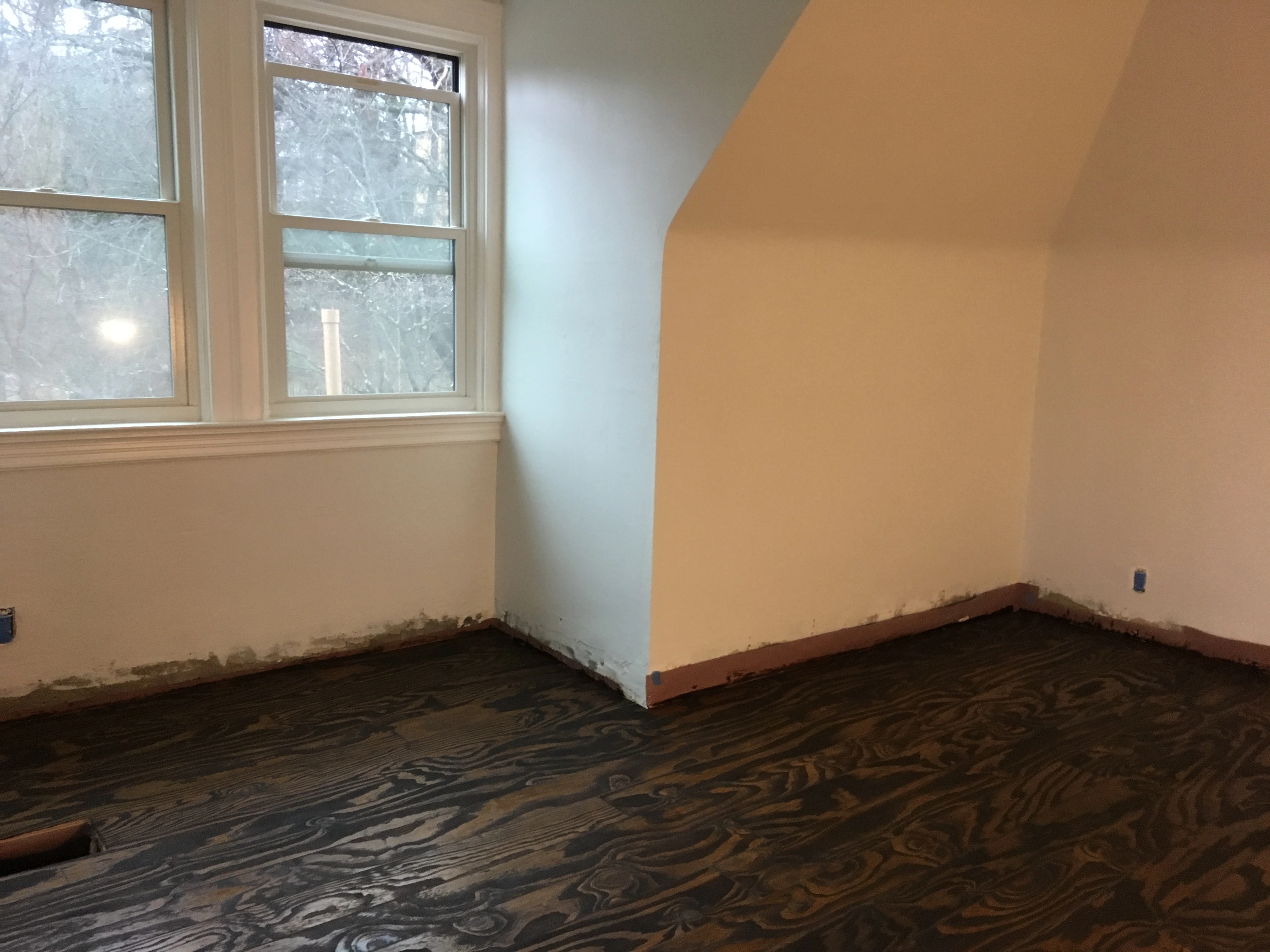

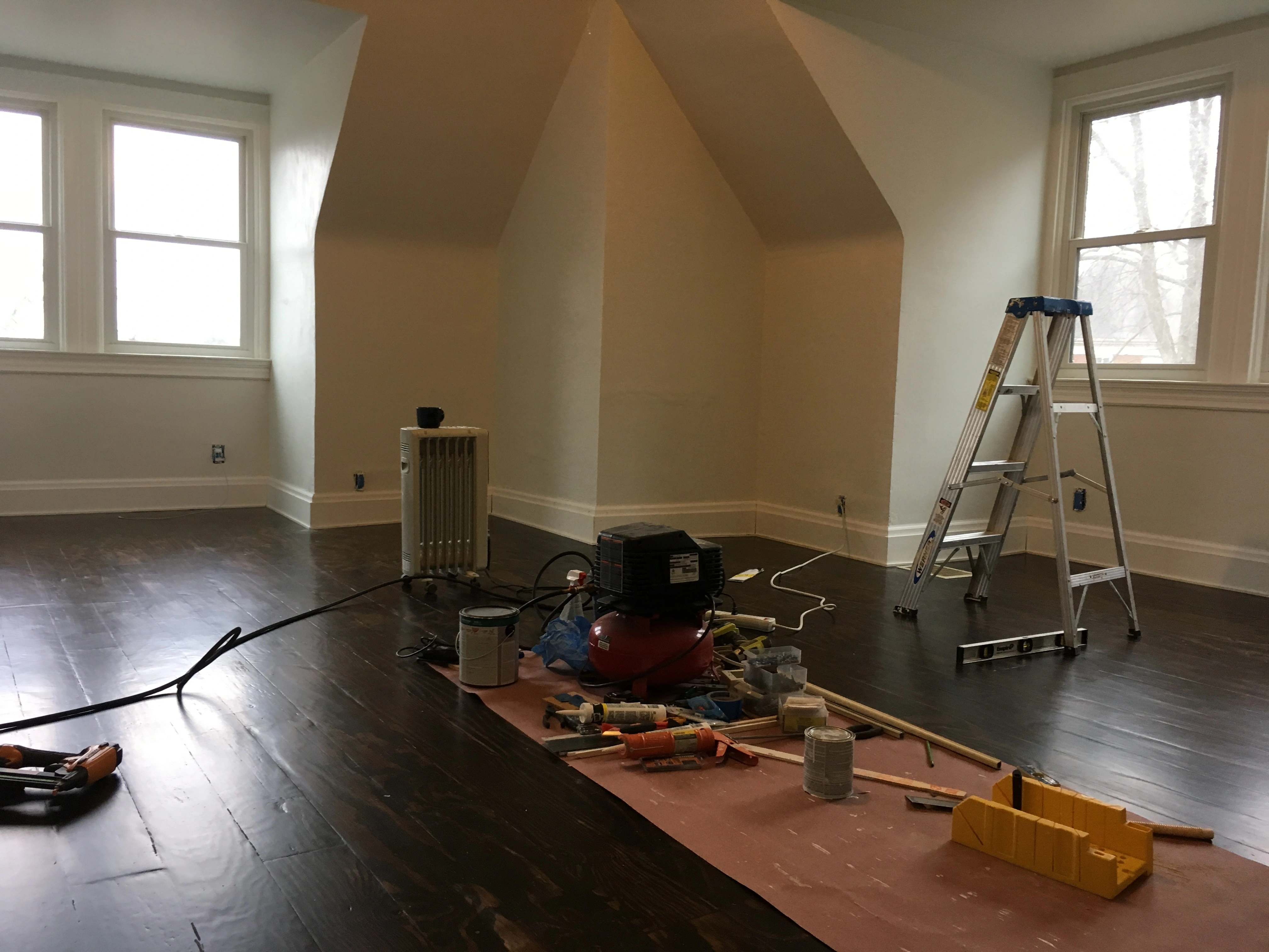

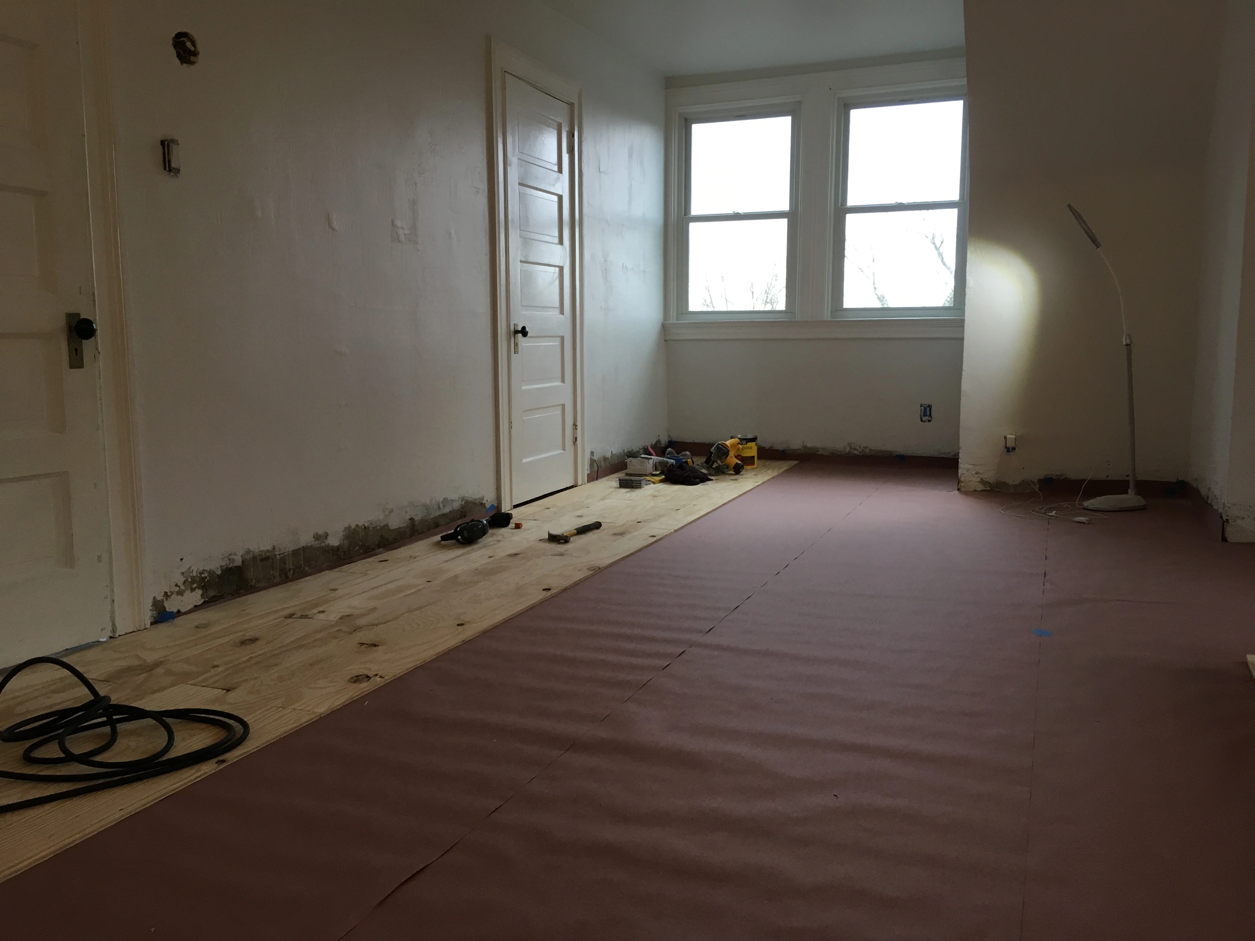

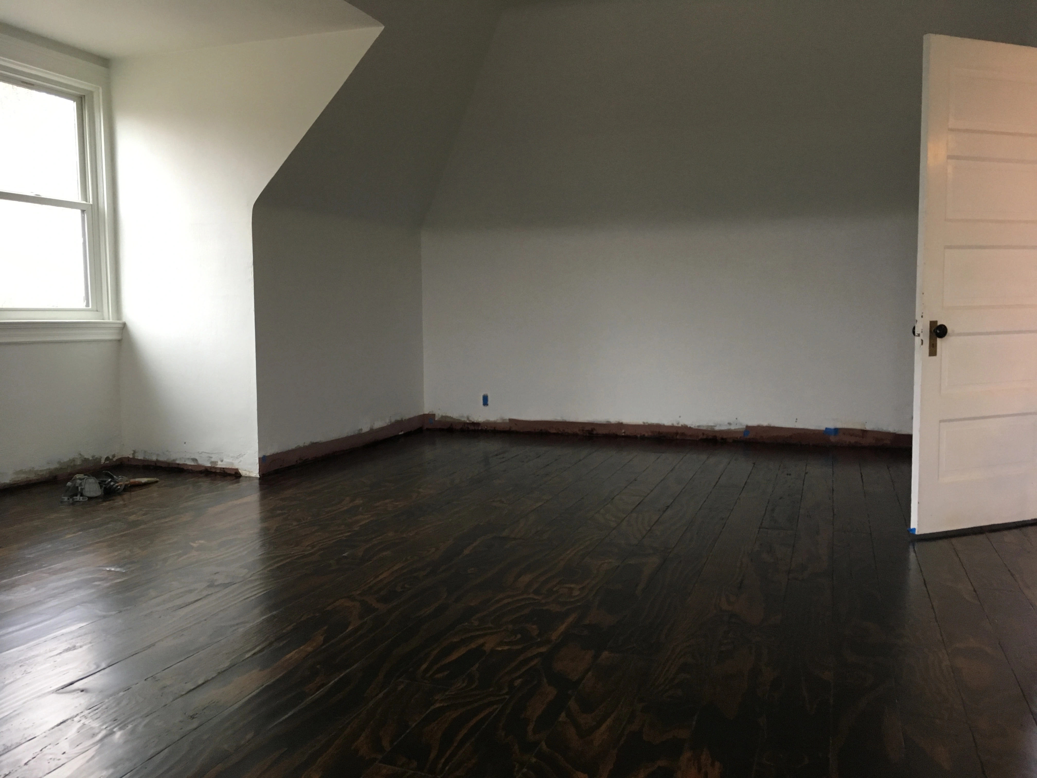

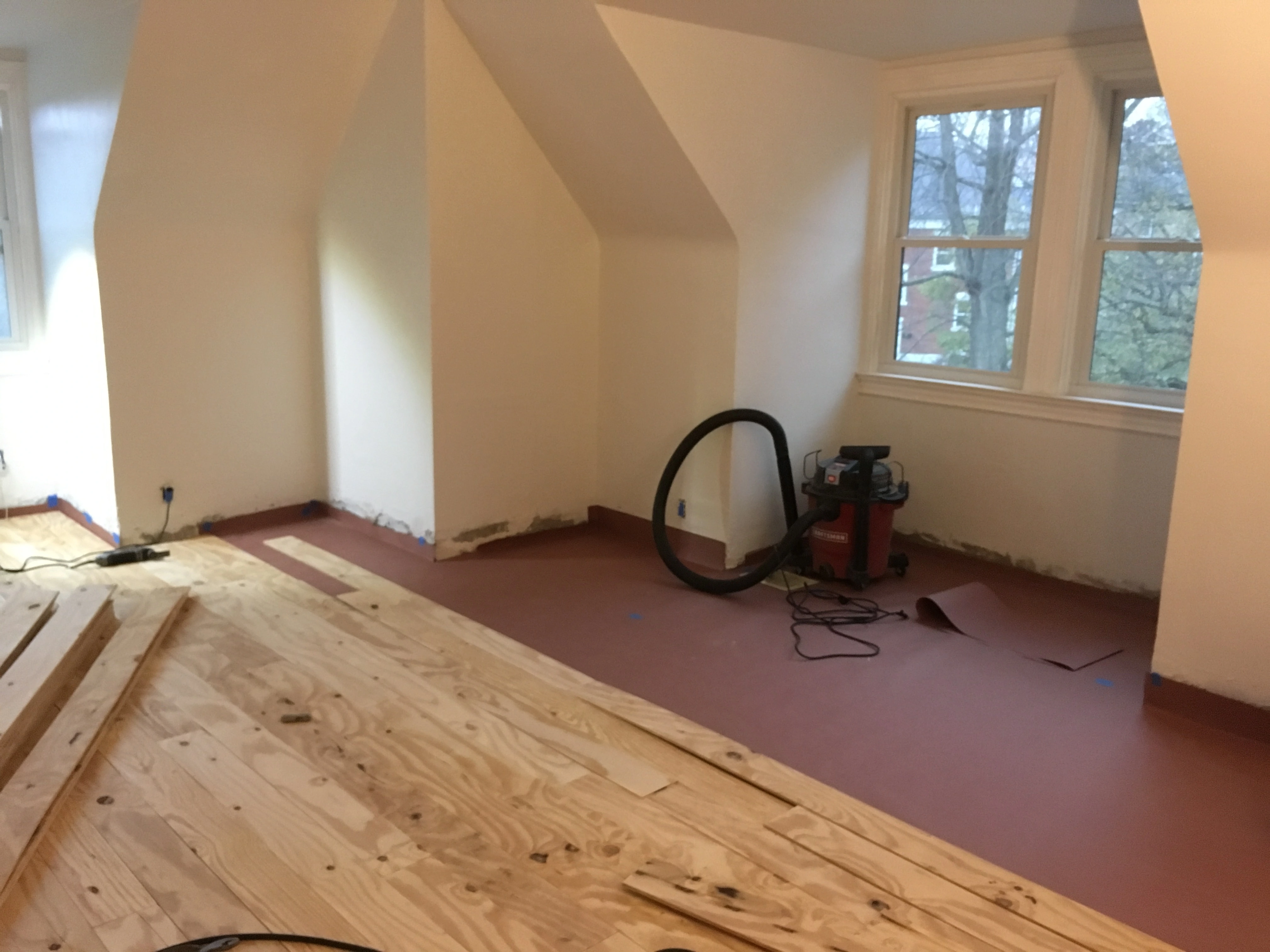

Hey all! Thanks for the interest, insight and suggestions... I'm still in the DIY homeowner renovation phase of this project, but very nearly to the point where I can start working on acoustics. Here's how it's been going -- plywood planks getting nailed in:

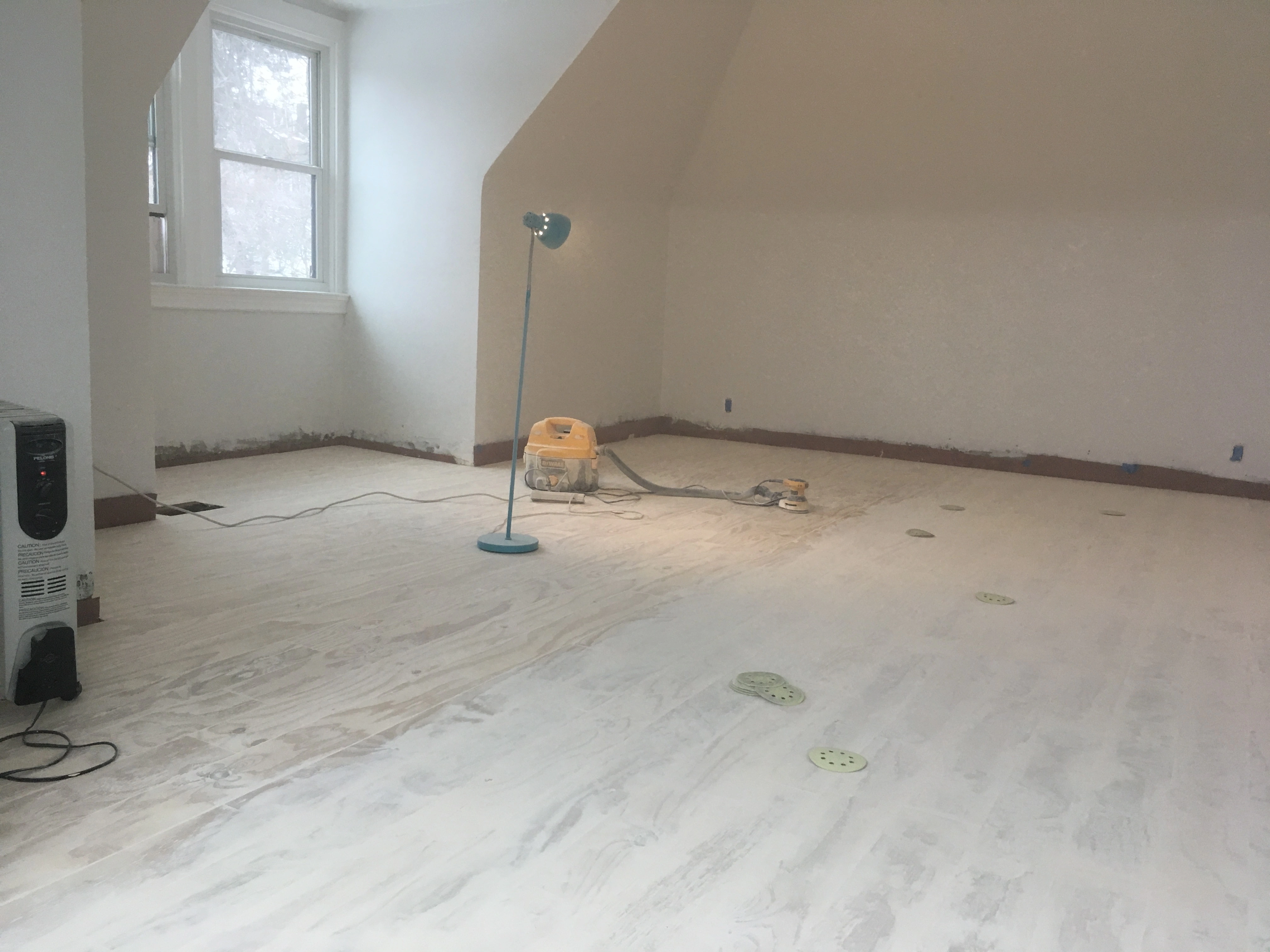

Full-trowel fill and two sanding passes:

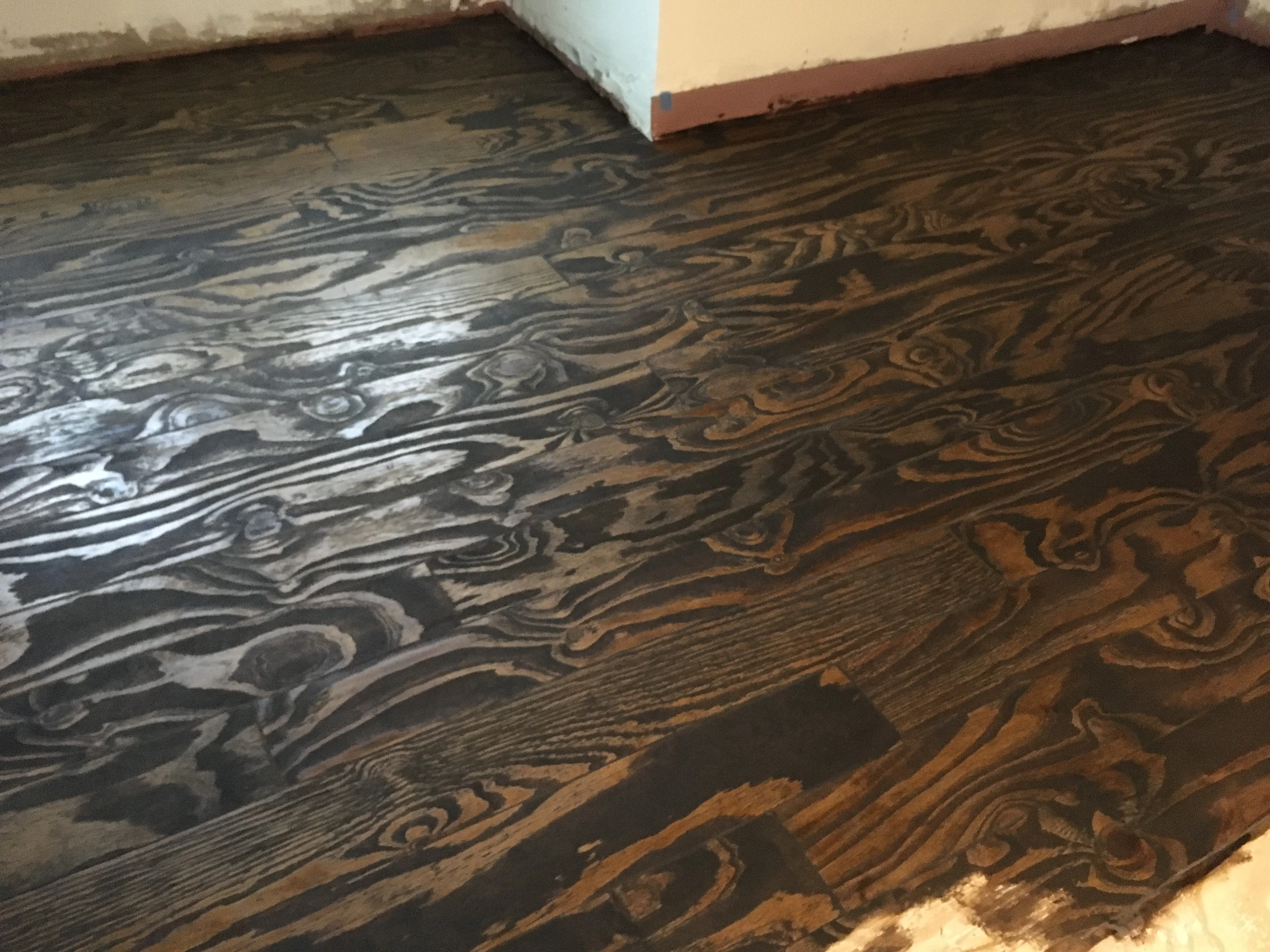

Stain!

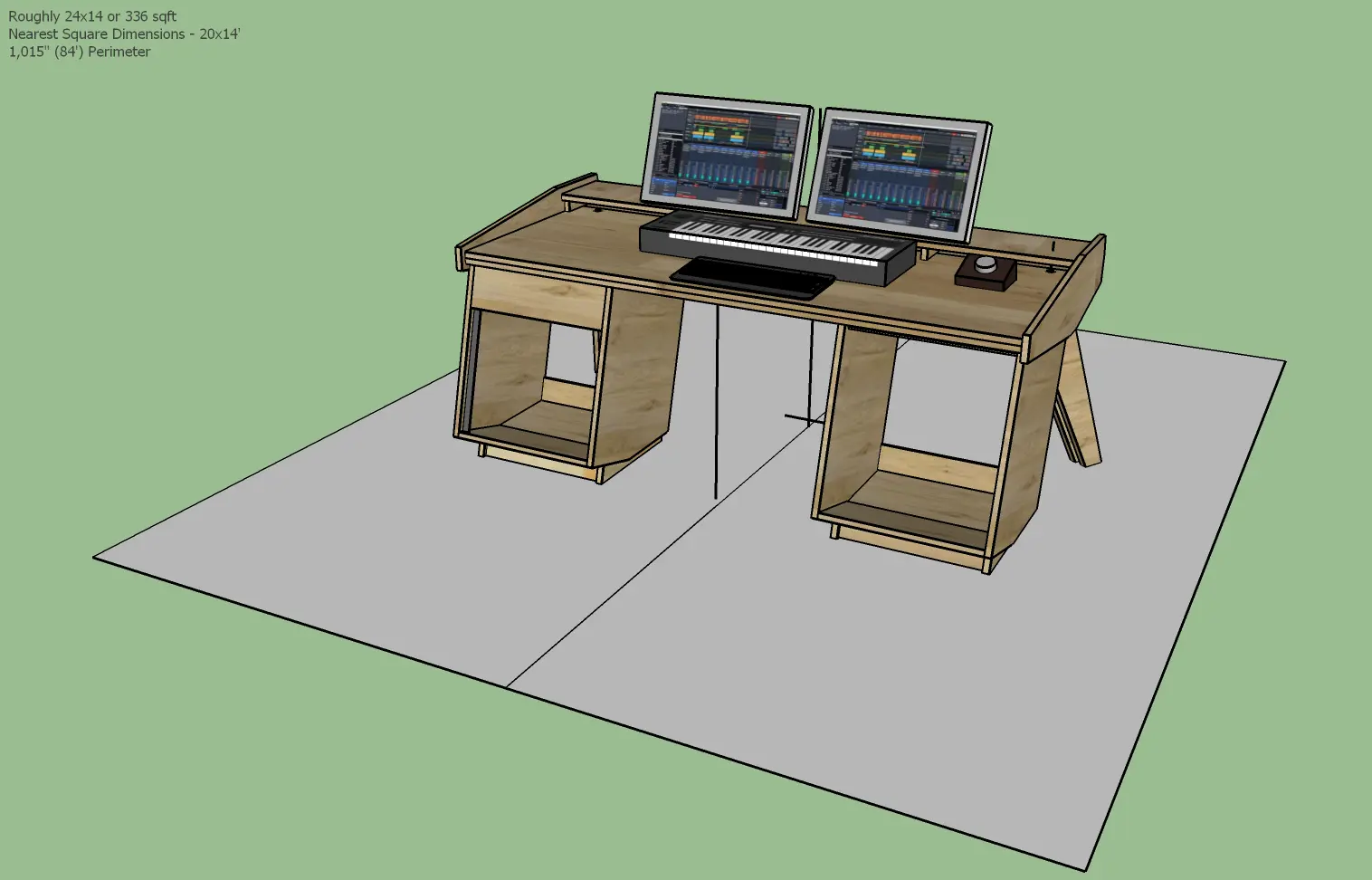

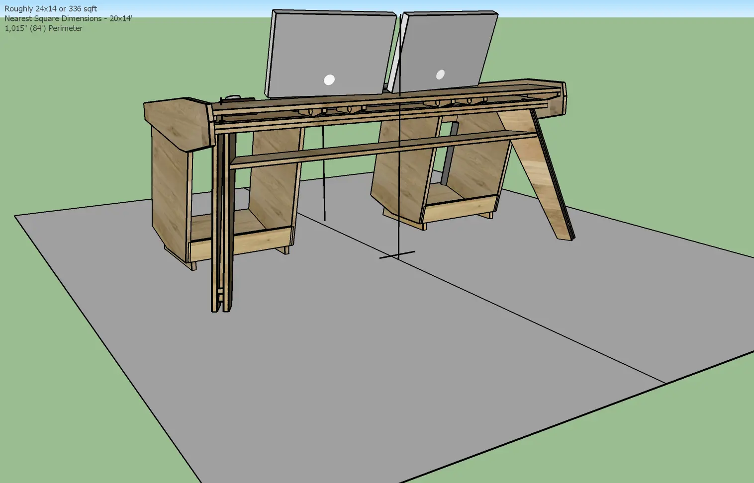

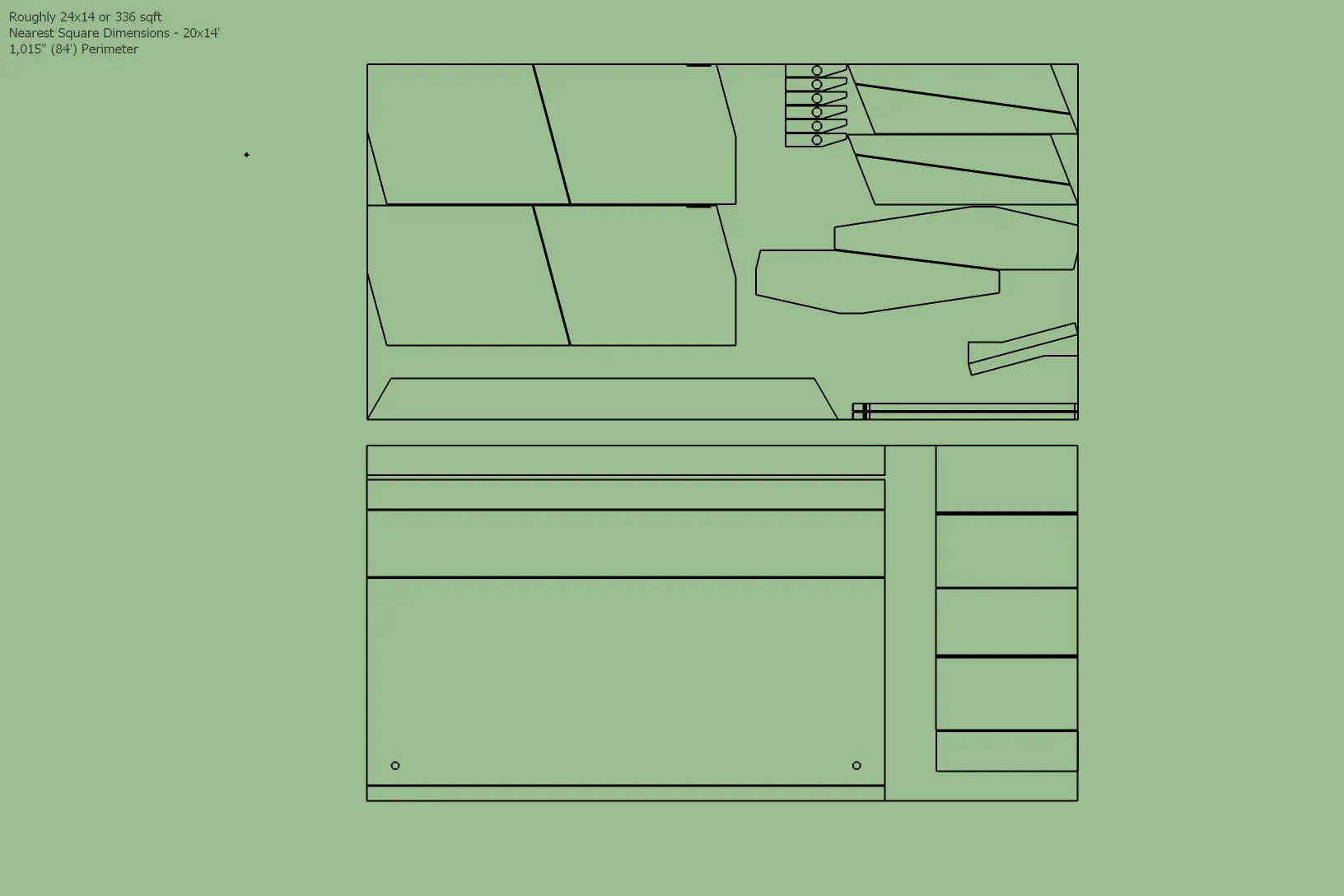

Meanwhile, while the wet things have been drying, I've been working on building the desk... here's the plan:

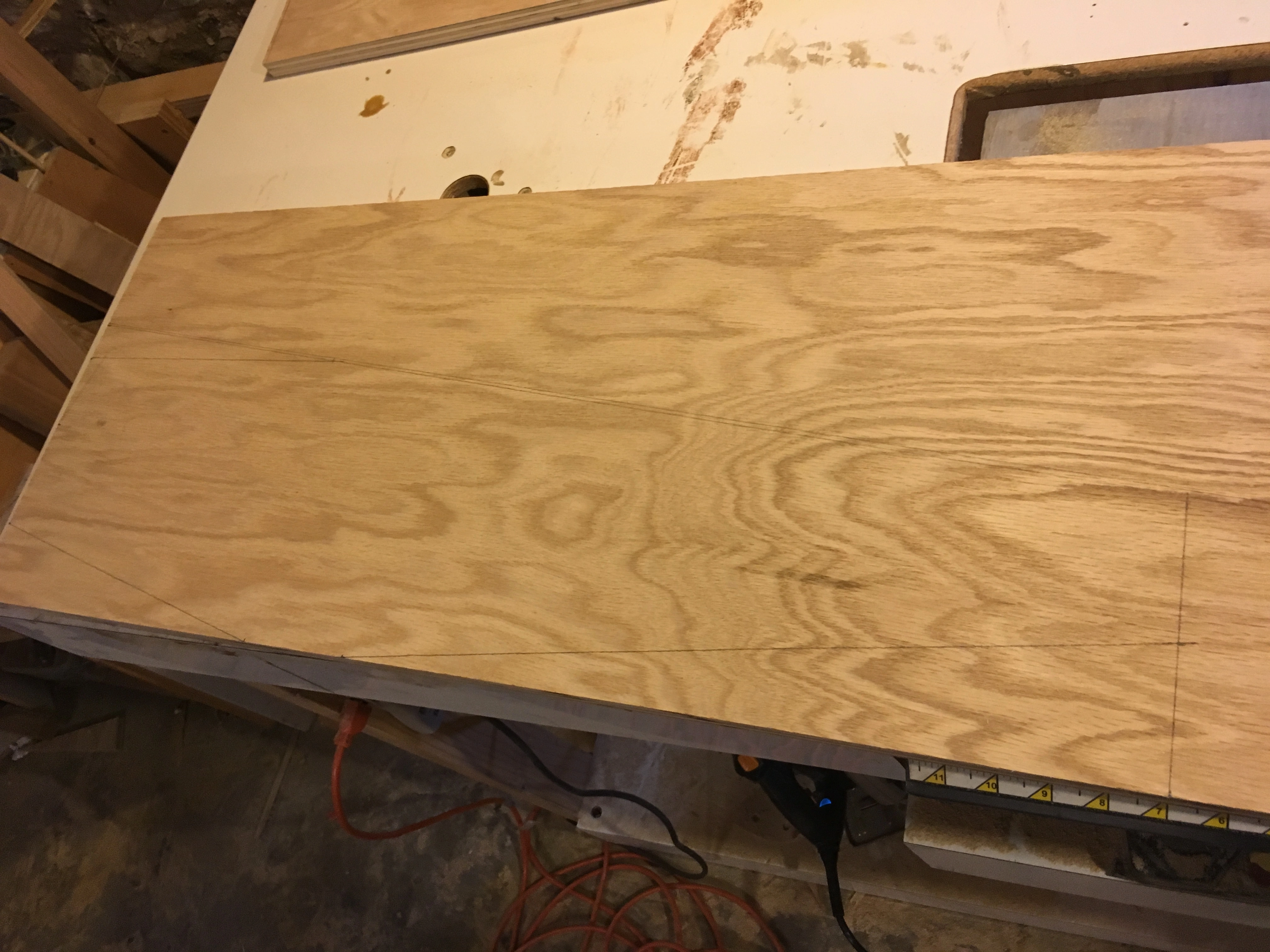

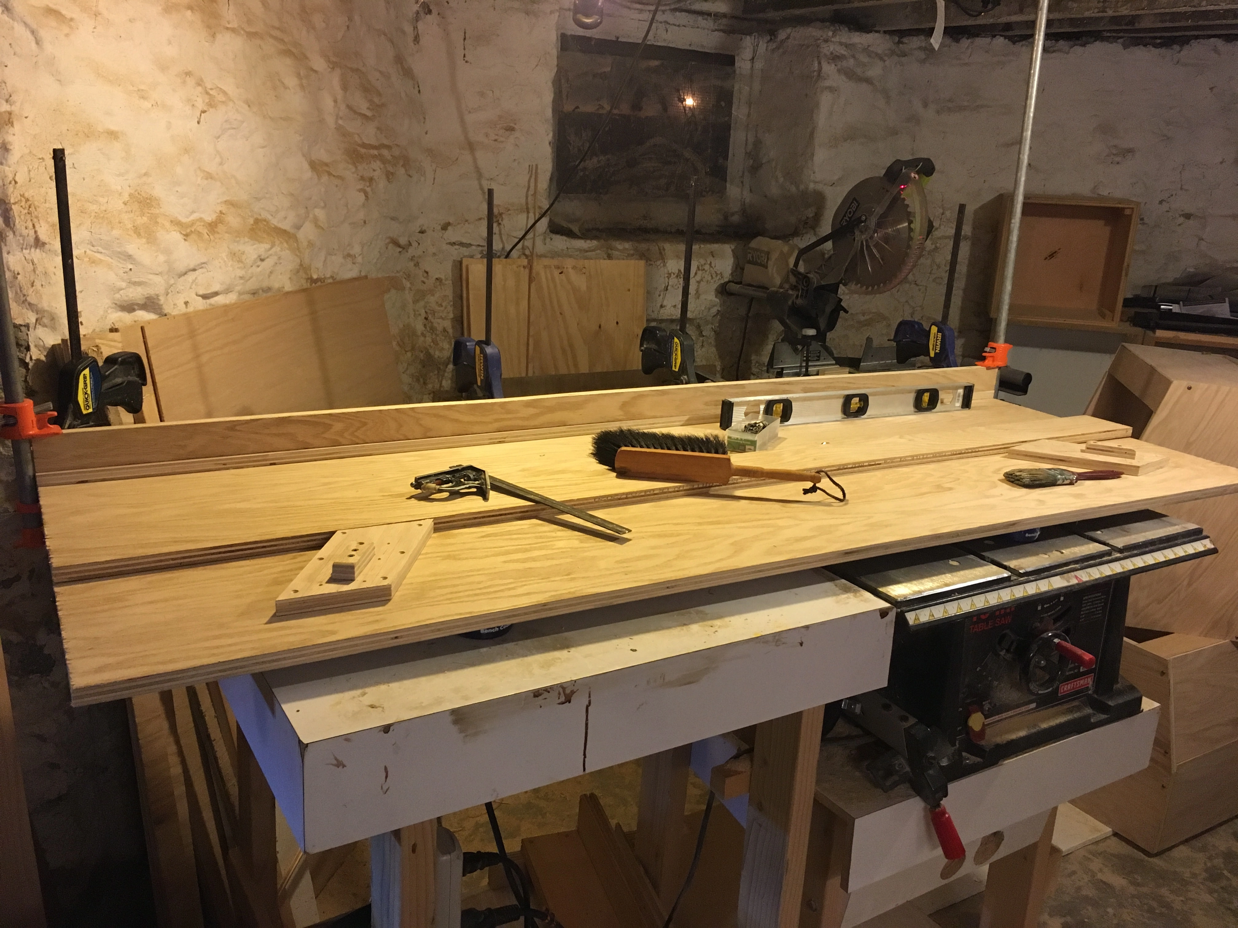

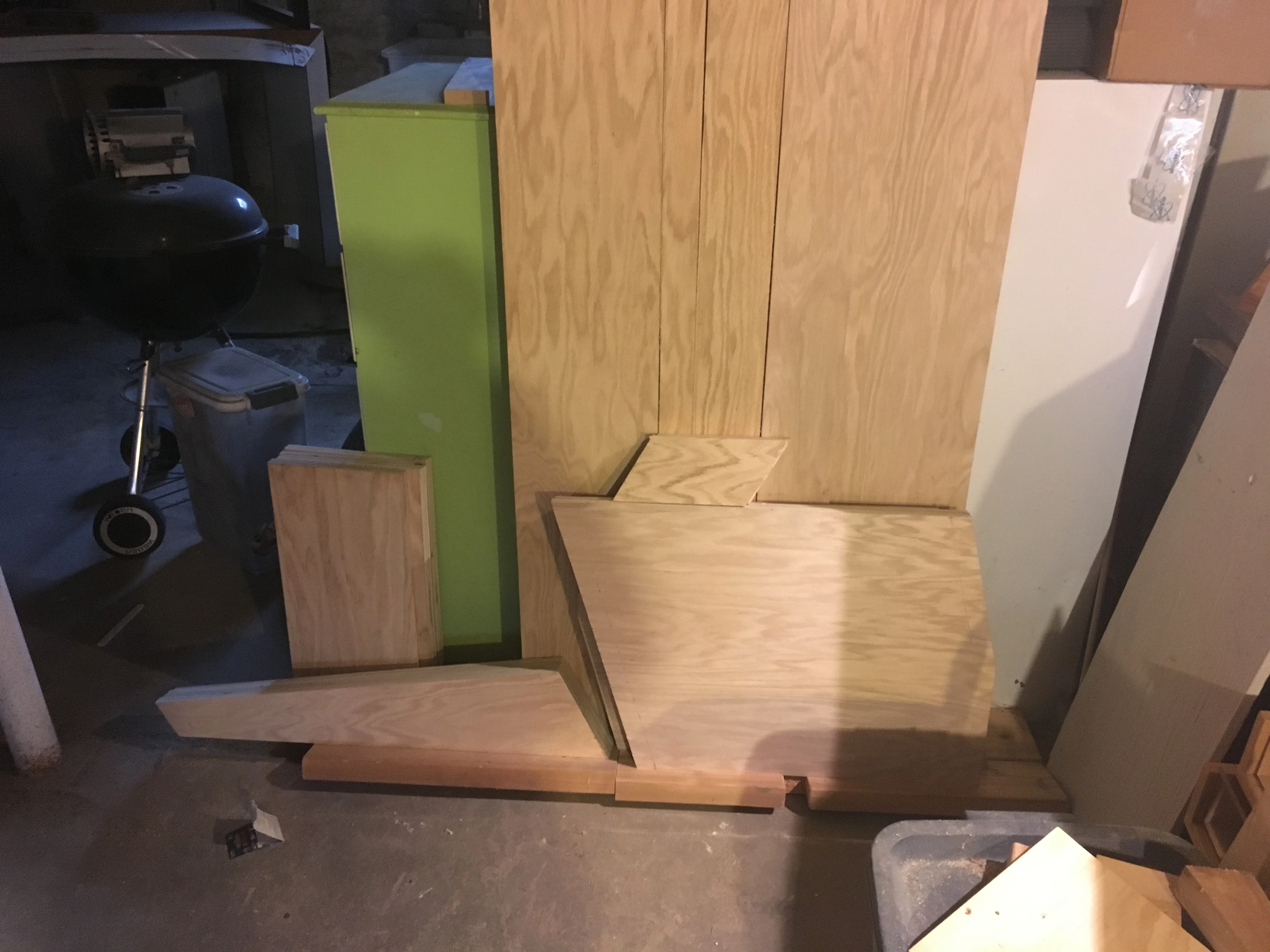

All cut up:

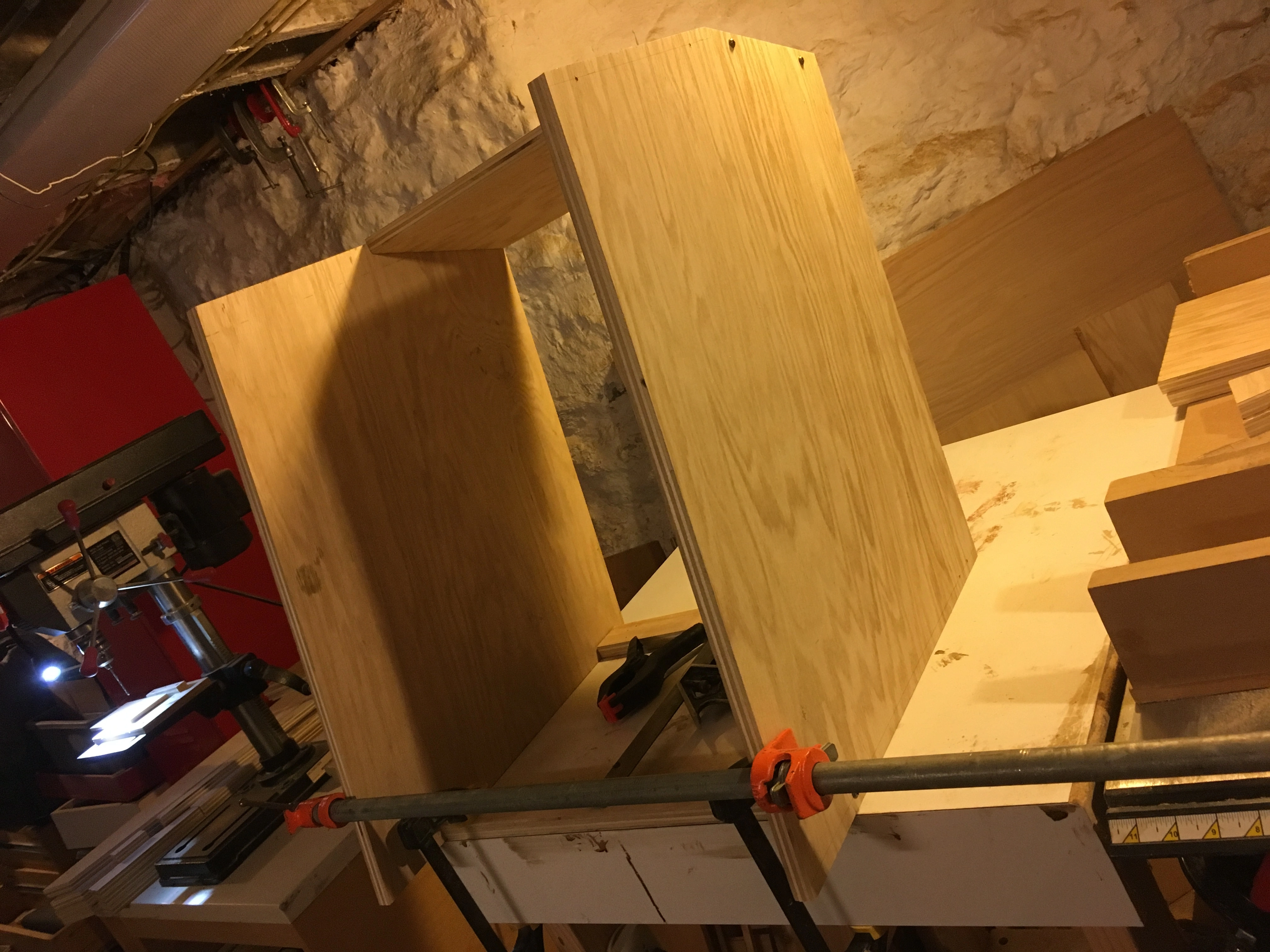

Getting glued and screwed:

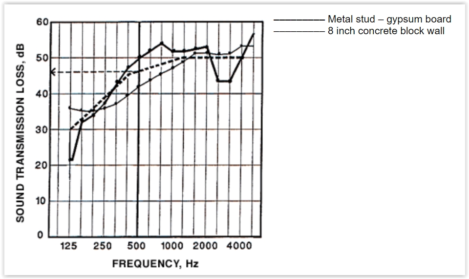

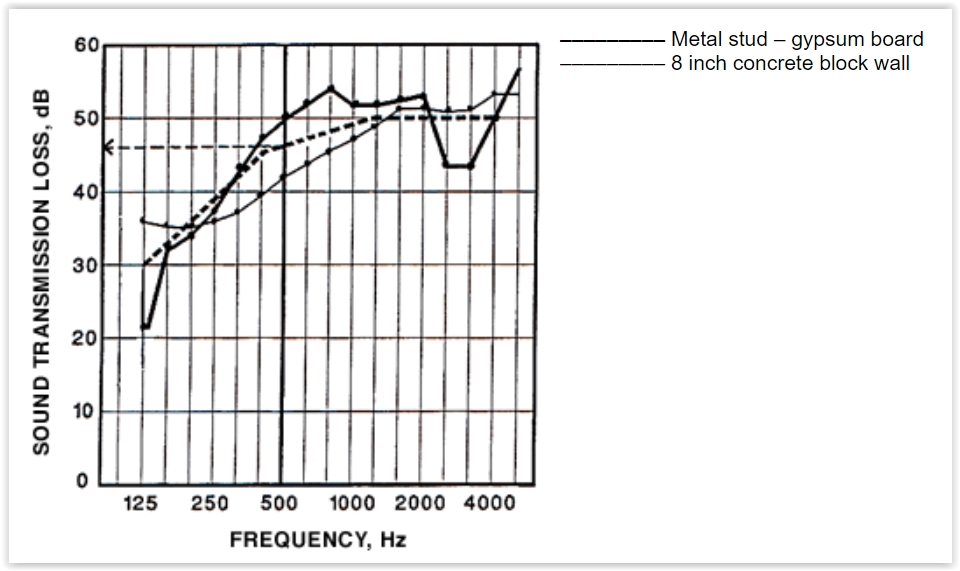

Not sure of what the sound transmission coefficient is for lath and plaster but with drywall 16 inch on center there is an odd coincidence dip at the resonant frequency at around 2-4k. It shows up in my room when I RTA it even with sound treatment. The angled ceiling make it a lot more difficult to model room modes. Here is a comparison graph between block and drywall that highlights it.

When I meant a room within a room, as a carpenter I mean clad out your existing walls and ceilings. 2" x 2"s on your existing structure with 2" acoustic rockwool then counter batten with 2" x 2" and another 2" acoustic insulation. You could put thicker on if required to give you more insulation. Then line with plasterboard/sheetrock and skim or tape, fill and paint. You would lose a minimum 4.5" off each wall. So reduce by 9" or more if required on width.
It would give you a much warmer more comfortable room exactly the same shape if you wanted. It would take about a week and if you are handy enough to do the floors you could do everything except the plastering or maybe you could do that also?
You could also tear the old plaster walls down as well but thats messy although a better job.
Newer construction in Pittsburgh is definitely insulated better than our house... we have hot water radiators on the first two floors that do a great job, but we certainly pay for the heat!
That's interesting about the 2-4k dip, and, yeah, all those ceiling angles certainly complicate things. From what I've read plaster's marginally more reflective than drywall. Anecdotally the room's echoes are heavier in the bass- and mid-range in its untreated state, but there is definitely some ring-and-ping, so I'm imagining it's going to be more a case of adding absorption than anything else.
Gonna dive into frequency analysis this week, see what I can learn.
