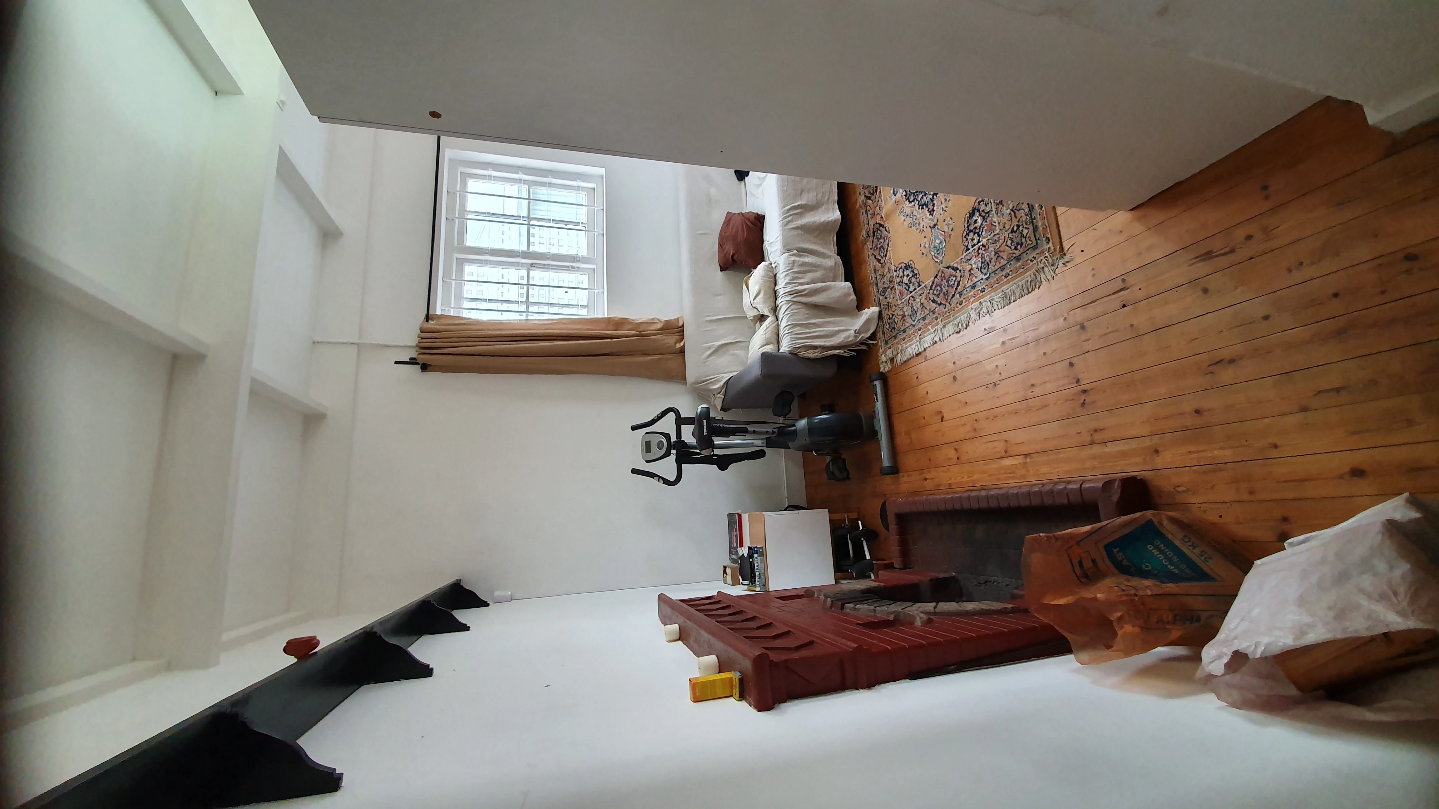

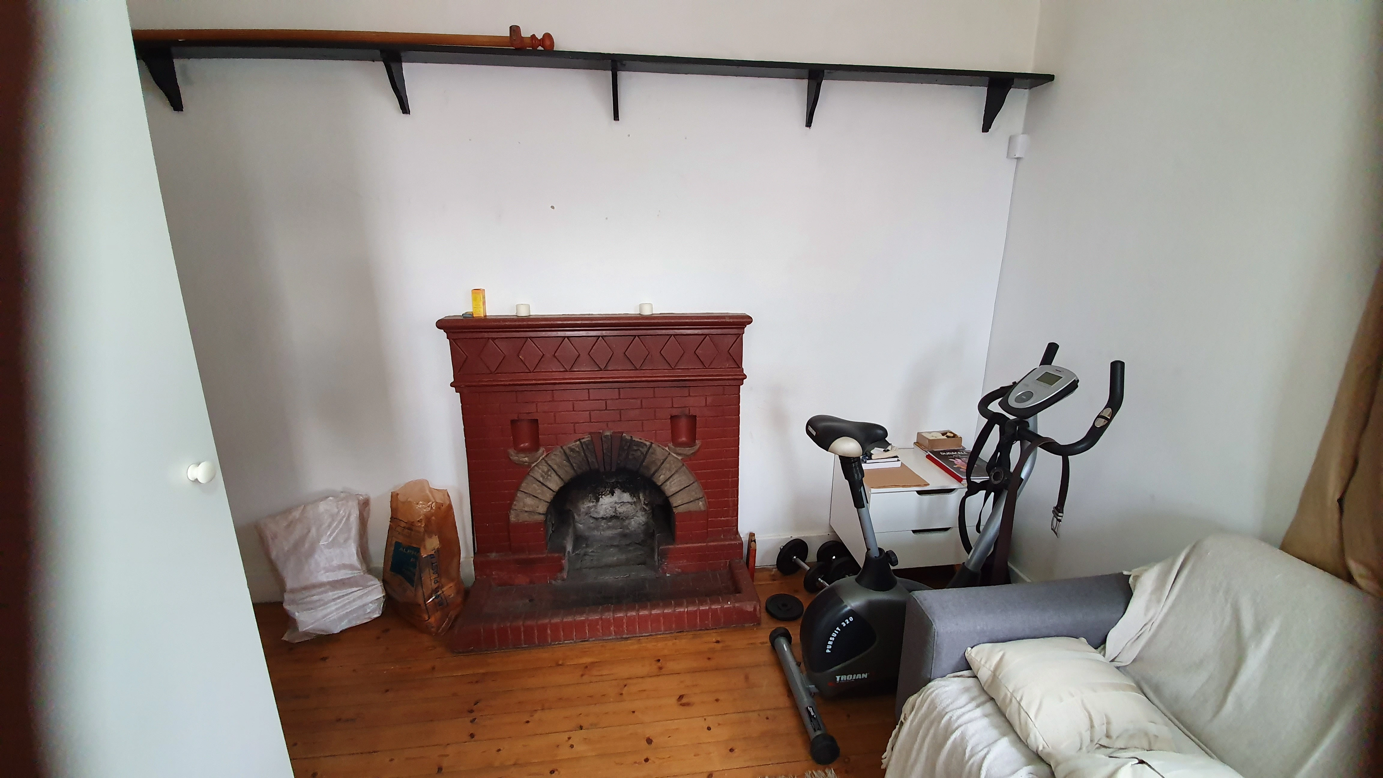

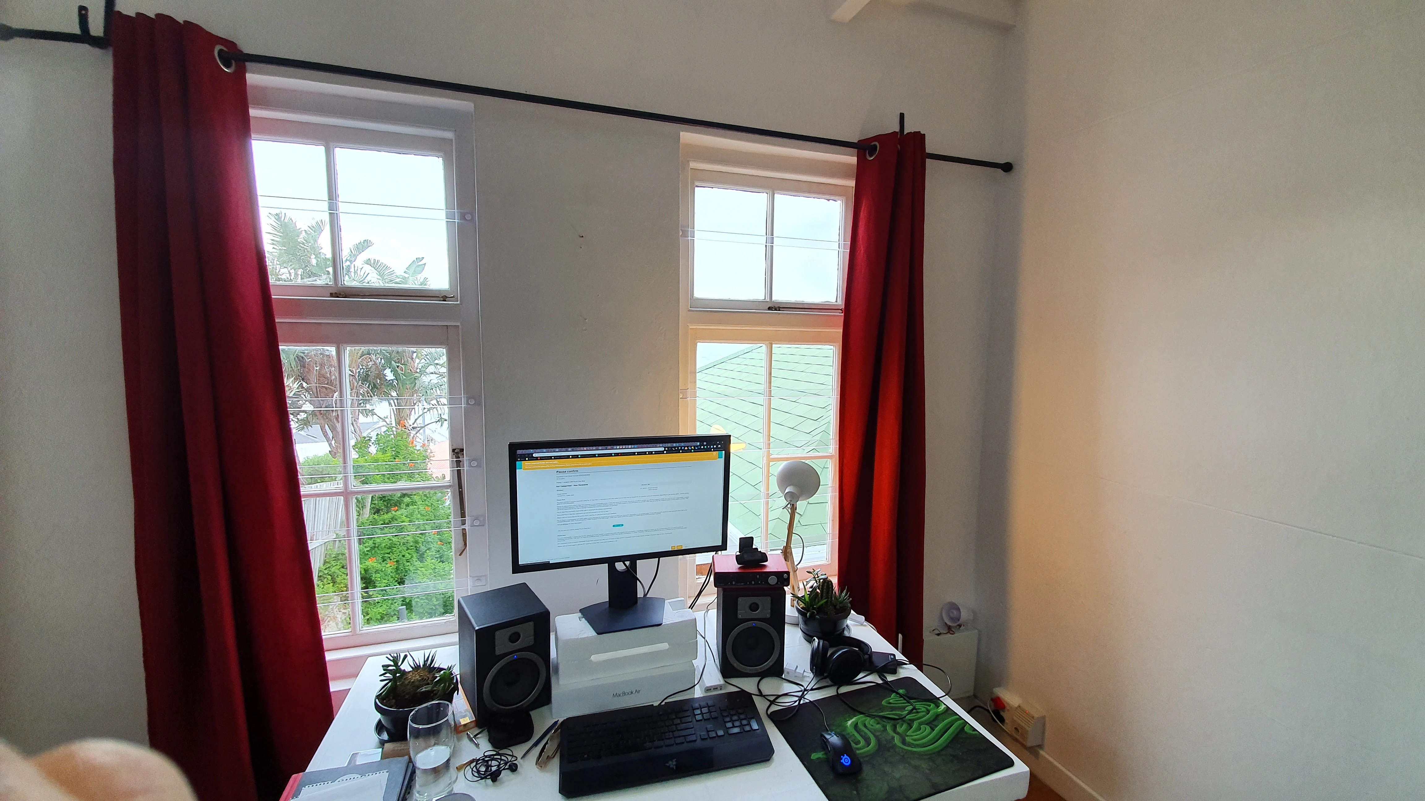

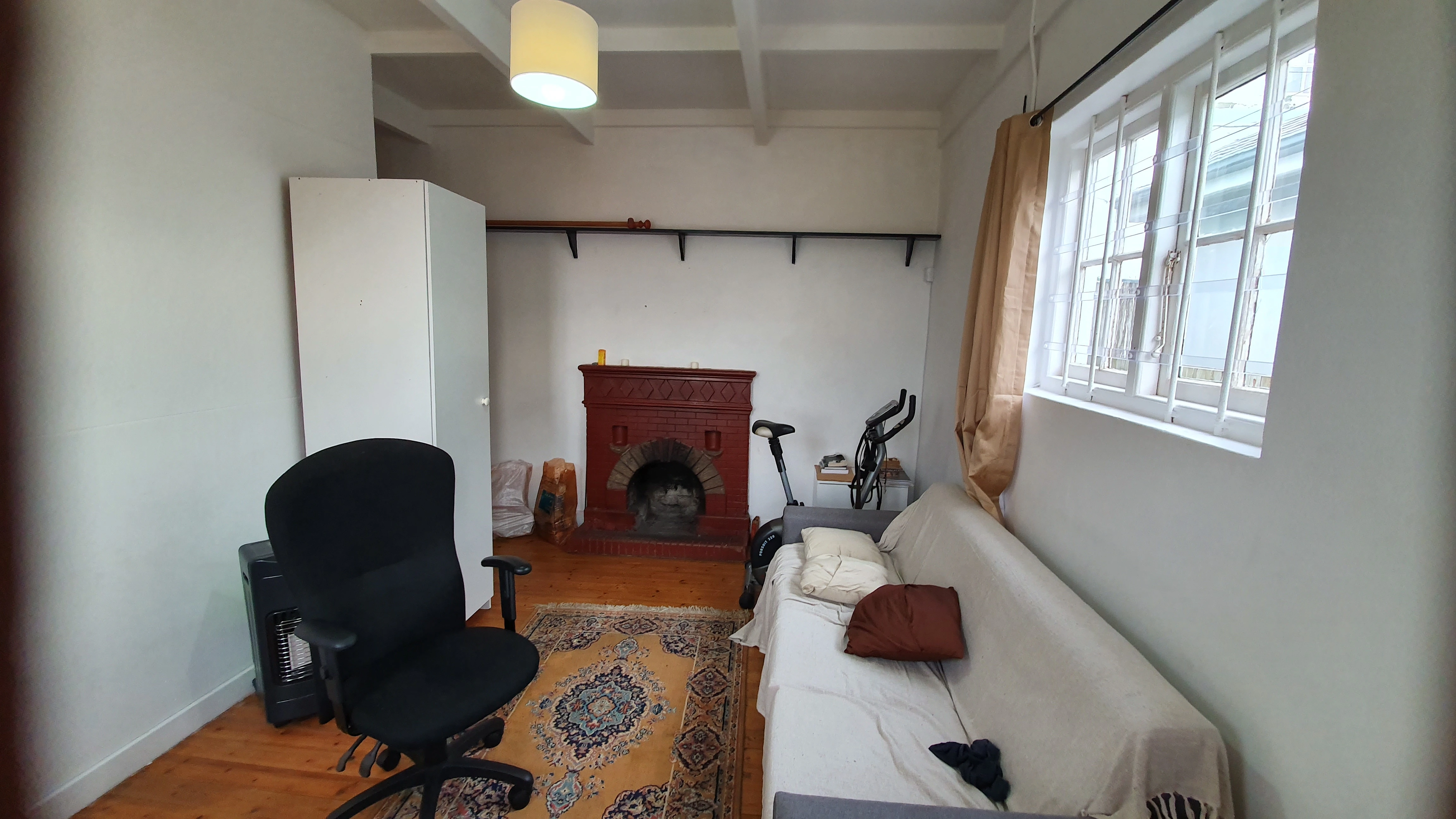

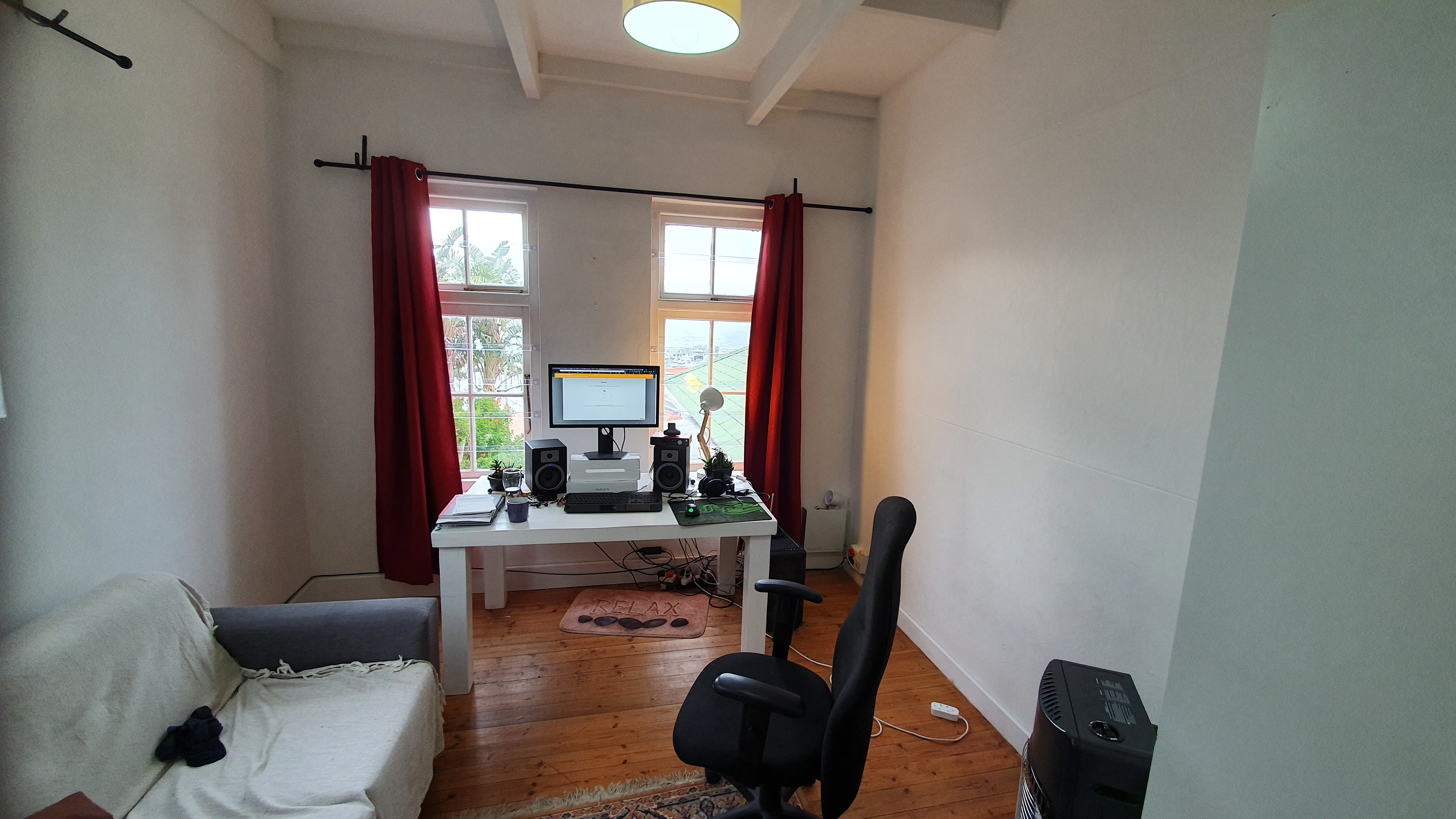

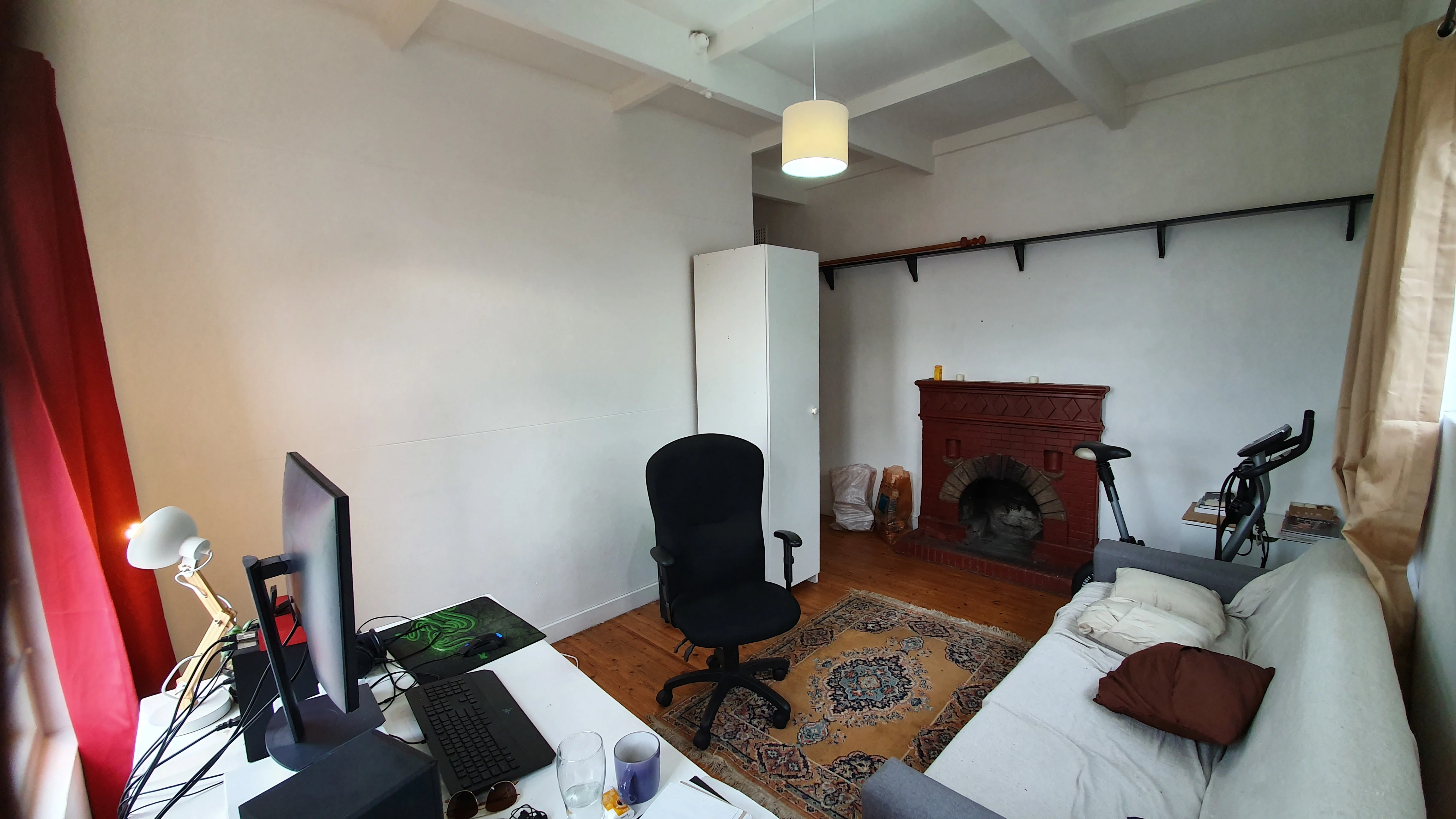

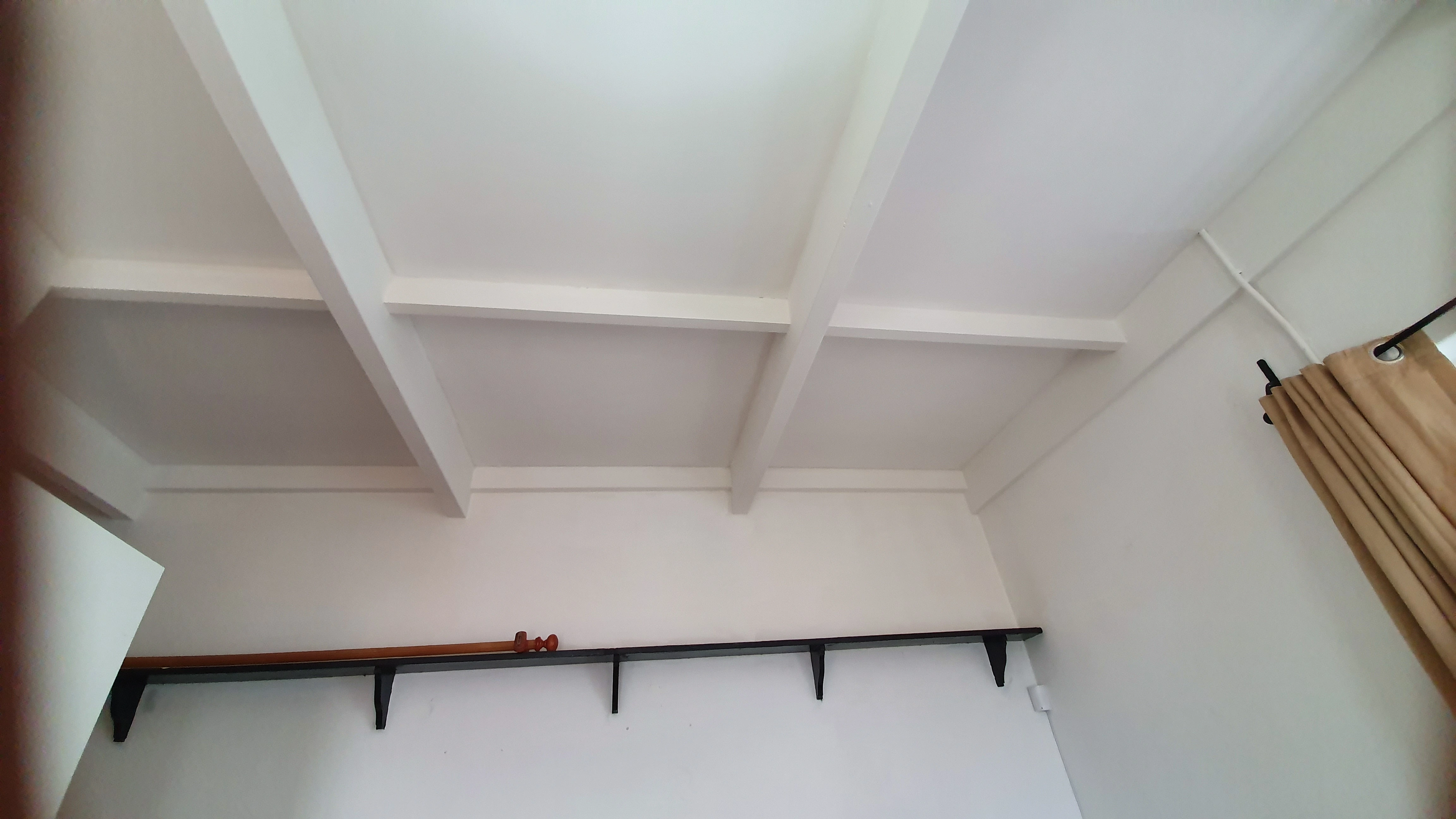

Hey guys,
So I've just come out a nearly 2 year music hiatus, and moved into a new place.
I want to setup a studio in my house. Essentially in this room, as the other is my bedroom.
It can be a dedicated studio, part lounge and work-space.
It's quite an odd room, and I've been wracking my brain on how to best position everything and set it up for production, and secondary loung / logical space-saving.
1. Which wall to put my studio monitors / desk / gear closest to.
2. Which treatment to get for each option.
I know that the longest walls should be on the left and right, but that means against the windows, meaning I will have to put panels over them and get thicker curtains, the downside here is losing the beautiful view and having friends over to chill by the windows. Also, the neighbours house (same property), is under the right window.
The fireplace wall is obviously out (or is it?) because I can't center the setup.
The long window wall or opposite wall closest to the passage are other options. The wall closest to the passage is a drywall (may affect decisions / sound)
Room size: 4.6 x 3.4m
Right now I just am brainstorming here and would love any thoughts, ideas, help and advice on how best to go about this - and take it from there.
Worth mentioning I have another room which is more standard. A single window and door, relatively rectangle (my bedroom).
Thanks you so much guys :)

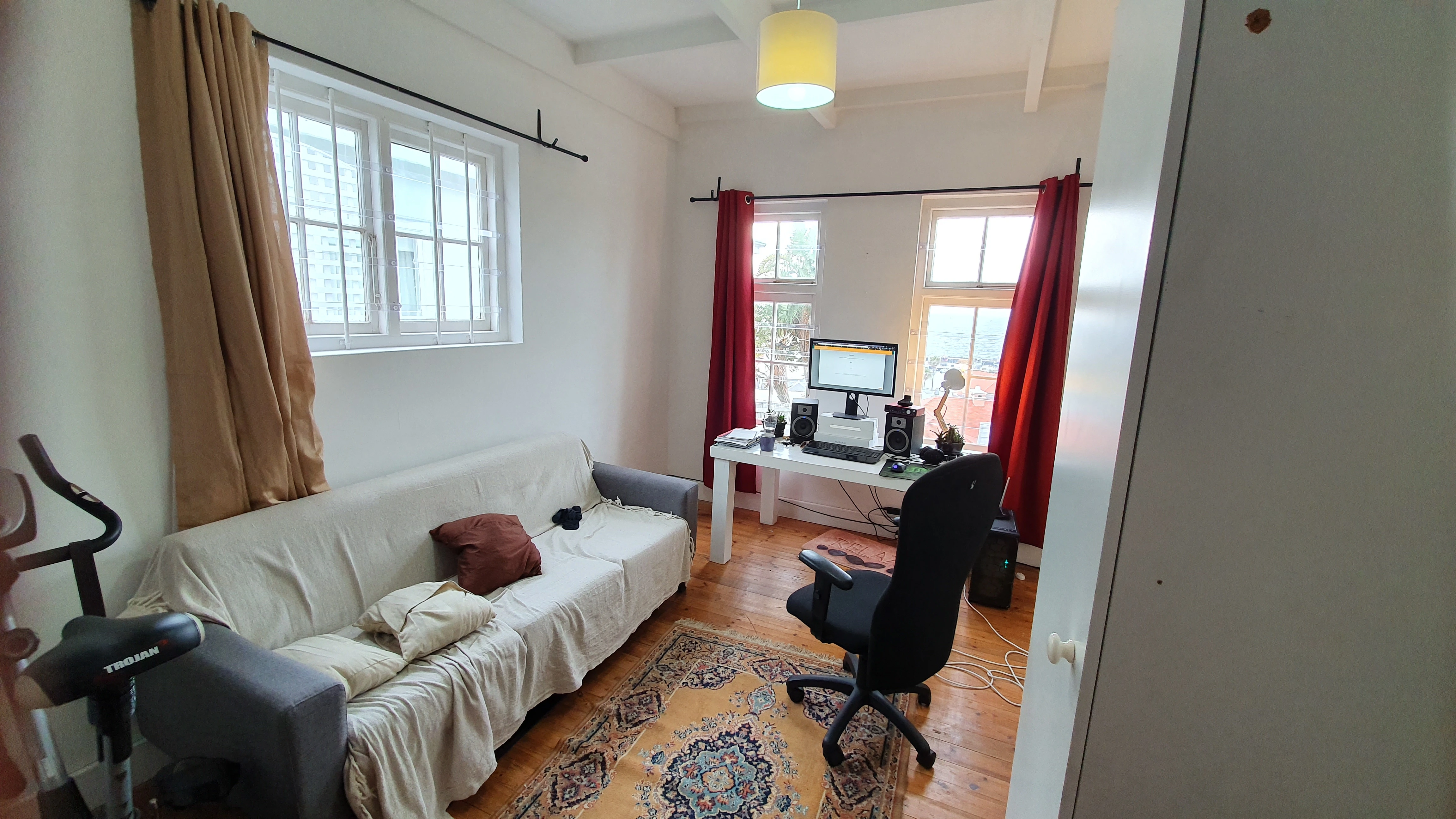

The pics make the room seem very narrow but there’s no way to really know without some dimensions.
Desk on that window wall is the best you're going to do. You've got to get your monitors spread out, sitting as they are on the desk gives you a lousy stereo image. Symmetry is important when mixing, that's going to be the tough thing in that room - that sofa is way too big for the room.
Hi,
Realistically it's always going to be a compromise room so I think I'd focus on getting dense material on the first reflection points, left right and up (from your sitting position).
I'd just leave the window exposed. May as well enjoy that view. ;)
+1 to moving the monitors.
Right now if you look over the top of the speakers, you see windows. Move them out wider so you see the room corners.
If you and the two speakers make a triangle, you'd want to be the right angle in it.
Try to find some boxes or stands or something and get the speakers up a foot or more : Whatever your comfortable sitting ear-height is.
I did intend to get a smaller desk and monitor stands (or maybe stands not necessary), right now its just planning my room at stage 1.

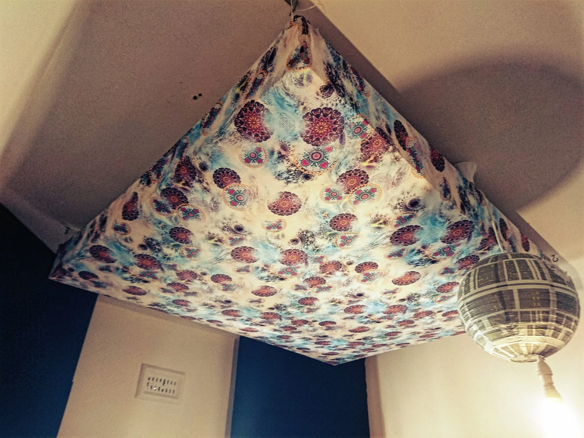

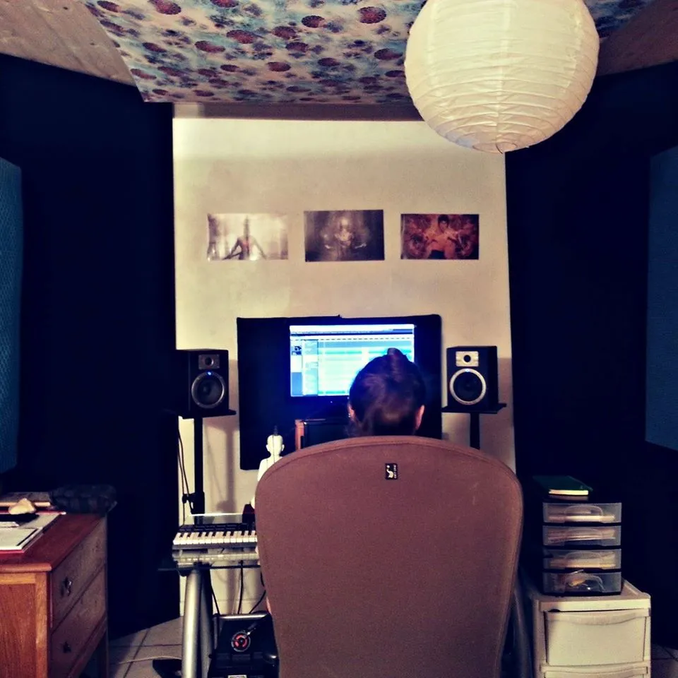

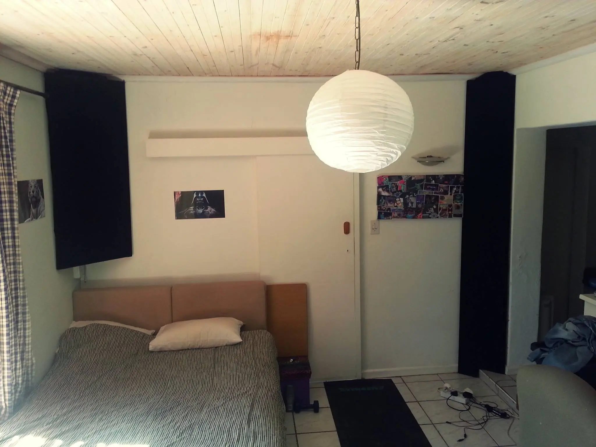

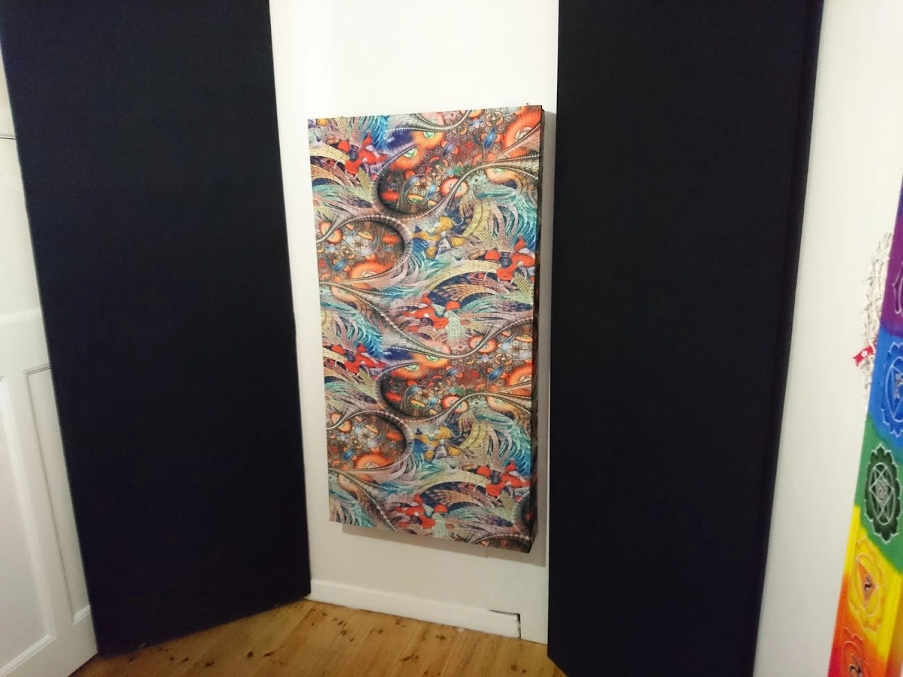

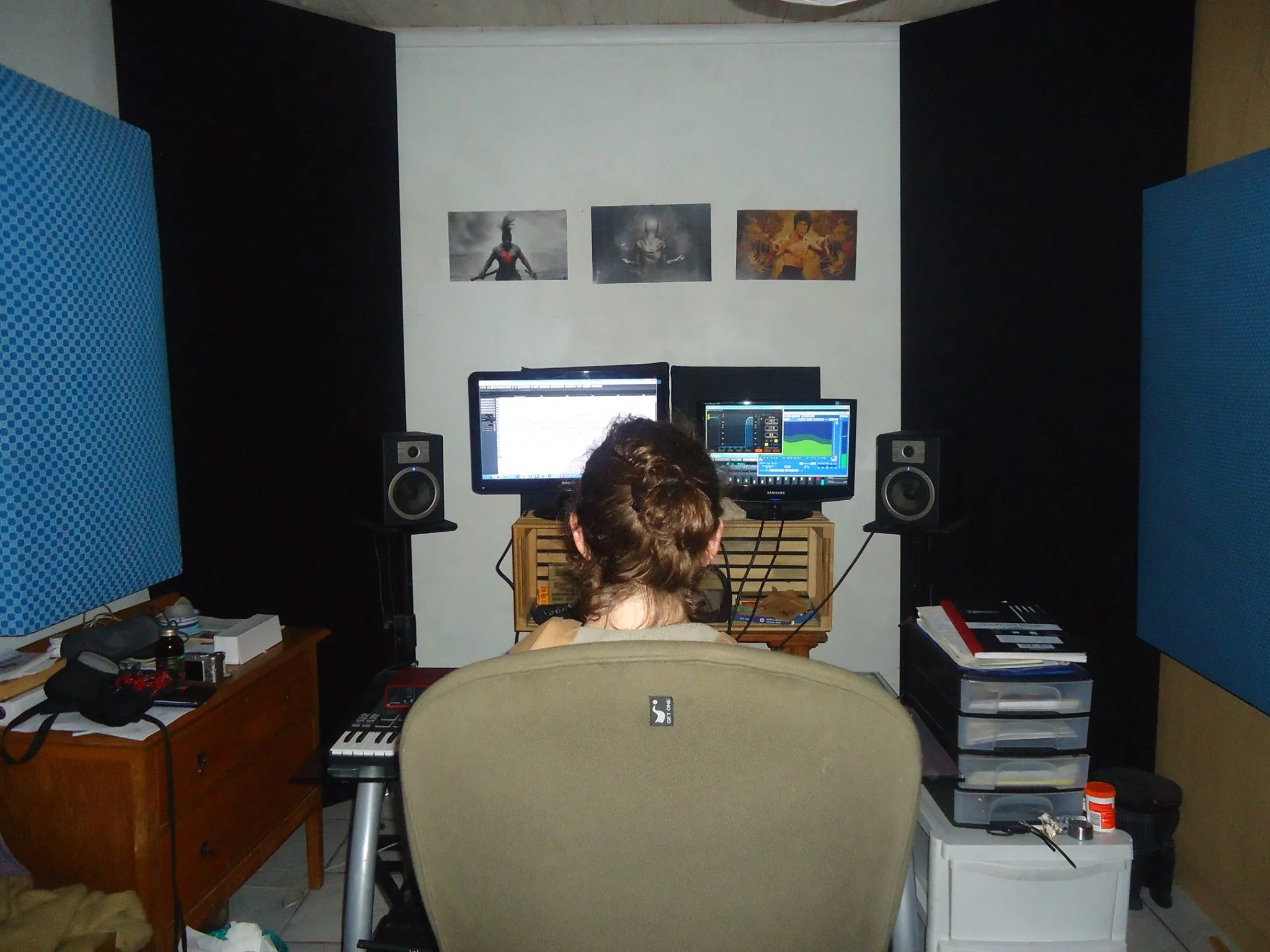

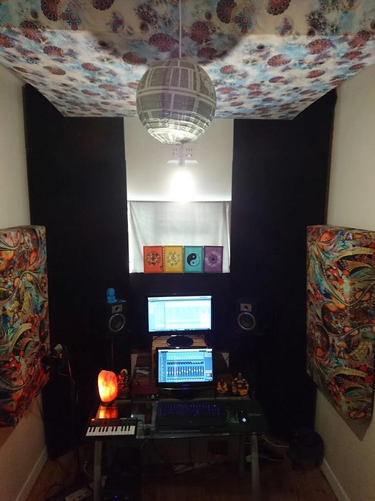

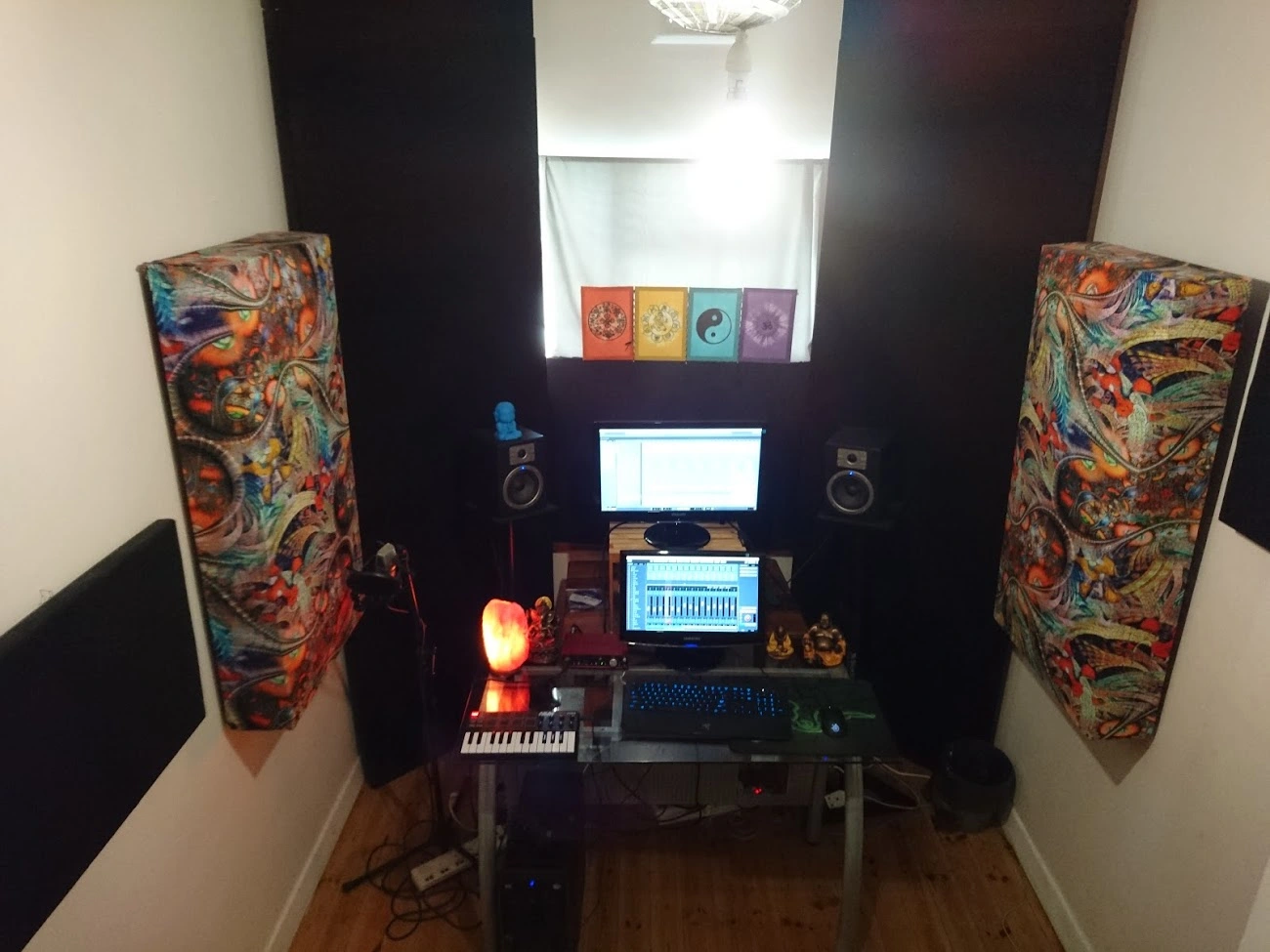

Just for some more context and info - Here are my studios that I built (I built the panels too).
Did reflection points / mirror trick etc and sorted out problems. I studied and got info on how to do all that years ago.
First studio
12309781_10153038515542924_4670389418520631741_o.webp12304082_10153038539722924_8756121116497752863_o.webp10838168_10152601921097924_3113608477858097424_o.webp
Second (most recent and last before my hiatus)
DSC_0669.webpDSC_0660.webpDSC_0652.webpDSC_0649 (1).webp25587232_2001892876763154_3910632287650910382_o.webp
Note: I have all the panels in storage of which Im probably going to use and want to install in this new studio. Or may get some from retail.
If you've got more panels then, by all means, put them up. The more the merrier.
I'm losing track of what the question is. Seems you have experience with fairly well treated rooms and presumably you've mixed in regular un treated rooms?
You must have your own idea of where the line is?
With first reflection points done I reckon you could get to know the room/speakers and make some good music.
If you have additional panels, or corner traps, then that's even better. :)
