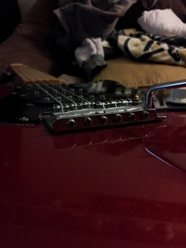

The number of springs is irrelevant. All you need them to do is pull the block back to where it started. Five will do that no better than three. In fact one big fuck off spring could well be better if it has more pull than five.. The reason behind more springs is to spread the load across the spread of the strings not increase the load.
If it's going sharp as you say then if it were the springs then they are already pulling back a little harder each time and stretching the string that little bit more.. It aint them.
