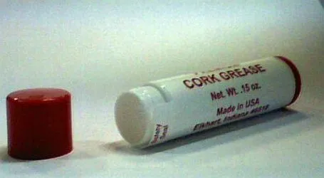

I use this - what do your use?
I agree with Muttley that your nut slots must be cut right for your strings, but when that's not enough (like with my vintage Strat with a floating trem), I use a dab of a mixture of graphite powder and Teflon grease.
Nut files.;)
Yup, though GHS has some white graphite stuff that is actually pretty nice for guys who bend a lot, or do a lot of trem stuff. Myself, I've never found the need, but I slide more than I bend so...I've got customers for whom it is very effective.

I may catch hell for this (appology to Light and Muttley in advance) but I use white lithium. I put the smallest amount possible in the slots useing an insulin syringe to apply. It only takes a tiny amount and seems to last indeffinately.

I keep a tube of graphite powder handy.
