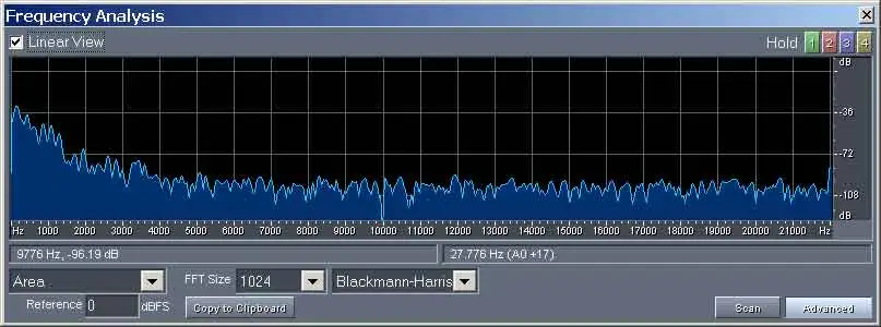

Here's a shot of my frequency analysis. This is the left channel while recording guitar only. The right looks almost identical.
Should bass be naturally higher? I saw someone else's analysis and it looks similar. Maybe he has a bad room too?
Is that high jump bad? What does a healthy analysis look like?
