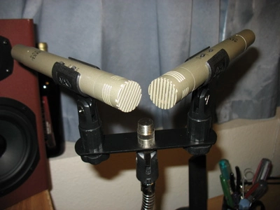

Now, here's a stupid question. On my stereo bar, I have the knobs that screw into the bar on each side from below and screw into the mic clips. However, I am too stupid to get them to adjust at all so they are tight and point in the direction of my choosing. The clips just tighten down until are tight against the bar, in whatever position that happens to be, and I can turn the knob CW or CCW, and it doesn't tighten or loosen the clip. What's the deal? Maybe I should put some rubber washers in there or something... I realize how stupid this sounds, but I honestly can't get this to work.
By the way, Tae, has myhatbroke hit on you yet? :rolleyes:
Edit - I think this is the one I have. The problem seems to be that the knobs/screws are actaully threaded through the bar, so turning them raises or lowers the screw and clip together, instead of having the screw float loosely in the bar. Stoopit, I tells ya.

I don't believe it. ;) Is it as I describe - threaded through the bar? - if so, how can you possibly adjust the clips and tighten them into position? it's impossible, I swear. I'm pretty dumb, perhaps, but not too stupid to properly work a mic stand and mic clip, honestly. I know this isn't "user error."

Anyways, what I did is Igot my Dremmel and sawes away the threads in tha bar. That way the knobs and mic holder spin independantly of the bar.
Otherwise, yeah it's impossible! :o Well asctually it would work with certain clips with plastic threads that have more "give".
But I do think your idea of rubber washers would work great. Maybe some garden hose washers will fit?

You know, I have all these tools in my garage - but could I come up with this? Nope. Jeez. Thanks, I'll be doing this tomorrow. Should be quick and easy.

Since I hate being called a liar, heres how I set mine up.
https://homerecording.com/bbs/attachment.php?attachmentid=40846&stc=1
