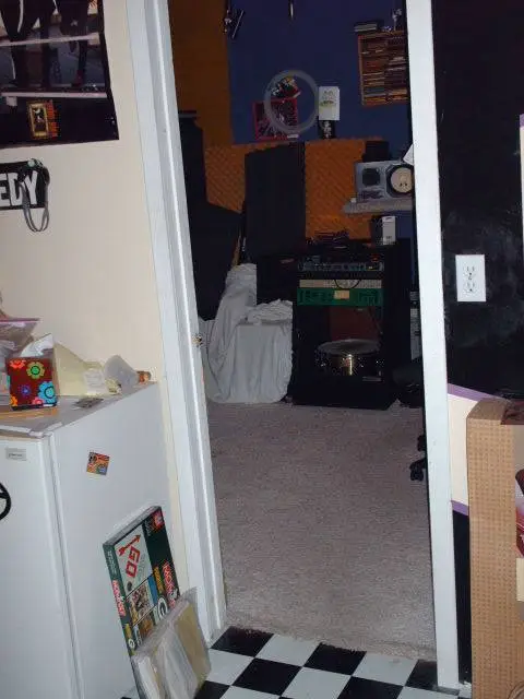

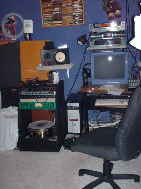

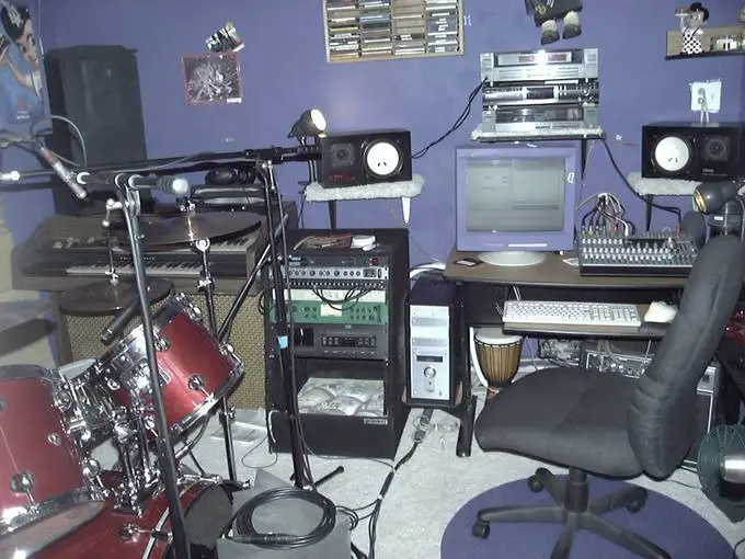

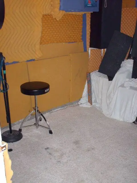

Yeah, treated like a red-headed stepchild.
As you might be able to see, my studio is real small. I have to record drums for a few songs, then tear 'em down to record everything else.
Here's a pic when they're set up.

here's one without the drums
IOW, I record in a tiny room that I built in my garage. :D

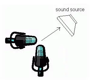

If you have 3 mics available, try the one pointing down the neck to pick up the sound of the strings, and 2 like this, where "sound source" is the sound hole on your acoustic-

Wow, thanks ez that was really helpful! I guess my next step would be to treat my room. I've read a lot in the studio forum about traps so I might have to order some 703 and make some absorbers.
In that mic position picture you posted, since I only have 2 mics, do you think that would produce a decent sound? I wish I had 3 though so I can try what you suggested.

But if you insist on the stereo sound, then yeah, I'd agree with willis that a coincident pair like an X/Y will b a lot easier to work with than a spaced pair.
