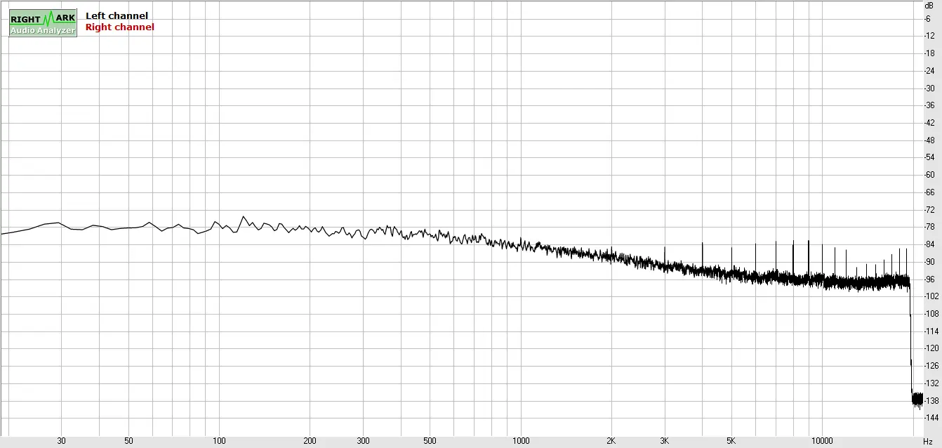

Clarification! I said the noise was at -43dBFS and it IS on Samplitude's (lovely!) meters but you can see the spikes only reach -84dB on the spectrum? This is a quirk of RM analyser and if I am being really geeky I put in a calibrating tone. Note that the ultimate noise floor of all these 16bit USB devices that I have tested is about -85dBFS, some 10dB short of the theoretical (CD) limit but in practice perfectly adequate. The downside is that you have to record a bit hotter and thus watch those peaks!
